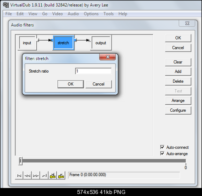

  4. After turning on the Advanced Audio Filtering option click on Audio -> Filters.... Add filters to build a filter chain. Add Input, Stretch, Output. Connect them if they don't auto connect. Double click on the Stretch filter and input a value.
    I forget which way it works but 0.99 or 1.01 will change the length by 1 percent. If your audio is off by 4 seconds after 660 seconds (11 minutes) you need to stretch or squish it by:
    660/656 = 1.0061
    or
    660 / 664 = 0.9940
