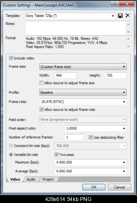

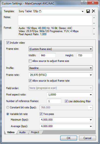

    Use 960x720 for HD 4:3 file for Youtube.
    Select Tablet 720 profile and change like a shot:
