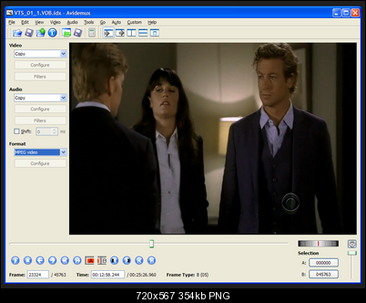

  16. Banned
    New York, US
    Originally Posted by darito View Post
    I was looking for free software (I've never used video editing software) to cut MPEG for Mac and I found Avidemux, Bigasoft iMovie Converter, MovieConverter Studio. What kind do you recommend? I know that some may degrade quality.
    AVidemux. No quality loss -- you won;'t be "processing", you just cut and copy.
    The Avidemux main page is here: http://fixounet.free.fr/avidemux/ Doesn't say much, though.
    The download page is here: http://fixounet.free.fr/avidemux/download.html
    Create a folder for Avidemux and download the installer for your particular system. It's convenient to keep the installer there, and any other guides you come across if you want to use the app in the future.
    Installs pretty fast. Take the defaults, unless you need Italian or something. It will put an icon on your desktop... or just go to the programs start menu for Avidemux when you're ready to run it. But first , before you run it . . .
    It's easier if you just copy a piece of your DVD to a folder on your hard drive. Make a new folder, call it whatever you want. Then get one of your DVD's and put the disk in your DVD drive. Windows will try to play it, but you won't have to. Use either My Computer or Windows Explorer to look into the drive where you mounted your DVD disc. On the disk you'll see a VIDEO_TS folder. Inside that folder are some VOB's. If it's a full movie, there will be some VOB's that are about 1-GB in size, maybe one a little smaller. Just copy any one (or as many as you want) of those VOB's into the folder you just created. Never fear: Avidemux can read VOB's.
    After you copy whatever VOB you want into that folder, start Avidemux. Here's a picture of the interface (I have already loaded a video into this one. When you first run your new install, the video area is empty).
    Nothing too complicated here. You just want to load an MPEG (VOB) video, cut out part of it, and copy that part to your folder. Then you can post it here. The forum takes something like 11-MB, or maybe it's 13. 11-MB will get you about 9 or 10 seconds of MPEG2.
    In Avidemux you open a file just ike opening any file in any other Windows program. In the form's top-left menu, click "File . . . Open . . ." Navigate to your folder of VOBs and select one. When the file is loading, Avidemux will give you a message that says something like, "This looks like an MPG. Do you want to index it?" Answer yes or OK. Indexing takes about 5 minutes, but makes navigation much faster.
    When Avidemux has finished indexing, you'll see an interface like the image above. It'll have a different video, of course. On the left-hand side of the dialog window you'll see 3 areas labeled "Video", "Audio", and "Format".
    For "Video" select "Copy". You won't need any other procedure. A copy is all you want.
    For "Audio", go ahead and say "Copy" (you only live once).
    For "Format", click on the down arrow, and from the menu list select "MPEG video".
    So much for the commands. You can see below the video frame that there is a horizontal slider to navigate your way through the movie. Slide ahead and find something you want to cut out. In the middle-bottom of the Avidemux window you'll see two small boxes. One box has a red "A", and to its right is a box with a "B". "A" is where you want to start your cut, "B:" is where you want to end it. The arrow buttons to left work like VCR buttons, frame-by-frame, fast forward, backward, etc. Make note of the "Time" numbers just left of bottom-center; that will help you keep track of where you start and end your cut.
    Find where you want to start your cut, then click "A". Then scroll or slide forward until you find where you want to cut, and click the "B" button. On the bottom right you'll see your start frame and end frame listed.
    To save this copy, click on "File . . .Save . . .Save Video". Navigate to the folder where you want to save the copy (Avidemux will probably default to the folder where you got your VOB). Give the copy a name (be sure to put ".mpeg" on the end of the name). Then click OK. It will copy quickly. If you want, you can save the project before you leave. But you'll note later than an .idx file (the original index that you spent 5 minutes on) has been created in the VOB's folder.
    That's it. Done!

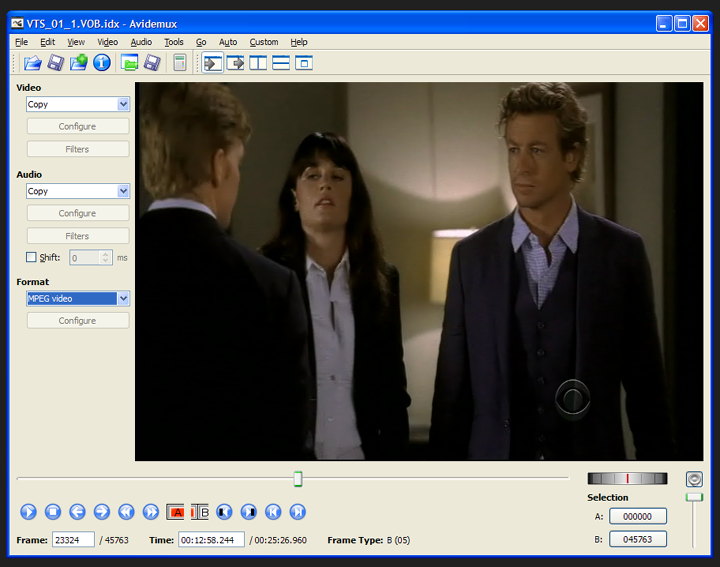

    sanlyn, thanks for the instructions for installing Avidemux. Last weekend I got to cut 30 seconds and tried to upload it but it took forever; I ended up uploading 10 seconds only. I had to format in MPEG-PV (A+V) because by formatting in MPEG Video would not record sound.
