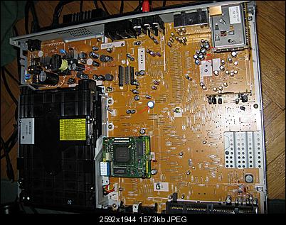

  7. I bought the dvd and fucked up. The unit powers up shows self check starts no dvd in drive ( wich is normal ) and no picture i can enter menu by entering function key on the remote and setup there but no picture from inputs ( any of them au1 to au4) also the tuner search for channels but couldn't find none. I change one capacitor on the power board that was locking horrible ( opened and dried out) 1500mf 16 volts and change it with one 25volts 2200mf was I wrong I think not ( it should be better with bigger capacitor not worse) I also change one on the middle 470mf 16volts with one exactly the same ( the capacitor looked a little chaby fat at the top someway concave while all others are slightly convex or flat ). 3 more near the tv tuner look the same but i didn't change them could be from them?.
    So I don't have picture from any input ( i tried it with camera and with vcr s video and video connection and the same ).
    I consider myself little electronic literate but i never suspect5ed this could be some chip gone bad or something
    Interesting thing is that dvd is not showing any error ( even in service mode last error code and it says FL00 which is no error shown)
    Someone edv or others that have some electronic knowledge what could be wrong with it
    A also downloaded the service manual but i don't have the equipment to test the chips on the motherboard
    Some suggestions will be very appreciative I'm very frustrated now
  8. Click image for larger version
ID:	11580 Click image for larger version

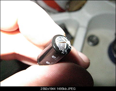

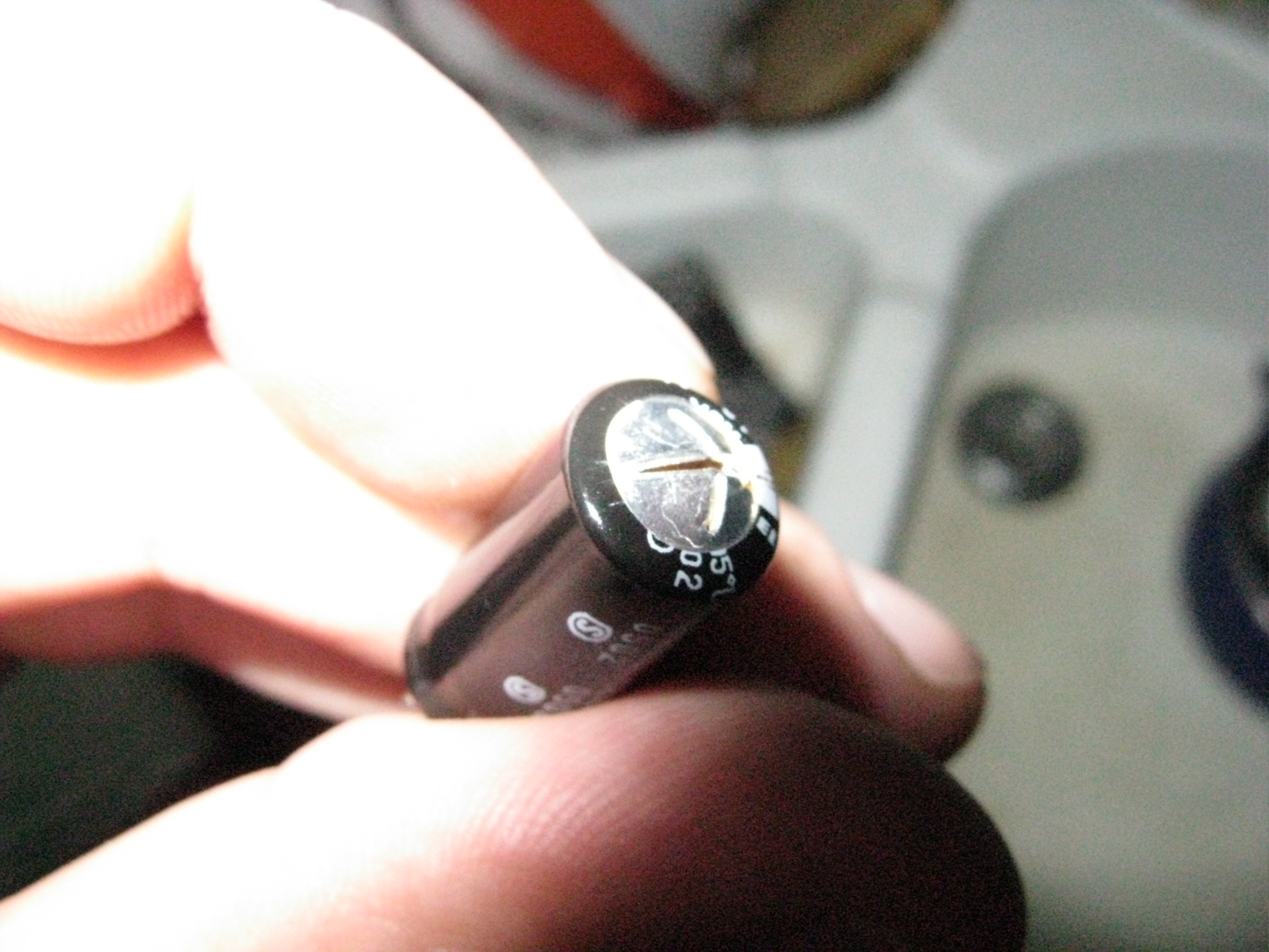

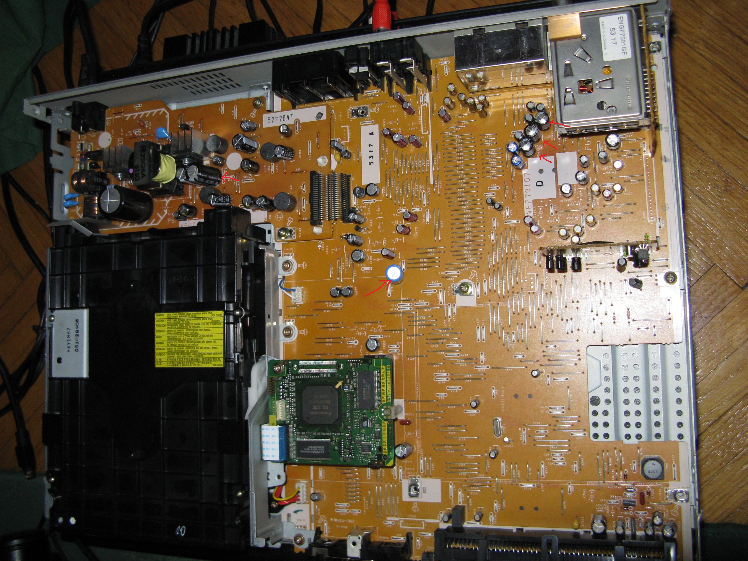

ID:	11581 the dried out capacitor is the black one the most left one in the upper corner on the power board
    The 2 left ones are changed ( the black one is the 2200mf 25volt )the three right marked are suspicious and still not changed
    I let the tape run now and i uploaded video sometimes it shows some redis bluish grenish backround of moving picture very pale picture and disappears constantly
    I changed the three suspicious capacitors and there is also signal losting periodically and there is some other sort of mush input pictures different colors than before but almost the same anomalies
    http://www.youtube.com/watch?v=AT5kXmXHfr0&feature=youtu.be
    after i changed all the capacitors and power uped the unit now it goes to hello then bye then hello then test av1 and again bye and so on. I returned the capacitors ( the broken ones) and the same thing so its not them
    I measured the power board is ok delivering all the powers that are on the service scheme. the powers on the dvd drive connectors are all there.
    Some interesting test i done is if I take the mpeg board out and take the dvd drive out it shows u99 error which is error between ic timer ( which is mpeg board ) and main microprocessor if i put the mpeg board in without the dvd drive jacked in it goes on the same loop hello buy test av1 and again till i hold power for 5 sec and goes to power off and the clock is showing 00 again.
    I tried the mpeg board from the es15 ( even looks the same as the es10 )and from the e55 the all have the same connectors
    and put it in the main motherboard I get the same exact massage and loop, so i suspect that its not the board but something in front of it but still cannot figure it out.
