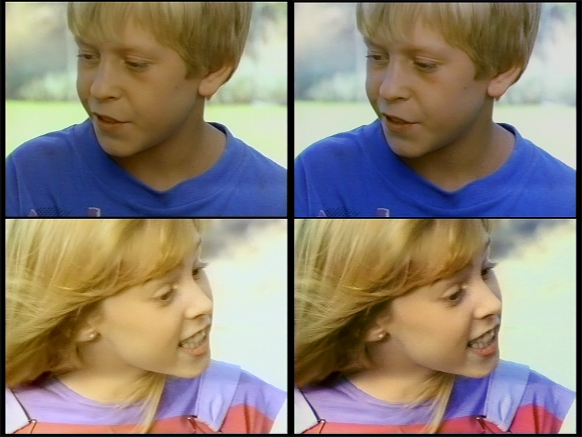

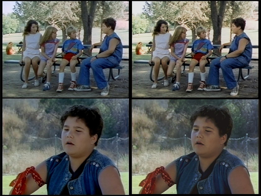

    A few tweaks with your test32 mpg. And a sample of crushed detail. Nice work on some of those shots; as usual, VHS has those crummy level and color changes. Always happens. Pain in the neck. Here are some before & after tweaks:
    [Attachment 11927 - Click to enlarge]
    [Attachment 11928 - Click to enlarge]

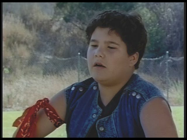

    Note the lower-left image in the lower group of frames. The kids is too blue, but the major problem is that his hair is a purplish-black blob instead of a lighter color (his hair looks dark brown in other shots). His t-shirt looks blacked-out but is navy blue in other shots.Had to play with levels and color in YUV before trying to tweak these close-ups of him. Visually these shots of the kid don't look like the other shots -- very common with VHS. Dont'cha just love it?
    In the image below I purposely brightened only the color and luma below RGB 64. Note the darkest areas in his hair, darker shadows on the denim vest, and the dark t-shirt under it. These read down near RGB 0-0-0 in the original post. Colors in that area were crashing against the left-hand side of histograms, indicating crushed darks. You can raise the brightness level of those areas all you want; they will always look dark gray, no color change, and no detail. In this image the RGB 0-0-0 sections were raised to RGB 34-34-34. That will never change hue (always gray) and no detail can be retrieved.
    [Attachment 11929 - Click to enlarge]
