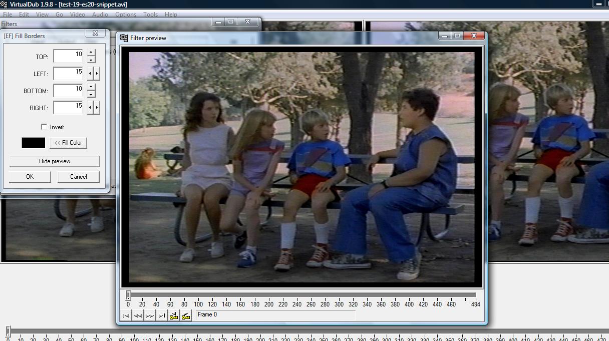

  7. ES20 arrived. Here is a raw capture (DNR off) from the park bench scene posted earlier. The signal is a lot more stable, and the left border is pretty much a straight line, the right border is better, but not completely straight. I tested out the DNR, and it wasn't that great as noted earlier for this source. I am much happier with the capture, there is some annoying combing in some areas when the clips I tested are IVTC'ed. I'm thinking there still must be some alignment issues with lines within the frames causing it. Could a better VCR or source help? What do you guys think?
    test-19-es20-snippet.avi

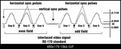

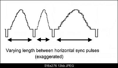

  10. It's caused by horizontal sync time base errors. Remember fields are recorded sequentially on VHS tape. So the two fields that comprise the frame have different horizontal jitter. Hence the residual comb artifacts, even if the IVTC is perfect.
    Then a TBC should correct it, shouldn't it? I'm running two, both a line TBC in the VCR as well as an external frame TBC. If I'm reading what you're saying about the cause correctly, the line TBC in this Panasonic VCR should fix it. But it doesn't. It fixes a lot, so it's not as if it's broken or of poor quality or anything like that. I don't think.
    And if you're also saying a VHS tape stores fields rather than frames, then thanks because I didn't know that.

    TBCs aren't perfect. There's still a little jitter left, even in the best of circumstances. With second or third generation tapes they may do little. If the jitter is embedded into the signal they can do nothing.

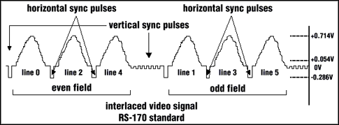

    All interlaced analog video (ie, all standard definition video) is transmitted as a continuous, linear, one dimensional signal; one scanline at a time, one field at a time. It travels over composite or s-video cable as scanlines and fields.
    http://zone.ni.com/devzone/cda/tut/p/id/3020
    VHS is a linear analog recording of that analog signal onto tape. On playback the player just reads that signal off the tape and sends it down the cable. The TV scans that signal onto the two dimensional screen as scanlines and fields, making a picture. A capture device captures two successive fields and weaves them into frames.

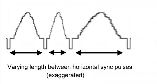

    When a VHS tape is recorded and played back the speed of the rotating drum that reads the signal varies a little bit. This causes the duration (position and length as seen on the screen) of each scanline to vary:
    A line TBC works by digitizing the sync pulses as well as the picture information between them. It then measures the distance between successive sync pulses and stretches or shrinks the entire line to match the standard.

    The picture looked ok to me, it had a slight flicker (which could be caused by a poor or lose cable)
    Don't have the codex for this type of AVI file, played it in Virtual Dub.
    Please understand when you play VHS recordings on a TV, you don't see the excess scan lines.
    It looked pretty normal.
    You normally have scans lines at the bottom of the picture, and the edges are usually never perfect, even on digital stuff. Most of the time it makes no difference.
    However if you want to watch it on your PC and never be bothered by the scan lines, than just add boarders like so. Personally I don't do this cause the playback is for the TV and you always lose 5 to 10% of the picture, depending.
    [Attachment 11857 - Click to enlarge]
    From the earlier posts, the slight flicker is partly on the tape and partly the fault of the VCR. The owner has another VCR with better tracking, but doesn't like it.
    You have the codec somewhere, or VirtualDub couldn't play it. It's compressed with Lagarith.

  16. Originally Posted by Deter View Post
    The sides will still be visible since black bars are on the sides of the frames. The uneven border will show, at least on my TV when I playback MPEG2. I mentioned the left and right sides since I take it as an indicator of how well the line TBC is able to get the lines to the theoretical width along the whole frame.

    Originally Posted by videeo View Post
    What is the "theoretical width"?
    Who knows, but if all the lines are all the same, then I should end up with straight sides on the frames.
    I get your meaning. The borders should be straight. They might shuttle side to side a bit (that's what's called a "projector" effect), but it shouldn't wiggle or bend.
