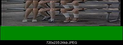

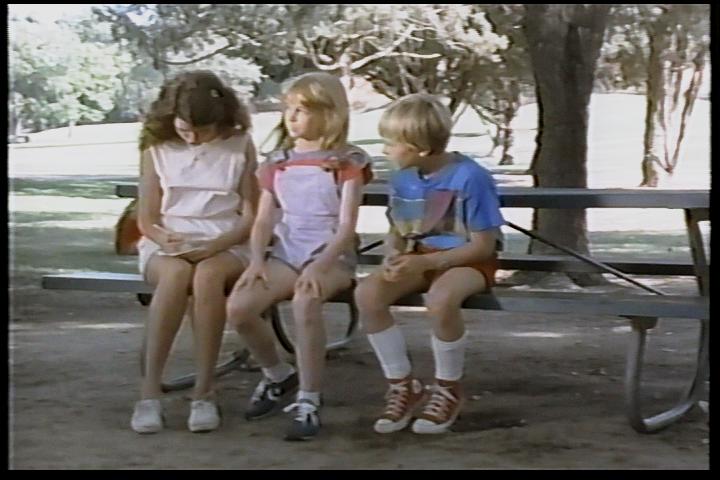

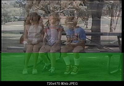

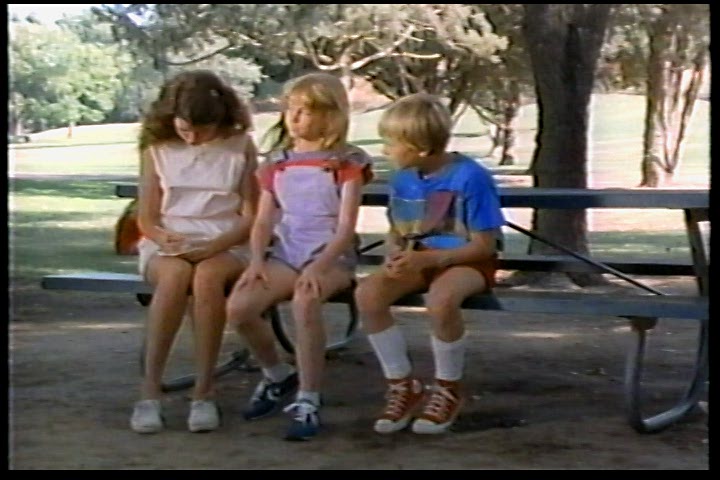

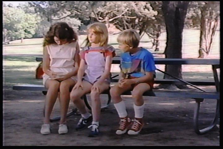

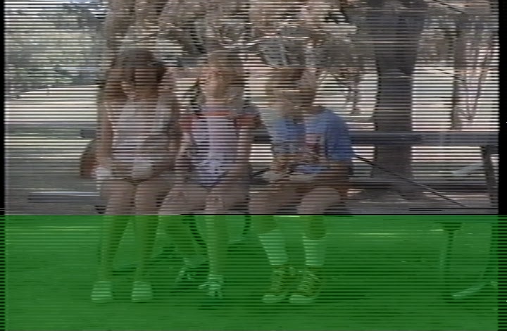

    So, videeo, put all these scripts together on tst4.avi, and it starts looking OK. I don't know why some shots in there look soft, others are sharp (good ol' VHS!). I'd say it's a good candidate for the restoration area. For those who don;t know what's going on with field-replace script in post #6:
    Original frame 0 of test4.avi, no processing:
Name:	frame 0, original.jpg

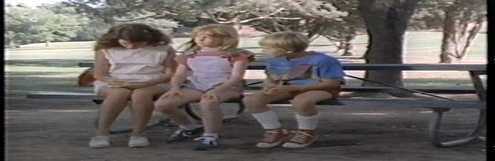

    Using SeparateFields(), this is Frame 0's TopField:
Name:	frame 0, TopField.jpg

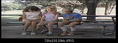

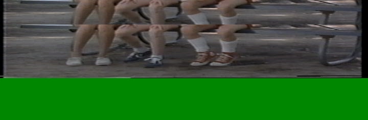

    Frame 0 Bottom Field:
Name:	frame 0, BottomField.jpg

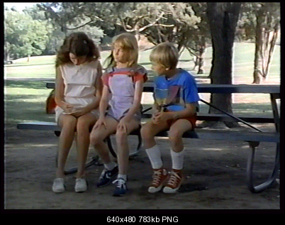

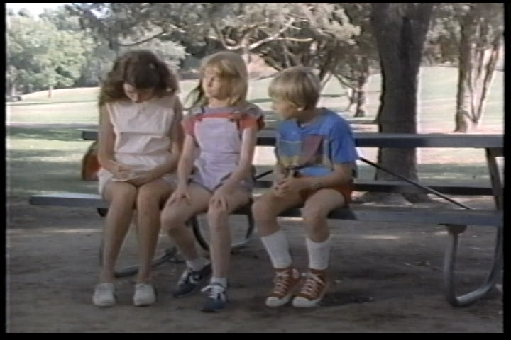

    Bob the frames (you could use Yadif, as well), and replace top with bottom:
Name:	frame 0, Fixed.jpg

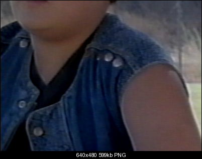

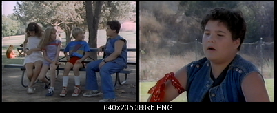

    Maybe a couple weeks of worth on overall PQ. Here's a quick effort. Still some work to do, but I think it'll float.
Name:	Frame0-More To Do.jpg

    Originally Posted by videeo View Post
    Here is my attempt at combining the different scripts to get the video IVTC and the jitter automatically fixed:
    [Attachment 11650 - Click to enlarge]
    There are still some artifacts in there, but I think it's on its way to becoming a good transfer. Thanks for the help along the way. I ended up buying an ES20 to see if I can get some cleaner signal to my capture card. I'll report the results once I get to try it out.
    Good show on the ES20. Mine still works (but it's my second copy). Use that and s-video, you'll see improvements.
    Looks as if you have the script running OK. The repair functions didn't address noise or artifacts. It will take some playing around with plugins, usually chosen to address specific problems. MCTemporalDenoise is a multipurpose job, but like most such things it still leaves specific areas to be touched-up. I'd try that by itself first, then check what's left. I didn't see many obvious artifacts in the video, but there's some chroma bleed and what looks like fine-grained dot crawl. S-video, tbc, and MCTD should help with some of that, but nothing can catch all of it.
    Time to put that ES20 thru its paces.

    [Attachment 11649 - Click to enlarge]
    If I use the rev "C" AviSynth filters + "C" VirtualDub filters, I get a more blown-out background, where a lot of detail is lost:

  24. Banned
    New York, US
    The last video I put thru VirtualDub and color work was 2012032300633703_c. The settings for the filters are in the ,vcf file, posted earlier here.
    Did you do anything different to this last jpg you posted?
    I mounted the video in VirtualDub and fiddled with gradation curves for about 5 minutes. Even at that, those shots need more work. The scenes that follow it wouldn't use exactly the same filters.
    You can't use the same filters for every video. Often, not even for every scene in a video. Tape playback isn't that accurate or stable. And denoisers and other filters can alter contrast and colors.
    This kind of detail is restoration, not capture. Once capture problems themselves are solved and your routines are set, then frame repair, ivtc, jitter flicker, denoising, fixing artifacts, color and such are a different matter. What we've been doing after capture so far have been fairly simple adjustments to see if a video is worth the trouble - to ascertain how much more has to be done. Tape captures will never look like DVD recordings off your digital cable box. They look like captures from tape. Bringing those imperfect captures up to snuff for digital display is what has to happen with old media.
    The basic color balance in the jpg is about right, actually. But remember that luminance adjustments are also a part of those "C" filters, designed for a different scene and a different capture. Takes a while to learn to fiddle with color filters. But try this:
    Add an extra ColorMill filter to the filters you already have for this scene. You can mount more than one copy of the same filter. In ColorMill, turn on the preview button. On the left of ColorMill's window, click the "Levels" button. Pull the "Darks" slider down about 8 points. Pull the "Middle" slider down 8 points. Leave "Light" as-is. You'll see the mids and lows start to shape up.
    Click the "Saturation" button. Raise all three sliders on the right upward, about 12 to 15 points. What you're doing with ColorMill is modifying the effects of the other filters. If you had set up some filters more suitable for these low-contrast low-saturation shots in Test4.avi, you would keep the same filters most of the time but add one or two "tweaks" to modify scenes that require it.
    But the basic principle is: you can't use the same filters for everything. Everything doesn't look alike. Especially tape.
  25. Originally Posted by sanlyn View Post
    Understood...I am trying to figure out how you got the improved color without blowing-out the background (well it's a little blown-out on the upper-left grassy area), because I have been trying to figure out how to do it the past couple of days. If you happened to save the settings, it would be great to take a look at your .vcf file. With your recommended addition of Colormill tweaks on top of the rev C filters, it still is a bit off.
    Here's another try:
  26. Banned
    New York, US
    That background is blown out no matter what. The bright sunlight back there and the darker shadows under the tree -- it's too wide a contrast range for video. In real life your eyes (and your brain) adjust to that range, but film/video can't do it.
    I didn't keep the settings for that single image, mainly because I knew it wasn't quite right and because they wouldn't work in the next couple of shots. Later tonight I'll work with it in more detail. But you're in restoration now, babe. This has nothing to do with capture.

    videeo: had a PC repair job last nite, bot back mighty late.
    The JPG I posted of frame 0 with the quick color work is too red. I toned it down a bit. A vcf to accompany the script for Test4_new1 is attached below.
    I combined my scripts as you did, but usually I run scripts like this as separate runs. It goes faster, and if I change something I don't have to run the whole thing over again. This script runs sloooow with all the steps in one. The AVS below has different routines than the one you posted earlier. It's klutzy, I reorganizerd it rather quickly. But I copied your path/filenames into the one shown here:
    Test4_New1.avs:
    LoadCplugin("K:\AviSynth 2.5\plugins\yadif.dll")
    Import("K:\AviSynth 2.5\plugins\stab.avs")
    AviSource("J:\forum\videeo\test4\test4.avi")
    ## Input is 720x470. Add 10 pixels for a border to get 720x480
    AddBorders(0,2,0,8)
    ConvertToYV12(interlaced=false)
    Crop(0,0,0,-8)
    AssumeTFF()
    yadif(order=1,mode=1)
    Stab()
    SeparateFields().SelectEvery(4,0,3).Weave()
    Crop(0,4,-2,-2)
    AddBorders(2,4,0,10)
    #   Inverse telecine/decimate. Result is progressive video
    #-  in its original state as 23.97 fps movie film
    AssumeTFF().TFM()
    TDecimate()
    #  replace bad field in frame 0
    file1=last
    file2=file1
    file2
    Trim(0,-15)
    AssumeTFF().yadif(order=1,mode=1)
    FreezeFrame(1,1,0)
    #-- ------------------re-interlace ----------------------
    file3=last
    # --- replace only one frame in original source ---------
    file4=ReplaceFramesSimple(file1,file3, mappings="0")
    file4
    ColorYUV(gain_v=-5,gain_u=-5)
    MCTemporalDenoise(settings="Low",enhance=true,edgeclean=true,useTTmpSm=true)
    LSFMod(125)
    AddGrainC(var=2.0,uvar=3.0)
    #   RGB conversion for VirtualDub. Omit if not wanted
    #-  and then save as YV12.
    ConvertToRGB32(matrix="Rec601",interlaced=false)
    return last
    The .VirtualDub vcf calls for ColorMill, which I think you have, and uses VDub's built-in sharpen filter at low default. It also uses Donald's Graft's GUI-enhanced Bright/Contrast plugin, which I have attached below. Open the AVS in VirtualDUb, and before you hit "Save as Avi..." load the .vcf file. You can usually run avisynth and VirtualDub filters in the same run.
    In the post that follows this I'll show you why the filters for the first part of that clip won't work for the other scenes -- and why I think you should be using your old RCA combo for this video to get much better (and easier) results..
  30. Banned
    New York, US

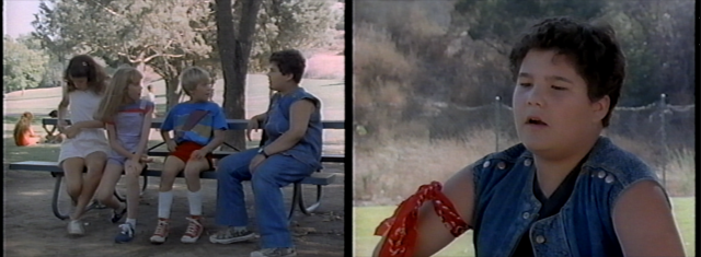

    This Frame 0 in the test4_new1.avi you get from the above script. All the frames shown ehre are resized to display size 640x480:
    The filter settings in the .vcf were set specifically for this scene, which doesn't look the same scene in later shots. It has different luma levels and color balance. The original looks washed out -- but so do all the other scenes in the original capture. This is how those same filters look in other shots from the same clip: (filtered frames 107, 183, 451, 509):
    I think you can see what I'm talking about. This is commonly the way VHS plays back. With the filters for scene #1, subsequent scenes are too dark and saturated, and red and blue look like neon. But I think the VCR you used for this capture isn't helping a bit. Here are two frames from the original test4.avi capture, before any processing:
    The original park bench scene looks washed out because the VCR's contrast range is so anemic. At the same time, red and blue look oversaturated; they tend to pop off the screen. The kid on the right has pale-looking blue arms. If you increase saturation and contrast to get a more natural look, those two colors look even worse. The image on the left of the kid in denim looks horrible. There's chroma nosie everywhere in red and blue. ANd here';s a closeup of what that VCR does to shadows (it did the same thing to the earlier 20120323000633703.avi). This edited frame is enlarged 2X with bicubic resize:
    Those skin shadows are just plain rough and ugly, and really difficult to work with. You also have edge artifacts. These colors are really unnatural, even for a scene shot in the shadow of a tree. In that earlier AVI of this same video with flying saucer shot, this rough blue chroma noise in skin shadows even showed up in warm daylight shots. I didn't see obvious effects like these in the capture of similar scenes that you made with your old RCA. In fact that RCA capture would have required very little correction.
