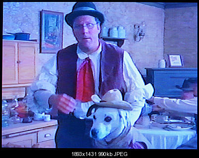

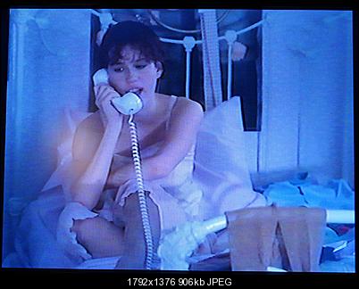

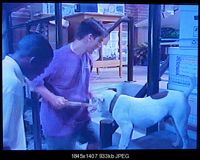

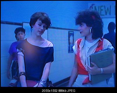

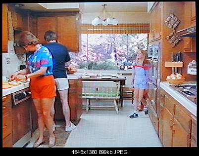

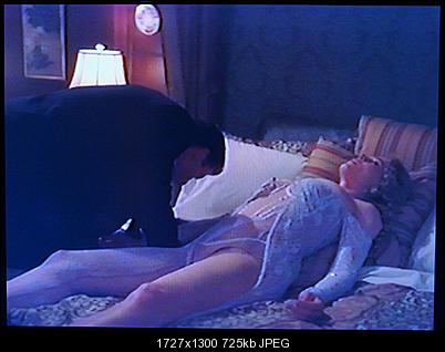

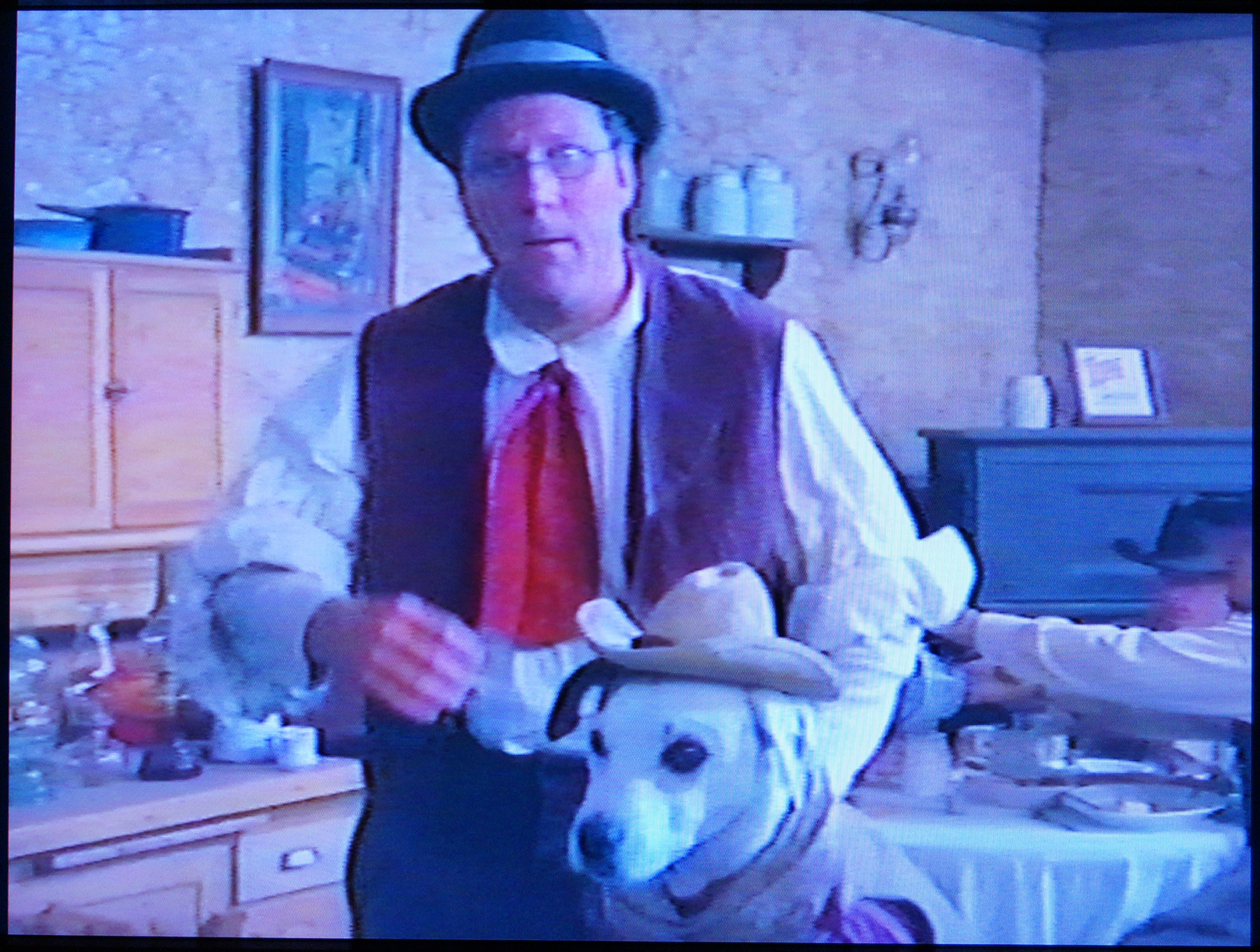

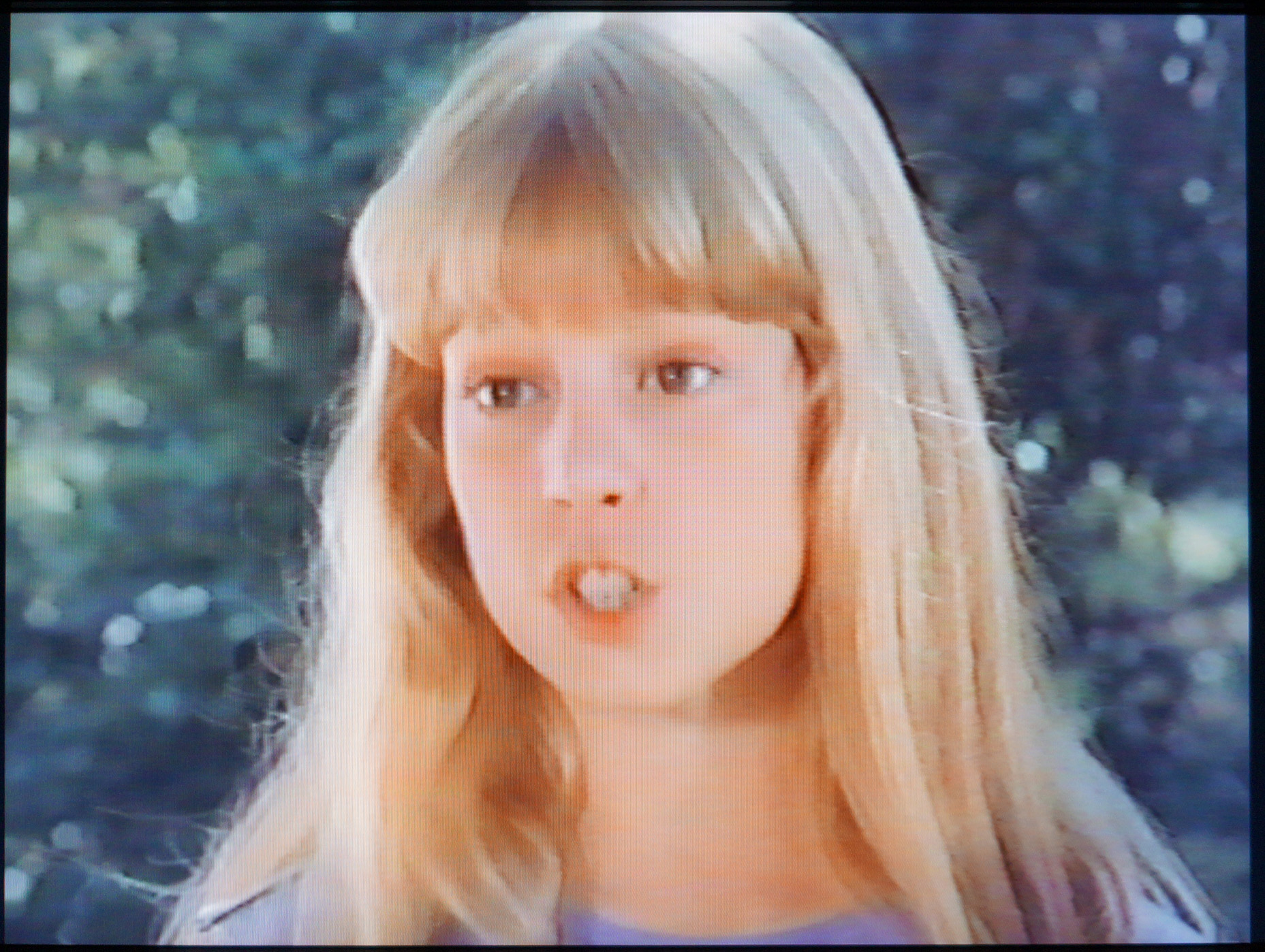

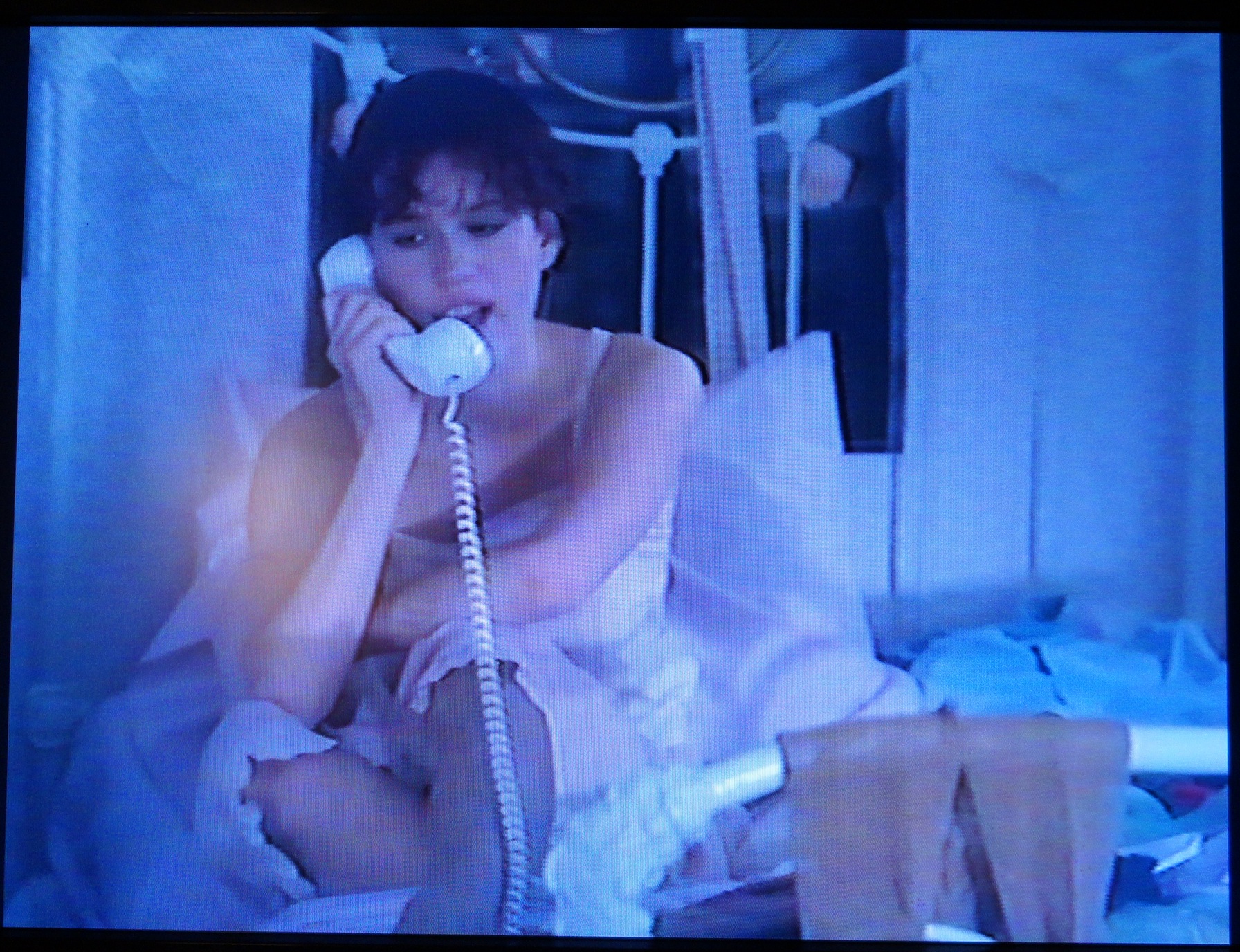

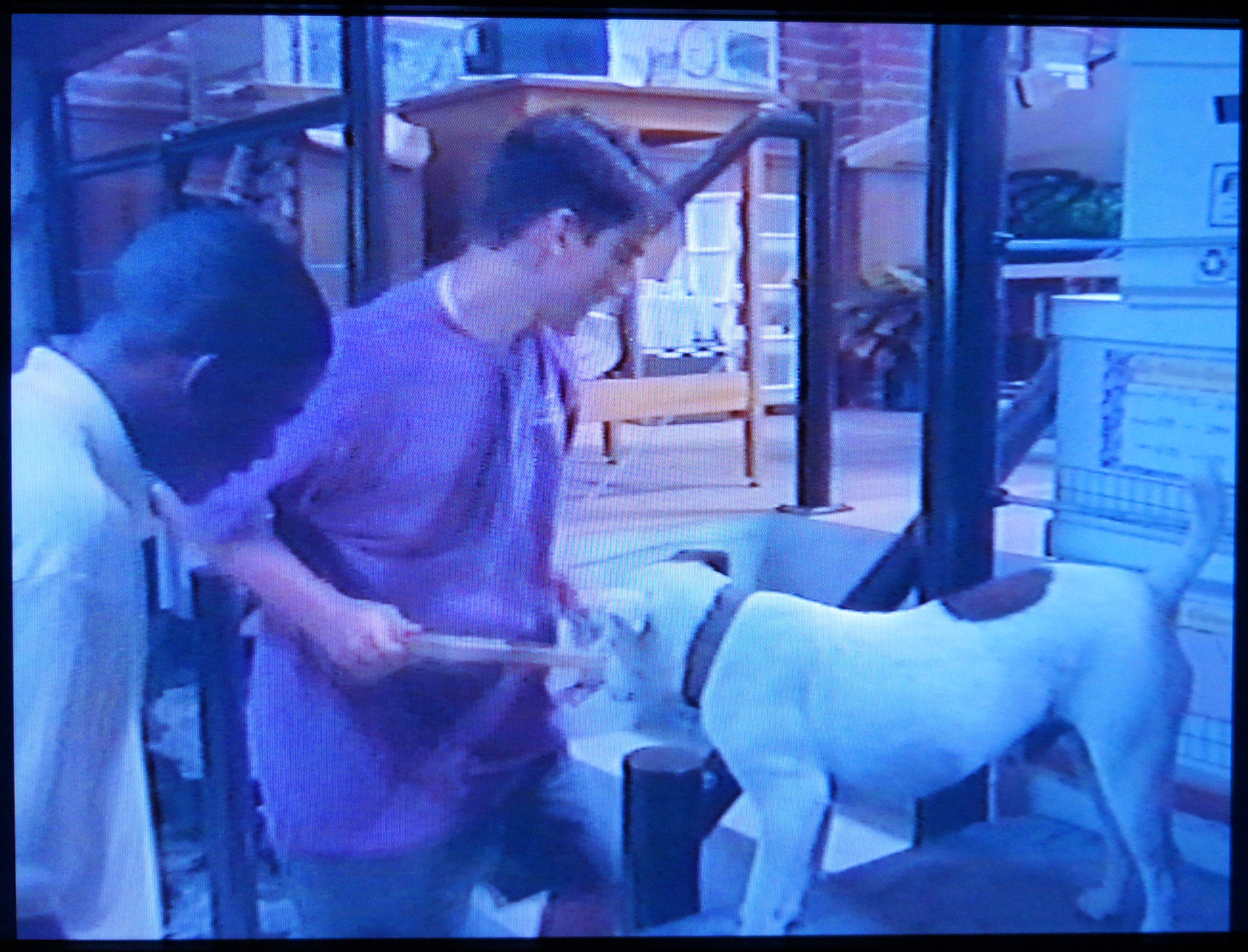

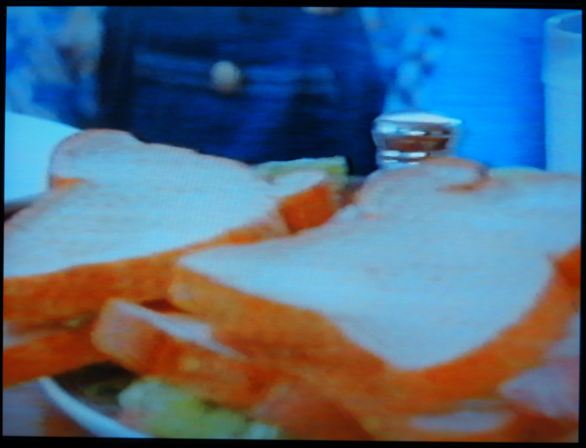

  7. Here are some captures (these are test videos, not the ones I am trying to capture, they are in storage) they do have a slight reflection from a lamp in the room:

    You should use the videos you plan to capture. Turn the lamp off. Can't say anything about the color, because the tv type is unknown. There is a lot of banding, moire, dot crawl, cross-hatch patterns, and other noise, plus red push on the tv. The strong blue might be coming from your camera's color temp setting. These videos don't seem to be in bad shape, but they're not the videos you plan to work with. Remember that what you've posted aren't captures, they're photographs. Were these played directly to TV, or were they recorded to DVD or something first?
    If you plan to do any video work on your PC, you should calibrate your PC monitor. There are test patterns you can use for this, but calibrating consumer monitors without some basic software/hardware gear for that purpose is simply impossible. There are kits available from XRite and Spyder (Xrite strongly recommended). For PC work you meed VirtualDub. For serious video problems you might need Avisynth. If you're going to capture directly to a DVD recorder, be aware that the few DVD recorders sold today are inferior to those of a few years back. If these videos actually appear as you photographed them, there's something amiss with the TV, the video, the camera, or all three.

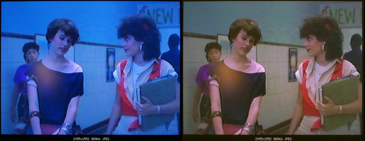

  9. Try this videeo
    ImageReader("C:\Users\lin\Desktop\blue-0002 .jpg")
    assumetff()
    converttorgb32(interlaced=true)
    input=last
    LoadVirtualdubPlugin("C:\Program Files (x86)\virtualdub1.9\plugins\ColorMill.vdf","colorm ill",1)
    #colormill(25700, 38992, 18814, 14436, 29284, 32085, 29284, 31568, 20599, 25708, 25700, 25700, 25700, 1124, 5)
    colormill(25700, 38992, 18814, 14436, 29284, 32085, 29284, 31568, 20587, 18796, 25700, 25700, 25700, 1124, 5)
    LoadVirtualdubPlugin("C:\Program Files (x86)\virtualdub1.9\plugins\Camcorder_Color_Denois e_sse2.vdf","ccd",1)
    ccd(16,1)
    stackhorizontal(input,last)
    result:

    Much better, themaster1. Working from the images has severe limitations, but it's an improvement.

  11. Member Deter's Avatar
    Dec 2007
    That is molly ringwald, so this should be a stock video and the colour should never look like that to begin with. Why are these images some crazy aspect ratio. If it is VHS it should be 720x480 or half D1, if you used that method.
    Yea the color looks better in the THEMASTER1 picture, but you shouldn't even need to do this.
    Personally don't like the detail of some of pixels either......
  12. The photos were taken of my TV while playing back from the VCR. I'll see if I can post one of the actual videos to convert tonight. The Wishbone one I might digitize though since they never re-released it on DVD and that one seems to show a little wear since it was from a public library.
    The color might be off due to the white balance setting on my camera. I'll pay more attention this time I post. Thanks themaster1, that image does look way better. Aside from the color issues, which may just be artifacts of the way I captured the image, does it look like I would get improved alignment between scan lines with a JVC VCR that includes a line TBC? The videos I plan on capturing are out of print commercial ones, so the quality should be OK, though I think one might have been a used rental copy.

    The images aren't captures. They're photos taken off a tv screen. Impossible to say how the originals look, but the image format is very close to 1.3333 (4:3 SD). Goes without saying, if the owner wants to archive tape to DVD it would be rendered 720x480 for 4:3 playback.
    Half D1 should never be used for VHS.

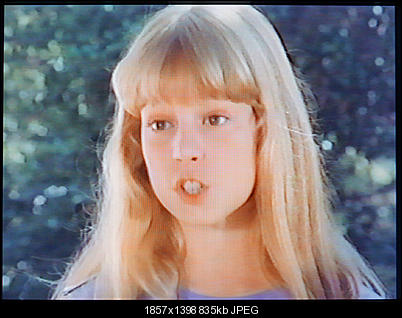

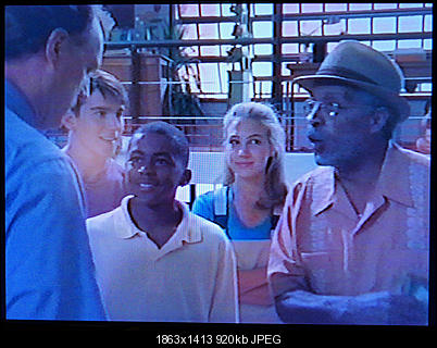

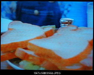

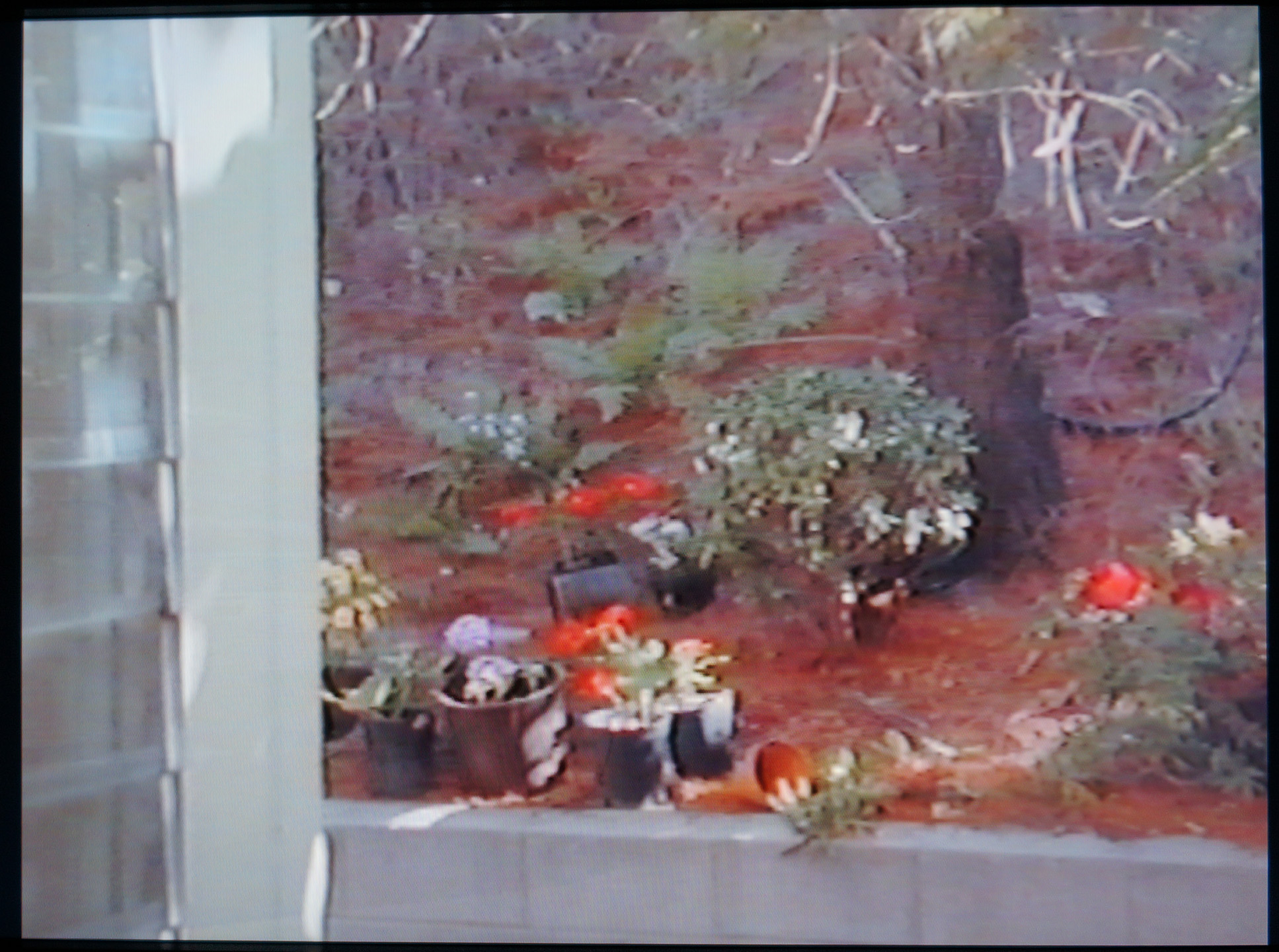

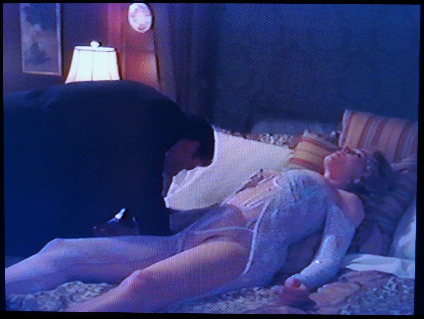

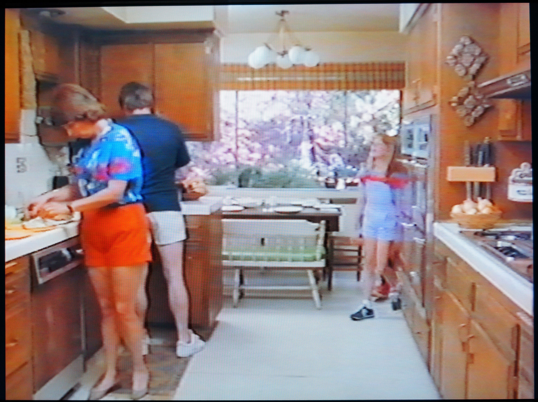

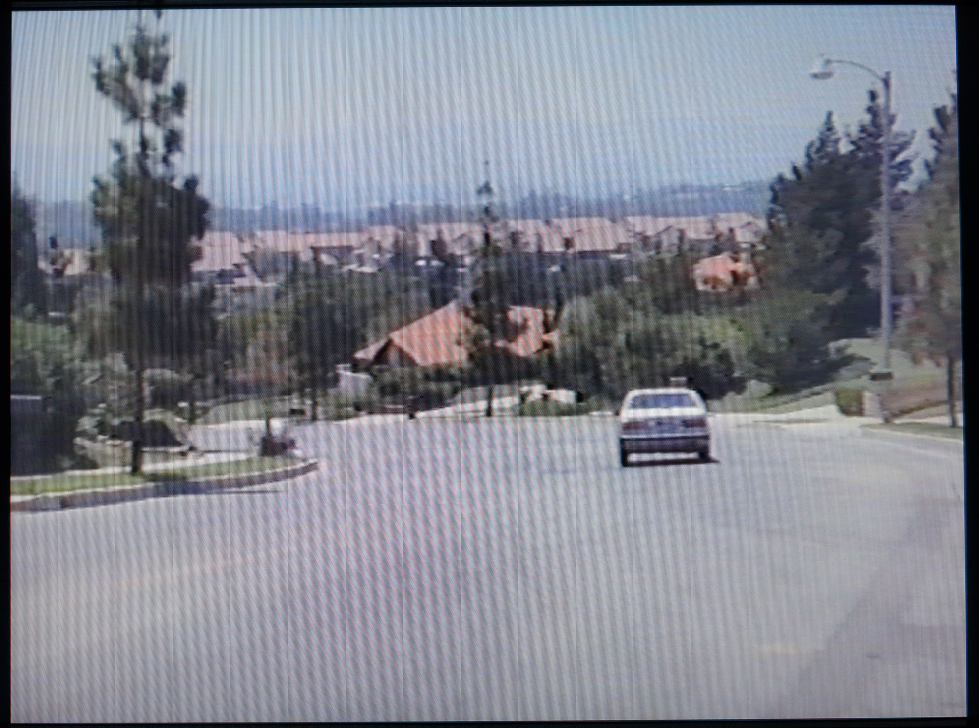

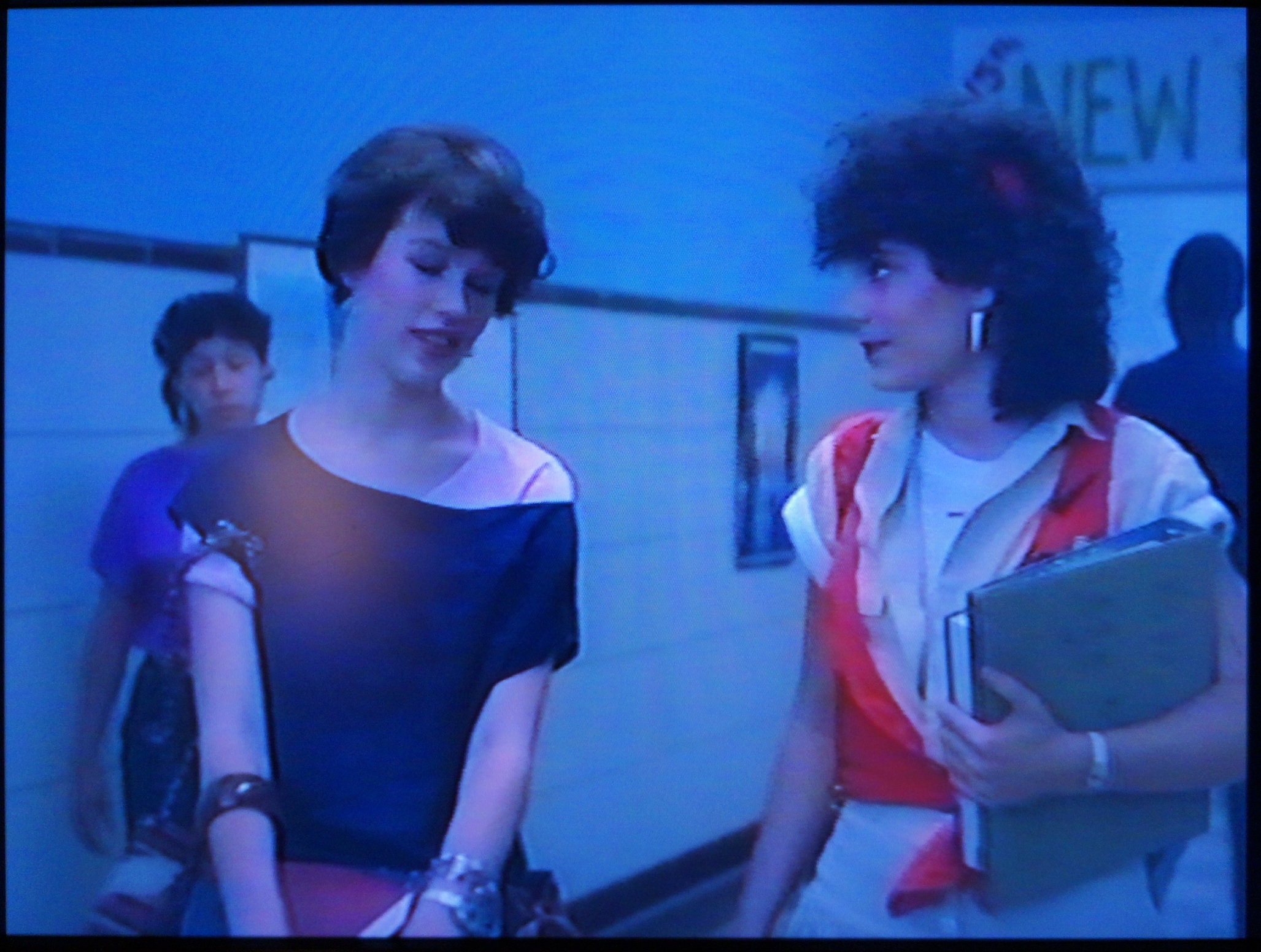

  17. Yes, I went through the list in the recommendations for VCR's, and noticed they are hard to find or expensive without the seller showing proof of quality of operation. I don't mind getting another unit if it would clean-up the video. I was also thinking those recommendations might be geared toward being machines that can handle any situation, including poor home recordings. I was wondering if maybe I can save some money if getting one of those units is overkill for the state my footage is in. Below I have camera photographs of the main tape I am interested in archiving the best I can. It is played with a Mitsubishi HS-U445 over RCA composite. I think the white balance is a lot closer, however, I am more interested in assessment about the other aspects such as alignment of the scan lines and noise or lack of detail that may be resolved with another VCR. This video has a sticker on it that says "Standard Speed Duplication".

    I have seen some captures in past posts in this forum and feel that this footage could probably be played a little better and show more detail.
  18. Two things to note here:
    a) it's almost impossible to tell much at all from camera shots of a television screen as far as the quality of the footage in terms of detail
    b) you can only tell so much from a still
    I'd venture a guess and say that this footage you just posted looks in fine shape -- but as I said, it's hard to tell much. Standard Speed Duplication just means it was dubbed in SP I believe, although typically those stickers are intended to notify consumers that the video has been dubbed in LP or SLP/EP. I've never seen one announcing an SP dub, but check your VCR to confirm.
    As far as what to do -- it really depends on what you want and how much of a hassle you're willing to go through.
    If you want the very best quality out of your tapes, be prepared to spend a big chunk of money (capture card and/or hunt down one of the stellar used DVD recorders that used the LSI Logic chips from 2006, proc-amp, detailer, TBC, SVHS VCR w/ Line TBC, etc) and lots of time (learning to use the equipment, software for further restoration, etc). If you go this route, be prepared to spend time testing the equipment out and probably ship some stuff back to the seller when it doesn't arrive in fully working condition. This is a long and arduous road, but if you have a lot of footage or some money to burn, it can be a fun hobby too.
    If your budget isn't very high and your VCR is up to par in your opinion, then get a good capture card and you can spend more of your time learning how to improve things in software.
    Another alternative if you have very little footage is to let someone else handle it for you who already has the equipment and know how. That may end up being must cheaper and take up far less time than taking it on yourself.
    There really is no magic bullet VCR -- that's why so many of us have multiple ones and switch them in and out of workflows to deal with various issues. In many cases the tradeoff is between one set of undesirable issues for another set of less undesirable issues -- in that situation, the trick is to come up with a set that can be remedied mostly in software or with supplementary hardware.

    Mm, well...I wouldn't obsess about SVHS players. Those players don't play EP tapes well anyway, and even at SP a VHS tape on an SVHS player still looks like VHS -- it won't look like SVHS. It can't. They might have s-video outputs, but they're inferior to the comopsite->svideo converters, comb filters and TBC in passthru's that I described earlier.
    There is not much detail in these images. True, if shot from a tv screen that's a somewhat inconclusive point, but the shot of the car on the road has no detail at all (look at the trees), nor does the garden shot. The kitchen shot has gamma and level problems problems (at least, the image does). If this tape source is EP (slow speed), many VCR's don't play EP that well -- certainly, only one or two hard to find models of JVC's top consumer machines can make EP look useable. I don't know about your specific Mitsubishi in detail, but the better Panasonics from 1996-1999 do a better job, even if there is some oversharpening and a few other problems, but most people seem to like those effrects (it's easy enough to tone that down on a PC).
    In any event, the tapes don't appear to have major damage or anything like that. From the images I'd say they will need some work. As fanuly videos, I'd think they would be important enough to you and yours for at least an effort at improving them. But it's up to you.
