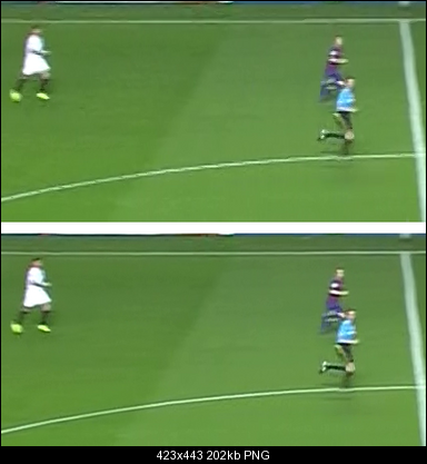

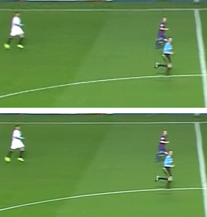

  23. You mean between the two methods? Look at the top/bottom of the circle at mid field during the panning. With Yadif it is broken. With QTGMC it is pretty solid. Yadif top, QTGMC bottom:
    It's less noticeable when in motion but still noticeable -- the line will flicker a little with Yadif. Whether it's worth the much longer filtering time with QTGMC is up to you. If you decide to go with QTGMC you can speed it up by using a faster preset. If you have lots of free disk space you can filter first (so you only have to run QTGMC once) and save to a lossless intermediate, then run the 2-pass encode. But I would use a single pass CRF encode myself. The only reason to ever use a 2-pass encode is when you need to fit a video on a disc.
  24. Ok thanks, the difference is definitely noticeable. QTGMC the line seems to have better AA.
