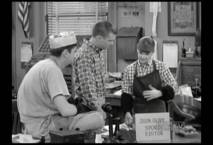

    I have a Panasonic DVD Video Recorder that has the ability to tune to and record digital stations. In this case, digital quality isn't really an issue. I've been using it to record episodes of Dobie Gillis from MeTV, as I really enjoy watching the show. Well as you can imagine, I want to rip the episodes off of the DVD and convert them to another format to cut down on the amount of space used. Getting VMW5 to read the disc isn't an issue.
    Here's where there is an issue though. For some reason, VMW5 is reading the image as being 352x480 when the source is 720x480. Using Handbrake to open the same disc, on the picture tab with a 'strict' anamorphic setting, it's reporting 626x480 to me. (Not sure if that information will be helpful, but Handbrake does confirm that the source is 720x480.) Anyways, I believe that this shrinking within VMW5 is causing the real issue that I'm posting about.
    It seems that no matter what I do for the encoder settings, the quality is lower in the resulting MKV. Considering it's an old show, I would think I should be able to reduce the video bitrate to something low but respectable without an issue (was using 950 with 128bit audio). However even if I have it set to 4000+ for the video bitrate, the result is more or less the same.
    Allow me to clarify on the quality. Overall the imagine is fine. It's just that certain things have suffered an obvious loss in quality when compared to the original (again, even with maximum bitrate settings). What I've been using as a guide is a specific frame from a specific episode where there is a sign with words on it. In the original, the lettings are rather clear (and crisp) even when you consider the fact that the episode was made in the late 1950's to early 1960's. In the MKV, the letters are still readable but in comparison it's not as clear/crisp. (I've included two screenshots. One with 'dvd' is the original source image, other is converted.)
    When I noticed that the original source is 720x480 and not 352x480, that got me thinking that this might be the reason for it, as it's reporting the original height as being smaller than it really is. Would this be correct?
    What I'm aiming to find out are the following:
    1. How in the world do I get the image quality to be better?
    2. How do I get it to treat the DVD video as 720x480 instead of 352x480?
    3. Is there a function in Handbrake to remove sections of a video? I would be using this anyway except that I want to trim out the commercials.
    TIA.

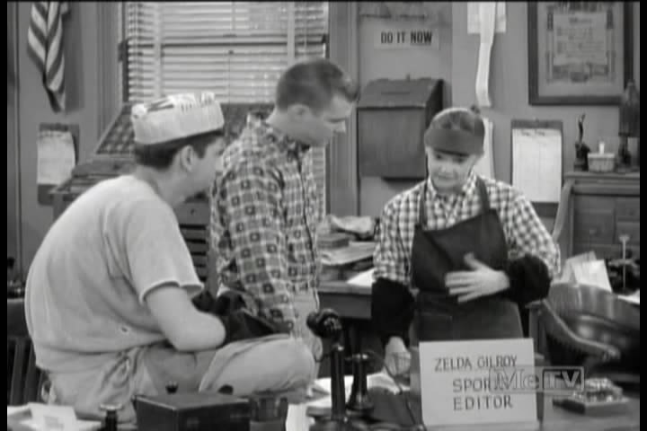

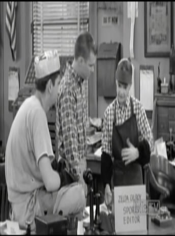

    Edit: Just noticed that the mkv screenshot is squished, even though in the player the image is fine (until I turn off 'keep aspect ratio').. Could that also have something to do with it? If so, what aspect setting should I be using in VMW5?
    Edit: ugh.. I thought I had certain things figured out but apparently I don't.. Might need to go to the newb section.. Added a 1:1 pixel ratio screenshot (has 00.00 in the title). Can still see the quality of the letters is degraded but at least it's looking more normal. All these different aspect ratios and HxW settings are doing my head in...

    It is very unlikely that MediaInfo is wrong.
    However, if there is a bug in VOB2MPG, the bug and the conditions that produce it need to be reported to VOB2MPG's author, ChrissyBoy, so he can correct the problem. I have started making some test recordings to see if I can replicate the bug.
    These are the resolutions and aspect ratios I will use for my samples:
    4:3 NTSC video: 720x480, 704x480, 352x480, and 352x240.
    16:9 NTSC video: 720x480
    I discovered that I had mis-remembered the vertical resolution older Panasonic recorders use for recording modes that put more than 4 hours of video on a single-layer DVD. The correct resolutions used by pre-2006 Panasonic DVD recorders are as follows:
    704x480 for recording modes that place 4 hours of material or less on a single-layer DVD
    352x240 for recording modes that place over 4 hours of material on a single-layer DVD
    I'm using a DMR-EZ475V with it set to record up to 4 hours (LP mode). I have the timer set to start 1 minute early and end 1 minute late to ensure that I get everything. Doing this, I'm able to get up to 7 episodes.
    I'm using a trial version of VideoReDo and on that same episode that I used in the OP as an example, the timing is off. By that I mean that if I seek to the same location as the screenshots, it's playing a playing content from roughly 9 seconds earlier. If I just let it play from the start, it plays just fine. More than 9 seconds were removed from the start of the clip so it's not like it's off for that reason. I guess VRD just has a bug in it.
    I could try to upload one of the VOB's to a free file serving site so you could download it and see for yourself that MI is misreporting the details. Perhaps two VOB's, the two that contain that episode I've been using as a guinea pig. It would just be a matter of getting the size down so that they're within the 'free' limits.
    Edit:
    Oddly enough, I just tried using TMPGEnc MPEG Editor 3 and it's doing the same thing. Weird.

    Since V2M reports the streams as being 352x480, I'm inclined to think that it's 352 and not 704 or 720. I just tried it with another DVD (actual movie) and it's reporting 720 for that. Basically, I'm thinking that the DVD (my recordings) really is 352 even though it'd be nice if it were 720.
