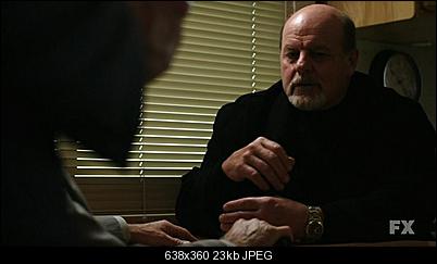

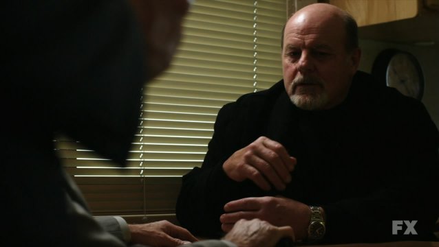

  11. I could be wrong of course... if you're converting the same video using a different program and it doesn't look washed out like it does when converted with DVDFab, then I guess DVDFab is changing the levels while encoding for some inexplicable reason. I've never met an encoding program which does that before, at least not unless you specifically tell it to.
    Is this what you're seeing?
    Correct levels

    Incorrect levels

    If it's more dramatic than that, then something else is going wrong.

    hello_hello, your samples look close, to what I'm seeing, but its even more pronounced with a movie at its a 2.35:1 aspect ratio. The "black" video is light (washed out) compared to the letterbox bars above and below the video. Again, I only see this with DVDFab's conversion to 720p. With VidCoder, I tried converting several versions of the same movie, with and without anamorphic, and with it off, it conversion looks good at both 18 and 20, with a slight edge better at 18.

  14. Well it still seems like it's probably a levels issue, but I guess it's one being created by DVDFab when converting rather than on playback. If so, I have no idea why DVDFab would change the levels. I've never used it for converting. Does it have some sort of setting?
    I guess the simple solution is simply not to use DVDFab for converting (how's that for stating the obvious? ) although it seems rather odd DVDFab would cause that sort of problem.
    Thinking about it, the difference between the two samples would probably look more substantial when displayed on a TV as opposed to a PC monitor because of the differences in the way they display video.

    Well, you're correct. I have difficulty seeing the difference on my 24" LCD monitor, but its very visible on my 61" DLP, probably because the DLP's contrast ratio is much wider. With VidCoder, that's gone for good.
