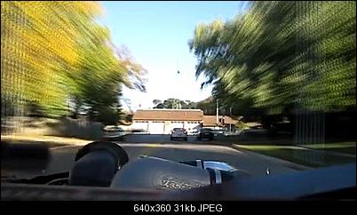

    A random dash cam video from Youtube using this script is attached (h.264 in MKV).
    Nice example.
    There are some artefacts on fast moving objects - probably because the original video was shot with a fast shutter. If the shutter had been set to match the framerate, fast moving objects would be blurred smoothly:

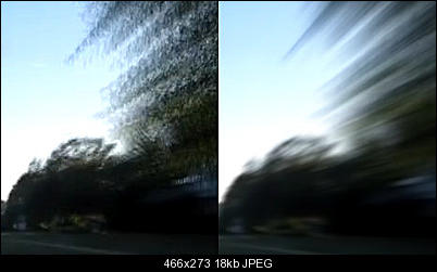

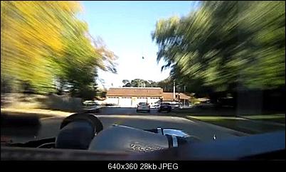

    Of course. Merge() simply blends pairs of frames together. If there's no motion blur in the source you get a multiple exposure look. The OP should use 1/50 second exposure and a 1/50 second frame or field rate. Then apply a similar script.
    The OP could also try using one of the motion interpolation frame rate changers to increase the frame rate then several interations of Merge(). That would look more like motion blur. But the interopolators sometimes introduce artifacts.
    Simple Merge() as above:
    Three DoubleFPS() and three more Merge():
