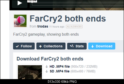

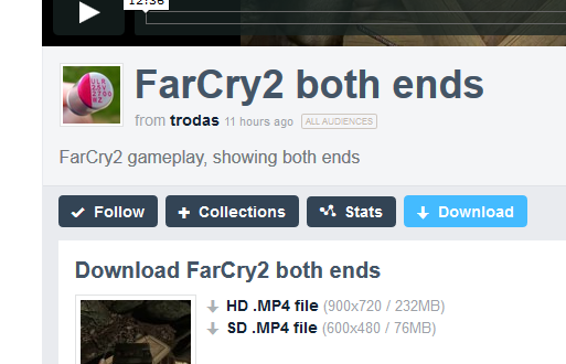

  24. Remember too, whatever encoding settings you use, the version shown by vimeo is reencoded, so the quality takes a hit. (Same for YouTube.) Vimeo Plus members can download your original file if you allow it.

    jagabo - oh, I did misslead you. I used only the one pass encoding, where the top bitrate limit is 4854 kbps... I leaved the Xvid settings on default. Is that wrong...?
    Use an h.264 (AVC) encoder like x264.
    Give it a try. Any good suggestion for codecs like you mentioned? Is not the CUDA encoding by GFX card are supposed to use this codec already?
    smrpix - good call. Original upload was 488MB or so and even in it, the quality takes a good hit. Similar as this 60fps testing example:
    http://www.youtube.com/watch?v=7p-RKhfJAgs
    Original file is 11 041 135 198 bytes long, lol. And the quality is, well, uncomparable. The textures are washed out a lot...
