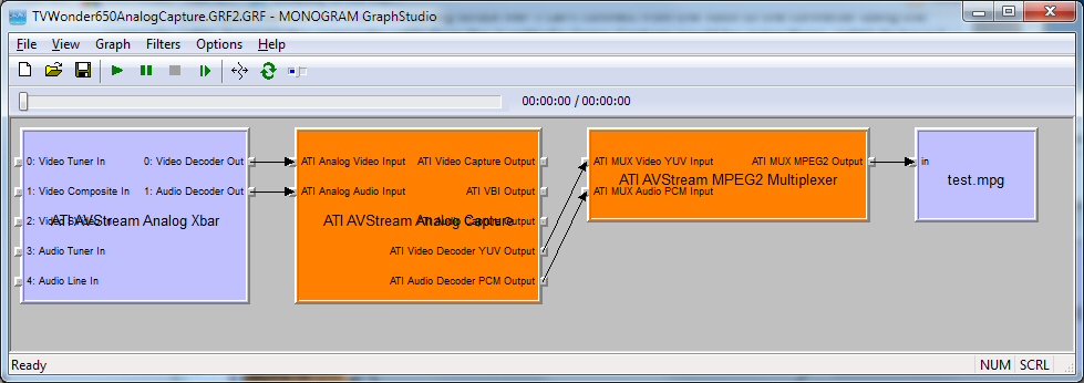

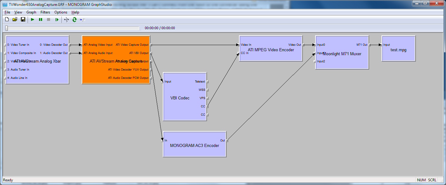

    Aug 2006
    These are graphs for my Theater 650 PCI card. The one for software encoding should be similar to what you would use for your Theater 600 USB device.
    Both GraphEdit and Graph Studio are programs that allow building capture graphs from components provided with a capture device's drivers, and by the operating system, various other software, plus some encoders. Capture software does the same thing internally. These graphs are for capturing using MPEG-2. You would use different encoders and different muxers and file writers for other video formats and container files.
    Here is a general description of how you might proceed using GraphStudio:
    The graph is built from left to right by adding filters and dragging an dropping with a mouse to connect "pins" (little nubs on the filter) to build the graph. Once the graph is finished, and the options provided for the filters in the chain are set up, a user can click on the green arrow icon in the tool bar to start the capture. Clicking on the red square icon on the toolbar stops the capture.
    One adds filters by clicking clicking "Graph" on the Menu Bar, then clicking "Insert Filters". This brings up the Filters window, and filters can be selected using the left-most dropdown list in the "Filters" window.
    The first filter in the graph is the crossbar filter for the capture device, found under "WDM Streaming Crossbar Device". The second filter, also for the capture device, is found under "WDM Streaming Capture Devices."
    If using software for encoding, the "VBI codec" filter came from Microsoft, and it is optional. You do not need it unless you want to record closed captions. Your TBC may even strip CCs. The next two filters to add are the video and audio encoders which might be listed under "Video Compressors" and"Audio Compressors" or "DirectShow Filters". I think the Monogram AC3 Encoder comes with Graph Studio
    Next comes the muxer. The muxer in the hardware encodier graph also encodes. Look for them under "DirectShow Filters". I think the "Moonlight M71 Muxer" came with DVR-MS Toolbox. There is a "Moonlight DumpPos" filter that came with it for a file writer. There are other software MPEG-2 muxers and file writers available from Cyberlink if you installed Catalyst Media Center.
    Choosing all the right filters and connecting them often requires some trial and error, as does configuring the settings for the filters themselves. GraphStudio can sometimes add a missing piece between filters to make a connection work.
