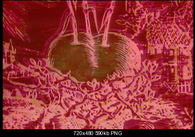

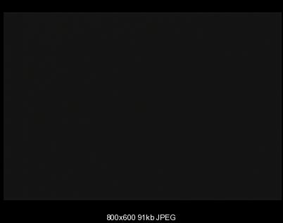

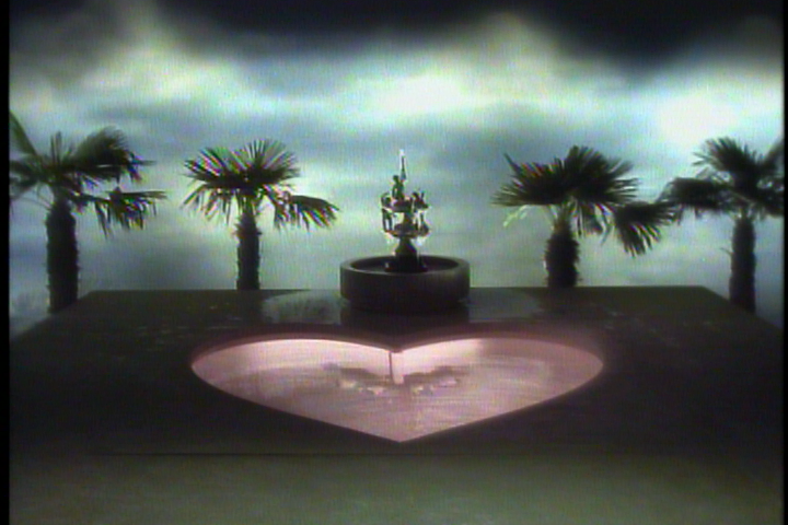

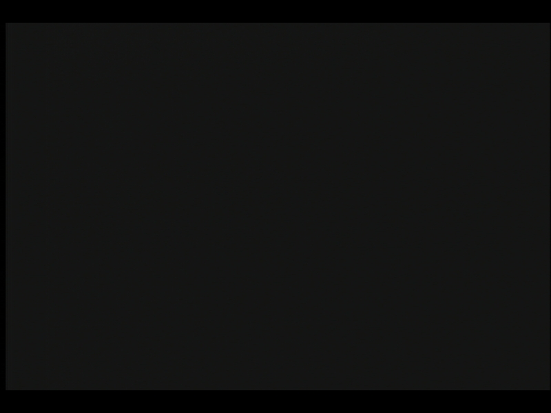

    I've made two screenshots from a raw capture I made. I intentionally set the screenshot it to take a bit larger area than the capture's resolution (720 x 480), so the empty spaces are filled in with a true black-black to show the difference I am speaking about.
    The first is simply a blank output from the laserdisc player in standby, and the second is from a widescreen title - notice how the "black bars" are really gray in screenshot #2, especially compared to the black fill mentioned above:

    Again, please note that the IRE black level was "stepped down" for this capture; if not, it would even be lighter. This was from an American release, although even my Japanese laserdiscs don't quite get down to true black, even when using stepdown (which should not be necessary). I have measured this all on a vectorscope, even though it is pretty obvious on a properly calibrated display.
    Judging by some screenshots I made of test captures several years ago, my CLD-99 has always been like this - but my old CRT monitor was just so dang dark that it wasn't all that noticeable.
    The odd thing is that I had my player serviced by Bayview Electronics (the only remaining Pioneer laserdisc service center I know of in the U.S. ) last summer, and when recently contacting them about the black levels they pretty much brushed it off - mentioning there is an internal "video level" setting in the service mode, which is a pretty complicated thing to get into, but they were "sure everything was fine as they would have noticed it" when it was in for service.
    Additionally, I am seeing whites that appear to be over 255 IRE, so I'm just wondering if this is really "normal" for the CLD-99. I can seem to adequately correct all the levels in post, but I would still like to know if there is any possible issue with the player itself.
    For the record, I get perfect blacks from all of my VCRs and other equipment, so I am 100% my hardware/software is not the issue.
    Thanks in advance for any input, and sorry for bringing up a topic about such an ancient format.

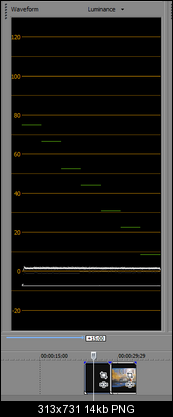

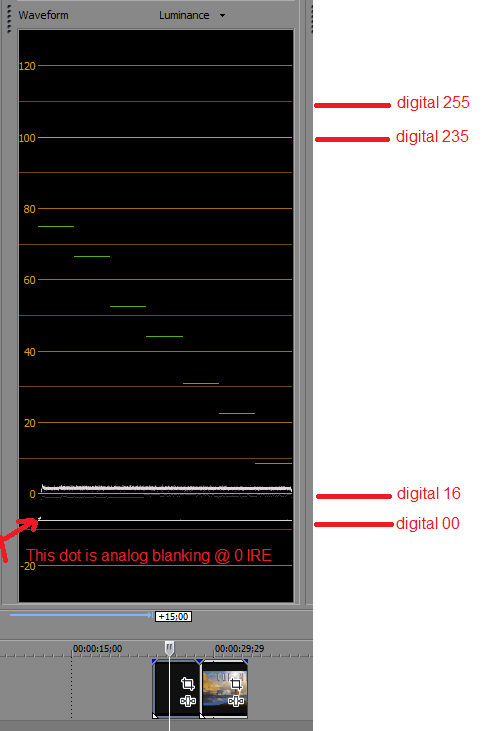

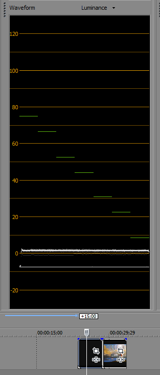

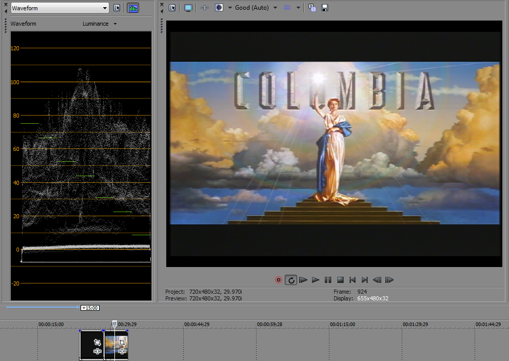

    This the first time I saw this thread so I pulled your screen caps to the Vegas timeline. The black frame shows about +2 % hot black. The "Columbia" slide was similar if you average out the noise. It also was mildly clipping at 108% (digital 255).
    You should be using a color bar from a laserdisc for accurate measurement. Many laserdiscs include color bars. Most LD players will have internal black and gain pots used to set black and white levels.

    Originally Posted by jman98 View Post
    edDV has been pretty adamant that you need to do laserdisc captures from the composite connection instead of S-video. I can't really tell any difference, but again, I'm not that fussy.
    A Laserdisc is native composite. The hardware Y/C separators used on 90's Laserdisc players were inferior to most current capture card Y/C separators (2D/3D comb filters are best).

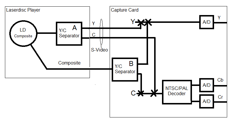

    There will be no difference in levels. The Y/C separator difference shows up as edge crawl and cross color, cross luma artifacts in the picture. What is your capture card?

    Alternately you can fix levels in your editor. However, white clipping cannot be corrected in post.
    NTSC composite video allowed 20% overshoots above white in order to pass maximum chroma. 8bit digital luma clips at +8% (108 IRE). If the disc itself has >108 IRE peaks, you need to adjust gain inside the unit to prevent clipping. Or use a proc-amp between the player and capture card.

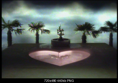

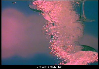

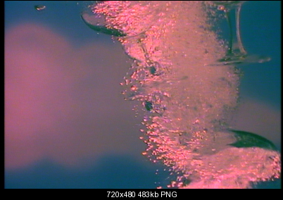

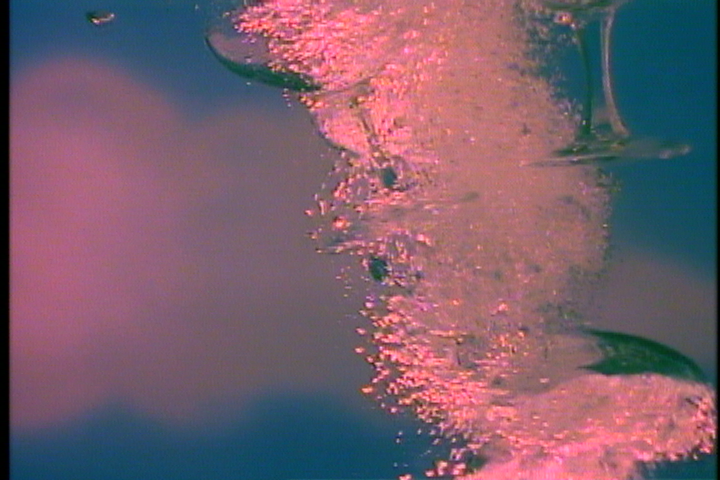

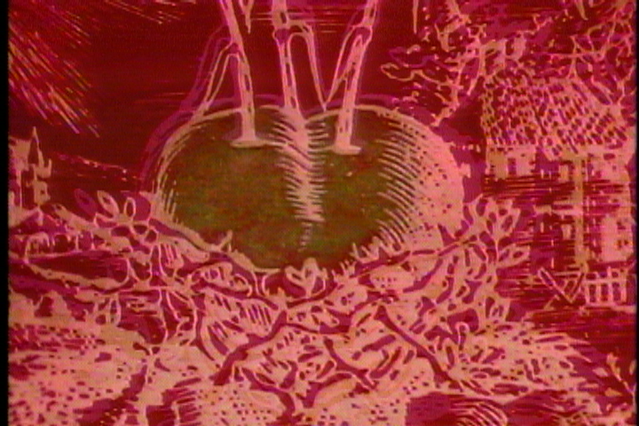

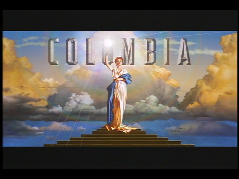

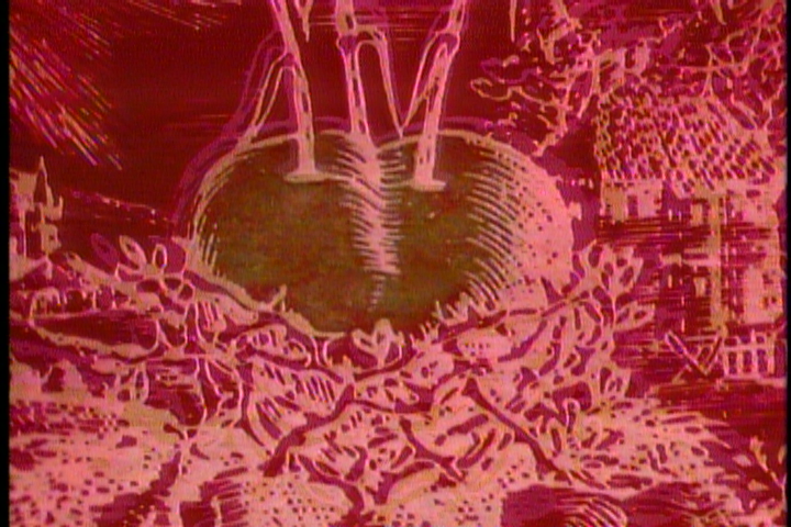

  22. Here is a direct comparison of the composite and S-video outputs of my machine. I would love to hear opinions as to which looks better. I will refrain from mentioning which is which at this point as to eliminate any possible biases. However, all three stills are presented in the same top/bottom order in regards to output:

    The most obvious difference to me is that one output displays a few pixels off center from the other, but in the end it's still centered within the viewable area. I can see a visual difference when flipping back and forth in a photo viewer, but I would hardly say it's anything to go "wow" about...

  24. The 'a' images are cleaner. 'b' has more dot crawl and rainbow artifacts. And oversharpening halos.
  25. In general I think the top one looks better. Both definitely present varying levels of slight noise, but the bottom one creates some unpleasant rainbow effects, as seen in parts of the first image and in that second palm tree
  26. I agree with the two above posts. I don't think it can really be denied that the bottom pics have more issues (notably the palm trees as previously mentioned).
    And I suppose that would make S-video (the top "A" ones) the winner.

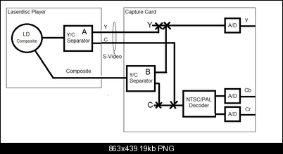

    No it is Y/C separator A vs Y/C separator B. S-video isn't at play.

  28. In other words, the comb filter in your laserdisc player is better than the comb filter in your capture device.
  29. Yes, I know... I never claimed this as some ultimate conclusion. I should have added a disclaimer that it was the "winner for me."
    However, the CLD-99's comb filter is not as bad as it's being made out to be here. I know I have heard that the CLD-97's is very poor by comparison and this was quite an upgrade at the time. Go ahead and knock something for being a decade or so old, but really, how much room for improvement is there really for a technology that is decades old?
    Aside from the black (and white) issues I've been having, which I realize *are* correctable, I think my captures look pretty darn decent. So why should I drop to some other capture card and just "hope" that the composite output somehow magically plays out better? There's almost certainly going to be some kind of trade-off in another way... There always is.
    Anyway, I don't think it's a good idea to say that composite is the only way to go and to tell people this as an absolute matter of fact unless you know and understand exactly what equipment someone is using.
    I was almost to the point of deciding "Oh crap, I'm gonna have to transfer this stuff all over once again." But thankfully I checked for myself!
