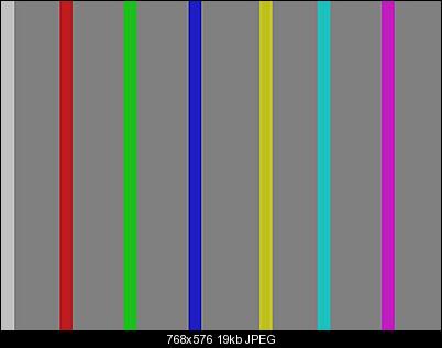

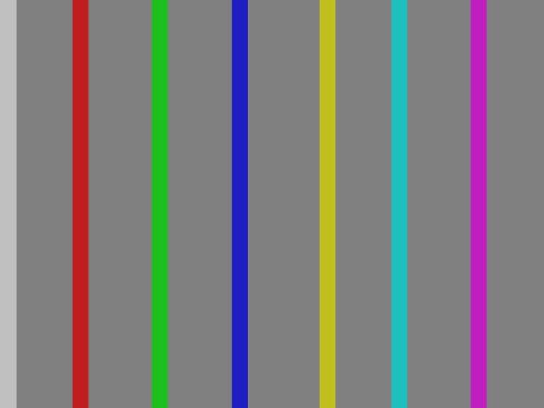

  20. Here are two MPG videos, one encoded 25p the other 25i (50i if you wish). What do you see?
    You should see bars like this, moving right to left. You should see no ghosting*. The 25i clip should have smoother motion.
    * The 25p clip may appear a little ghosted because of persistence of vision and the large-ish motion between frames. But if you pause the video you should see no ghosting.

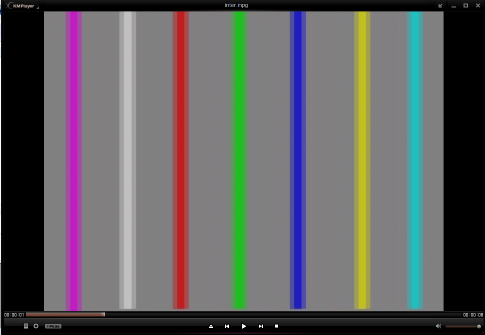

  21. when I play the interlaced one and pause it. the bars are ghosted, not the progressive one.
Name:	inter paused.png

  23. So the ones that were posted, with the bars, does not ghost if I play the progressive rendered version. But if I play a progressive verwsion rendered on my machine, by either Vegas or Adobe Elements, if I pause there is ghosting.

  27. I notice your screenshot in post #21 was taken with kmplayer. Using default settings, it will single rate deinterlace mpeg2 - so it will look choppy (you might call it "flicker"), it also looks to be blend deinterlacing
    Open jagabo's interlaced 50i clip and use smplayer and activate the yadif 2x deinterlacer and it will be much more smoother. (right click, video=> deinterlace=> yadif double framerate). Set it on "repeat" so jagabo's 10sec clip loops. Now change it to yadif (normal) and see the difference . In the first case, it is bob deinterlacing, so you get 50p as a result, in the second it single rate deinteraces to 25p (throws away half the fields).
    On a normal DVD setup, it will bob deinterlace automatically (you will get similar to the smooth double rate results)

    4) While inter.mpg is playing right click on the window and select Filters -> Enhanced Video Renderer (custom presenter). What does it show for the average frame rate? It should show 50, not 25.
    You don't have to keep these settings permanently. These are just tests that use known configurations. Steps 1 makes sure you are using the advanced EVR renderer Windows provides. Step 1 assures you are using MPCHC's internal MPEG 2 reader/splitter and decoder (rather than installed DirectShow filters which may not be working correctly). Step 3 makes sure the MPEG 2 decoder is passing interlace information along to the video renderer. Step 4 verifies the video renderer (graphics card) is bob deinterlacing.
