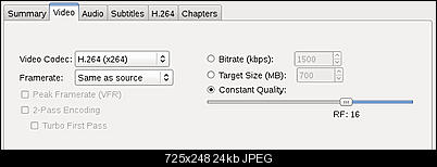

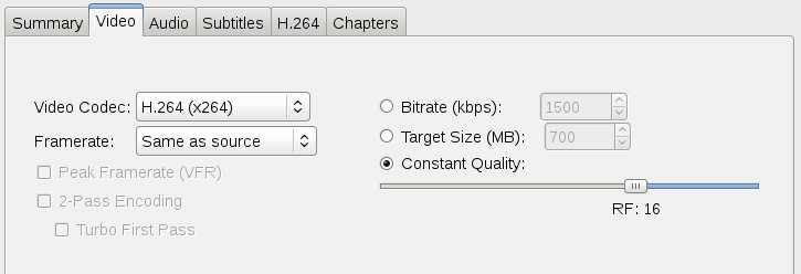

    You can set the CRF with Handbrake under the video tab:
    For h264/x264 video I usually choose CRF 16 which only causes a very slight drop in quality.
