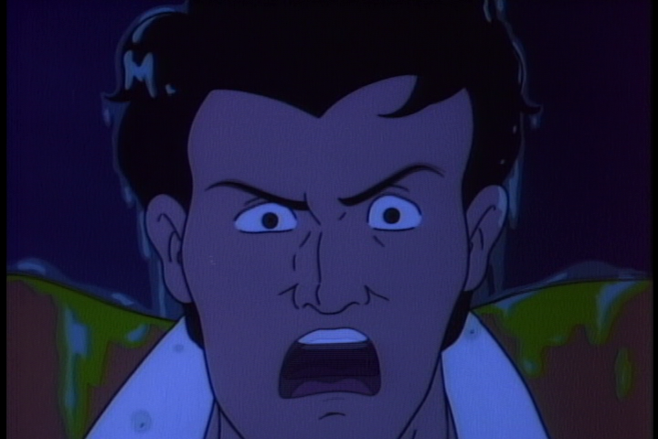

  18. I didn't bother with anything but IVTC and MCTD. And I didn't fine tune anything beyond:
    McTemporalDenoise(settings="high", stabilize=true, deblock=false, sharp=false, enhance=true)
    As I mentioned earlier, the black lines in the dark blanket have disappeared.

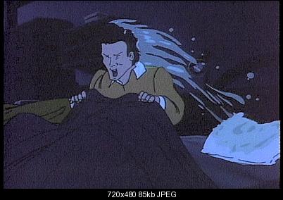

    The source (with gamma stretch to make the blanket more visible):

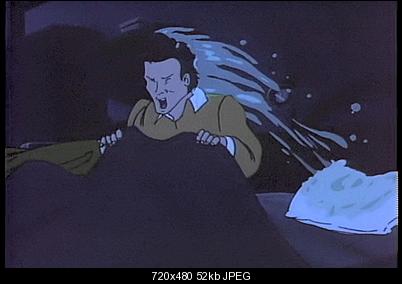

    After MCTD (also with gamma stretch):

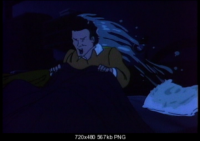

  25. Yes, the images I posted were gamma stretched to bring out dark details. Here's the same frame of the source at the original brightness:

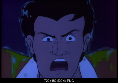

  27. The noise looks to me like an off air recording from a weak signal. And something else:
    The reason this video is particularly difficult is that the vertical line noise doesn't vary from frame to frame. So temporal filters won't get rid of it. Sixteen frames averaged together:
    You need a strong spacial filter to get rid of the vertical lines. But that means you will lose details with similar amplitude.
