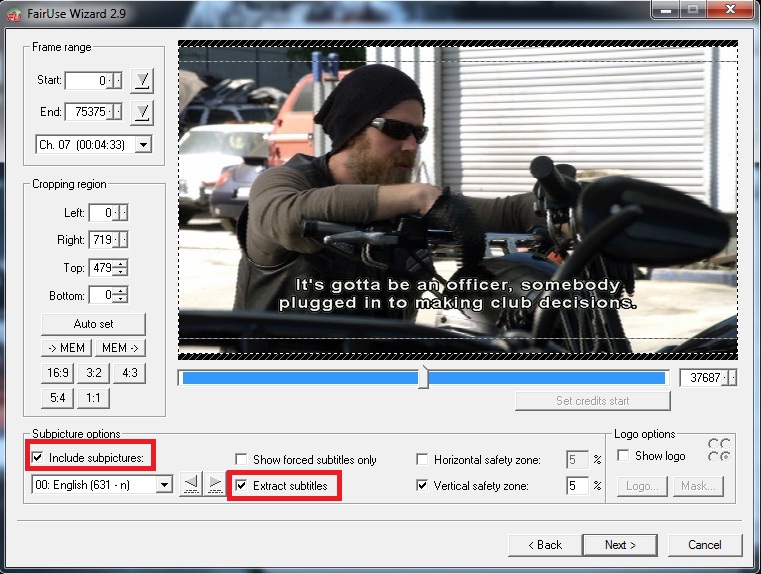

    I have both FU 2.9 & the latest 3D & the setting are the same on both versions.
    You must have both of the options circled in red checked.

    And in the output folder you should basically see these files,
    You need to rename the ".IDX" & ".SUB" file to the same as the video file.
    And you can delete the rest.
    I have been using FU for a loooong time (years) and i have never had any issues extracting subs as long as the original content has subs & not just CC's.

    Hi, thanks for replying.
    I actually figured out what I was doing wrong...about five minutes after posting this question.
    I was not checking the INCLUDE SUBTITLES option. I was only checking the EXTRACT subtitles option. Duh.
    When I began using the program, I thought the INCLUDE SUBTITLES option was for hard-coding. It is...if you do NOT select Extract Subtitles.
