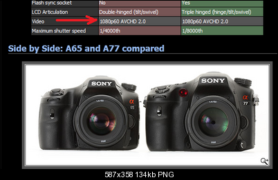

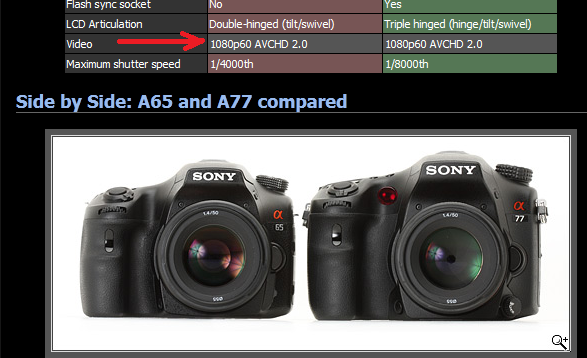

    Most people will buy an edit suite like Sony Vegas Platinum (prices vary US$ 60-99 typ) which handles 1080i60 AVCHD 1.0 format source input to Blu-Ray, DVD and other output. BUT, your Sony alpha SLT-a65 DSLR in 1080p60 mode is shooting AVCHD version 2.0 format which may not be supported yet in most consumer software. Best to call Sony tech suopport to see if the Sony alpha SLT-a65 is supported by the current version of Vegas Movie Studio. Let us know what they say.
Name:	Sony alpha SLT-a65.png
    http://www.dpreview.com/reviews/sonyslta65

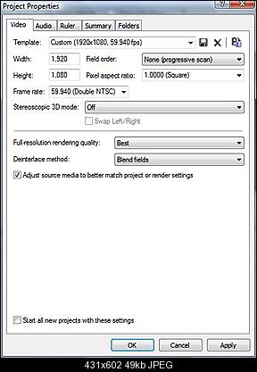

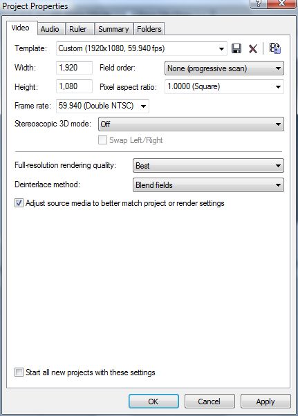

    Hi again, people, I'm back to update the AVCHD 2.0 compatibility to Sony Vegas Movie Studio. I don't get SLT-a65 yet, tomorrow will be. Instead I checked up alternative method which looks up the trial version and see project properties window. File->Properties menu, I got following settings possible. I guess this one could be 1080p 60fps.
    (I'm not familiar with this forum's function, so click to see the picture for bigger resolution, or download uploaded files)
    Well, tomorrow when I get SLT-a65, I will update this thread that time too.
  10. Member edDV's Avatar
    Mar 2004
    Northern California, USA
    That should do it. Project properties should match the source format. On the export side you can save 59.94p for the future but current Version 1 Blu-ray players won't handle it. Alternatives are 1920x1980 60i or 1280x720 60p. Also 720x480 60i for DVD.
