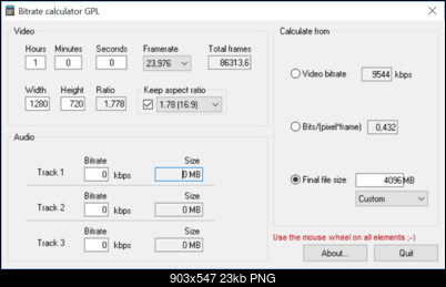

  6. I would like to compress a mkv file to a specific size. For example from 9 GB to 4.2 GB. Can I do that with handbrake?
    I can't find a field where I can insert the specific size of the output file as the principal directive for the compression, or at least have that information present (the size of the output) while adjusting other fields as bitrate or quality.

  7. Originally Posted by Ze Tomes View Post
    You need to calculate the bitrate and to do a 2pass encoding.
    Example:
    - Desired size for video stream: 4 GB
    - Video duration: 3600 seconds
    => 4 / 3600 * 8 * 1024^3 / 1000 = 9544 kbps
    Please note: You also need to consider the size of the audio stream and some overhead for the container
  8. Thanks Fornit, there's any good bitrate calculator you'd suggest?
    true cyber-democracy lies in forums
    some sketches at flickr, tacting ideas at my blog

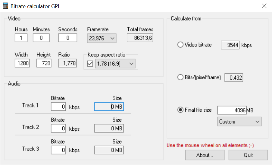

  9. MS Excel
    Or simply click on: bitrate calculator
    It seems to do it's job:
