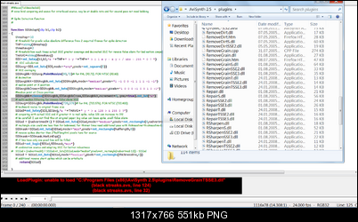

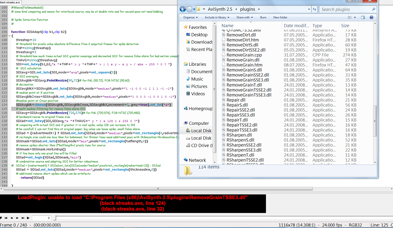

  4. I got some error running script jmac any though
  5. ask yup, or start a new thread under Restoration.
    And you are missing some pluign.
  6. I found it it was the version number of removegraint ( all that versions ) its working now but still it blurs a lot. I tried multiple passes as his suggestion with lower values, and its still very blurry i will try descratch and despot route to see if there is any improvement
