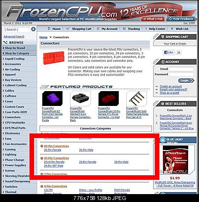

  5. I'm not sure if these are just the plastic shells or the entire connector:
    http://www.frozencpu.com/cat/l1/g51/Connectors.html
    Although, on the 90 degree connectors you can see the pins.

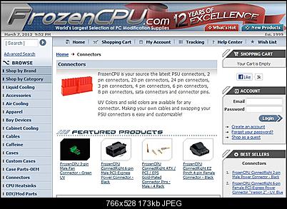

    Maybe i am missing something, but.....
    The only photo/s is see in that link are the connectors that "plug" into the mobo sockets or other equipment, not the plugs that are mounted on the MOBO.

  7. Banned
    Jun 2004
    ®Inside My Avatar™© U.S.
    Now those are definitely different than the first link you posted....
    From what i saw anyway's.....
    But like i said, i am probably missing something....
    It would not be the first time by any means!!!
    LOL!!
    But it say's they are "male" when from the photo's it is obvious they are "female" plugs.

  9. Originally Posted by Noahtuck View Post
    They are linked to further down the page on my first link. Under 20 pin and 24 pin connectors:

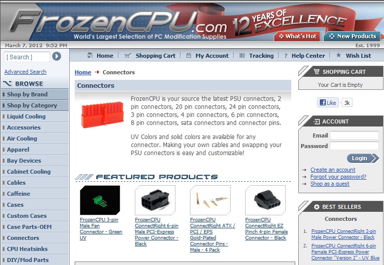

    No. The maleness refers the electrical contacts, not the plastic body.

  13. Originally Posted by Noahtuck View Post
    Usually MALE & FEMALE refer to the socket or plug itself, not the way it is attached to a circuit board.
    It's not the way it's connected to the motherboard. With electronics it always refers to the shape of the electrical contacts, not the shape of the plastic shell. If you look in the connector on the motherboard you will see that there are metal pins sticking up. The cable from the power supply has metal cylinders into which those pins go to make contact. That makes the motherboard connecter male and the PSU connector female, regardless of the shape of the plastic bodies.
