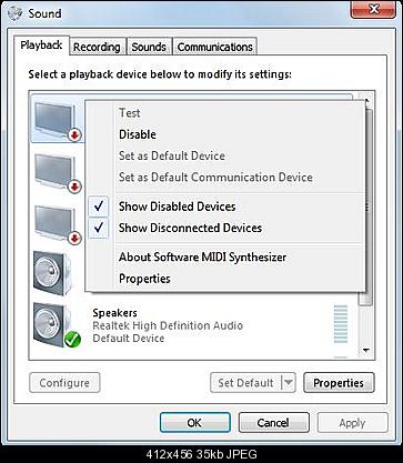

  2. There's a "show disabled devices" option in the audio device controls. Right click in the Window:
    [Attachment 11300 - Click to enlarge]
    Thanks for your answer though, the "show disabled devices" is already ticked, and it still shows the same result, and yes it's still plug in on the tv

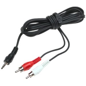

  8. Just to be sure, you're using a cable like this to connect the computer to the TV?
    http://www.amazon.com/Belkin-Audio-Cable-Splitter-1-Mini/dp/B00004Z5CP/
    [Attachment 11305 - Click to enlarge]
    I am using a cable that it's exactly like that though its a different brand, is that alright? The details of the box (where the cable came from) says

  13. Originally Posted by syboz View Post
    Yeah, that's fine. As you now know since you got the problem sorted out.
