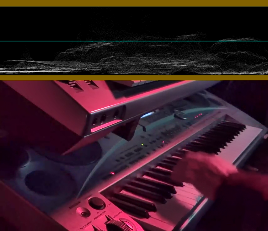

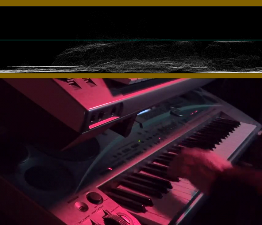

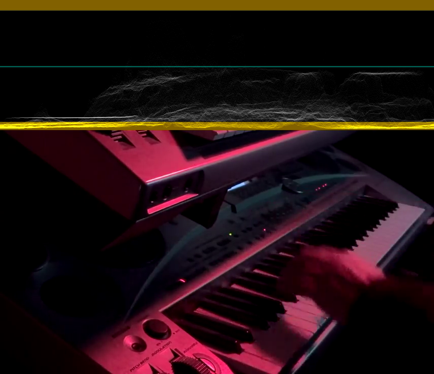

  18. Originally Posted by callmebc View Post
    FYI -- this is the final result of my test video:
    I think you could improve the levels, you're leaving a significant amount of detail in the "superdark" region (Y' <16) which will get clipped when viewed on youtube. This is usuable data that your camera is recording, but you are essentially throwing away (it's there , but just not being "seen")
    The lower "brown" area in the waveform tracing represents Y' 0-15 and data in that area will not be visible when viewed on youtube (or any calibrated display) - everything in that region will appear as 1 "shade" of black
    You can choose to brighten up the shadows a bit as well, but usually that will reveal some noise, so you would usually have to add in some denoising filters
