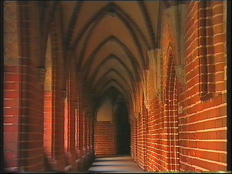

    i'm hoping someone can shed some light on this problem. i'm digitizing a bunch of VHS tapes and all files end up with a border. top, left, and right don't bother me so much as they are just dark (not quite black), but the bottom looks like a mumble jumble of the frame itself squished across a few pixels which i find quite distracting (see attached frame). this happens on both PAL and NTSC tapes.
    any idea where that comes from and what to do? it's not problem for my editor (final cut pro) to crop that, but then i would probably disturb the frame size when i render out, so i'm not sure if that's a good idea.
    thanks for any insights,
    stefan

  2. All of that is normal. The junk at the bottom is head switching noise. You always get that with VHS tape. The black borders at the left and right are there because the card captures a picture wider than the normal broadcast signal to assure the entire picture is captured even if the signal is slightly off center. You don't see those features on TV because TV's overscan the image. Ie, they are covered by the bezel on the TV.
    The only thing you should do is cover them with solid black, especially the head switching noise . So they don't eat up bitrate on the DVD.

    How did you capture that image ? Surley it should be 720*576 pixels ?
    Other than jagabo's suggestion, if you consider cropping the image to remove either the vertical black and/or the horizontal noise you may well have to de-interlace the video first else you could destroy the video completely.
    Best to leave alone and let the tv overscan take care of it.
  4. Yup, as everyone else mentioned -- there is nothing wrong with your equipment or capturing process, the head switching noise is totally normal.
    Definitely do not crop your footage to get rid of the uneven black bars or head switching noise at the bottom. You should use only potentially non-destructive practices to deal with it.
    If you plan to watch it on a TV, you are unlikely to see any of it, as it will more than likely fall within your televisions overscan area. Some TVs will let you adjust the amount of this area too, in case your TV does show it. Check your users manual.
    If you're planning on watching on computer monitor in full screen mode, the noise will show up, as monitors don't have an overscan. Some programs (like VLC Player) will allow you to generate a custom mask in real-time on playback, which is the best of both worlds -- you don't have to re-encode your footage and you can enjoy it a computer minus the bars/noise.
    If that isn't our preference, mask it in software (i.e. cover the offending areas with a solid black border). You can do it easily in VirtualDub (Mpeg2/Mod) with the 'Fill' filter. Note that will still require a re-encode (i.e. you'll lose some quality, how much depends on the methods and encoder you use).
    Another way to handle it is to create a mask using a subtitle, which I thought was pretty clever and cool, as you don't have to re-encode the footage:
    https://forum.videohelp.com/threads/343940-Resolved-Use-Subtitle-to-Create-Border-on-DV...ut-Re-encoding
    There are many ways to skin a can, as they say!
