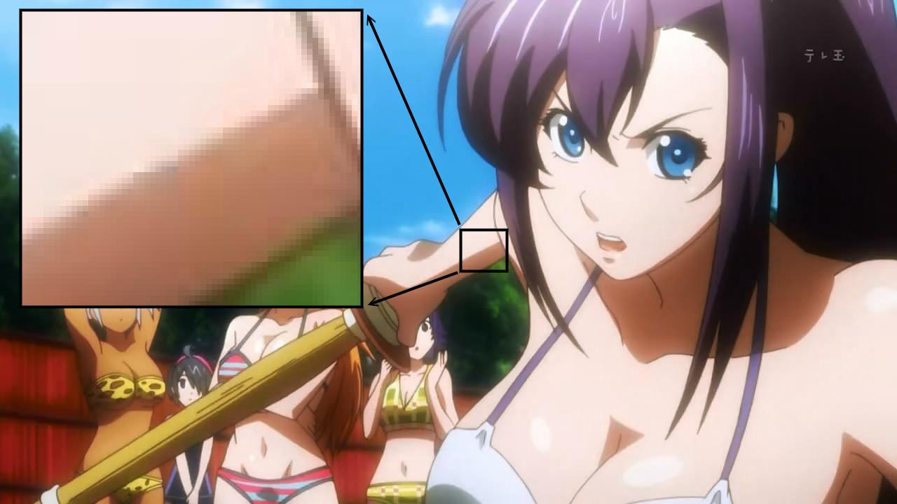

    that's a photo example of a 10bit H.264 from the anime Maken-Ki on ONS team's site, to be honest it's still quite decent so I guess bitrate wouldn't really affect much.
    Different videos require different amounts of bitrate to maintain quality. As I said before, anime has little detail, little noise, and lots of static shots -- all things that make it more compressible.

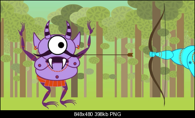

    source:
    At 270 kbps is is showing significant degradation. Note the loss of details in the small trees, the smearing of details in the larger trees, the rough edges:

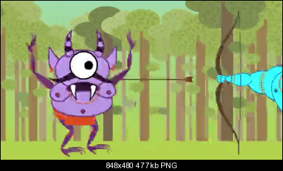

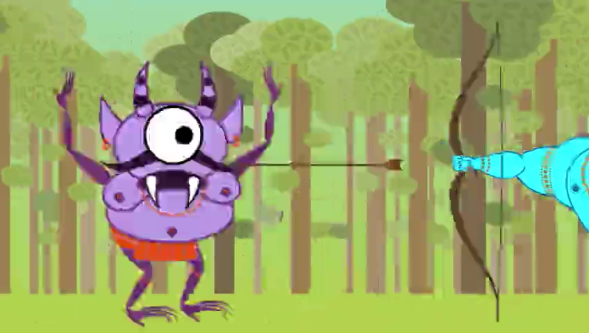

    At 150 kbps it's much worse:
    Those are the types of problems you see with animated material and too low bitrates. Don't take those images to mean that every video at 270 kbps is going to look that bad or good. Every video is different and will require a different bitrate. And different frames will show different amounts of problems.

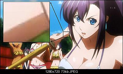

  22. Originally Posted by Deadly9000 View Post
    There are no signs of rough edges however.
    There are lots in the sample image you posted:
    Though I can't say for sure if they were in the original video, created by the low bitrate of your encoding, or created by the JPEG compression of the image you loaded.

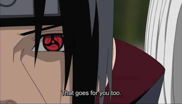

    @Cornucopia, I'm not really that dumb, it's like transposing a shitty JPG picture to a PNG format, wouldn't matter, what matters is degrading or keeping same quality, it's quite logic, so no need to round that up. No idea why you even mentioned it although I never mentioned original files weren't 10bit?
    And thanks for the support guys, I did some videos, that's the only one uploaded so far, if any of you would want to try&download it http://www.mediafire.com/?uv5um8952jm2hw7
    It's a Naruto Shippudden episode. I think the quality's still quite good for a compressed file.
    For those that are lazy, here's a screenshot.
    Yes Itachi is l3 b4d4ss. Normally I don't play videos at full screen because I'd be on MSN while watching, so I used the only useful thing in windows 7, which is the screen divider(when you put a certain window to the far left or far right it takes exactly half of your screen) that's what I did to my video when I took a screenshot
