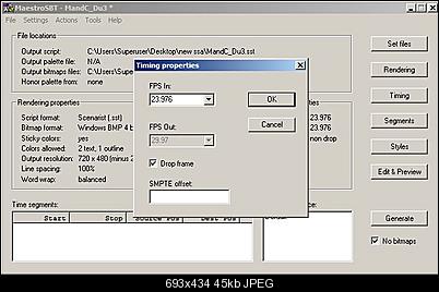

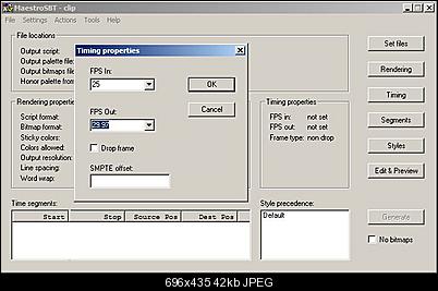

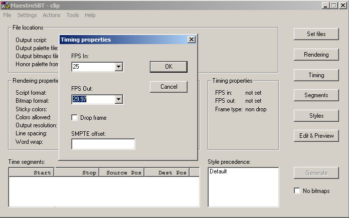

    Before I start this project, I'd like to ask a general question about creating subtitles for an NTSC DVD (Master and Commander) from a 25fps .ssa file (using MaestroSBT).
    In the 'Timing' setting I can elect 25.00 in and 29.97 out.
    There is also a setting for 'Drop frame'.
    Do I assume that since the DVD is 29.97 that it uses drop frame and output the applicable .sst file to use as input for MuxMan or is it a case of try one and if the timing of the subs is out, try the other.

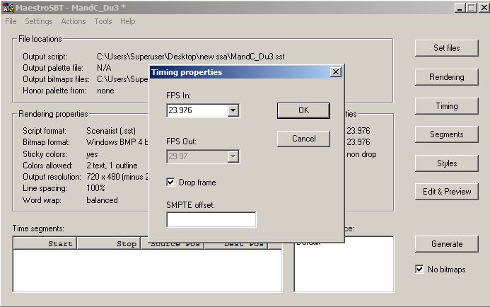

    Dec 2005
    Canada
    The time difference was the same for the start and end subtitles.
    I used Subtitle Workshop to adjust the ssa file and generated a new sst file for muxman.
    Found the time was still off, so I demuxed the closed captions and used it's settings for the first and last instead of guessing.
    The result was better and after the colors were touched up with DVDSubEdit the movie was much easier to watch.
    I didn't get anywhere using Drop_Frame, as soon as the box is checked it sets at 29.97 and the times are way off.
    Thanks again for the helpful hints.
  10. Originally Posted by sambat View Post
    Set both the In and the Out for 29.97. It's the same thing - the input framerate is the same as the output framerate.

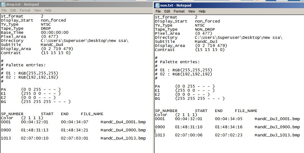

    Dec 2005
    Canada
    Basically no difference in the times.
    [Attachment 11277 - Click to enlarge]
