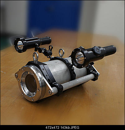

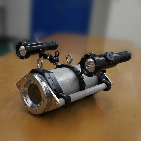

    A deep water camcorder housing.

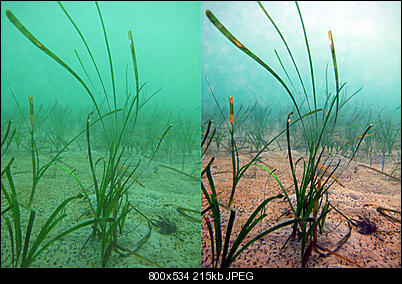

    3) Do you have experience with video enhancement to address the backscatter issue? We have certainly seen the benefits of simple Photoshop enhancement in still images (see image below). Increasing the contrast would certainly aid video classification. The image below is perhaps not the best example because the water is pretty clear, but you get the idea. We recently learned of hardware designed to perform video enhancement (www. lyyn.com ) and are now interested in looking at enhancement options. We currently now collect video in standard definition with an NTSC camera and are thinking that some form of enhancment might be more powerful than a move to HD.
    Once again, any thoughts would be greatly appreciated.
