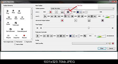

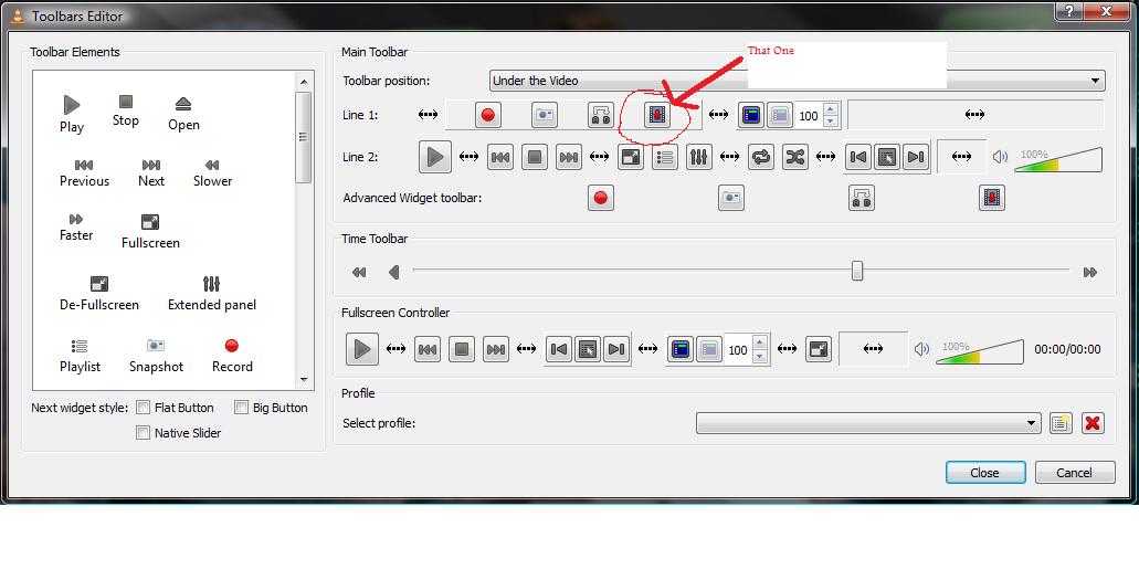

    Step through the video frame by frame.
    VLC using frame advance tool...
    This one

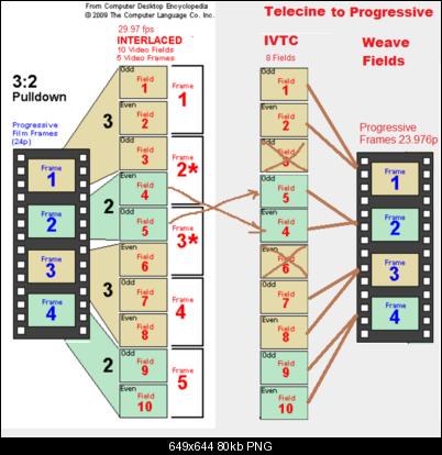

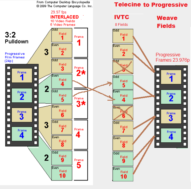

    If the video is hard telecine (typical for TV movies or dramas) then the "Detelecine" filter will remove the repeat fields leaving 23.976 fps progressive video in the h.264 file.
    Sports, talk shows, reality/variety shows and news are typically 29.97* fps interlace.

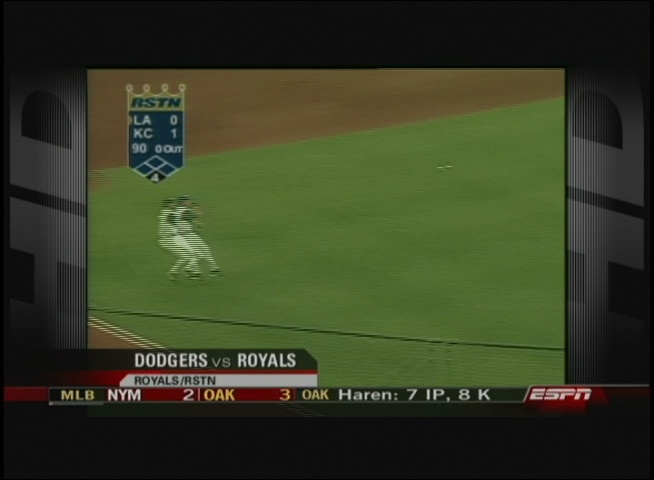

    * 720p will be 59.94 progressive for all content.

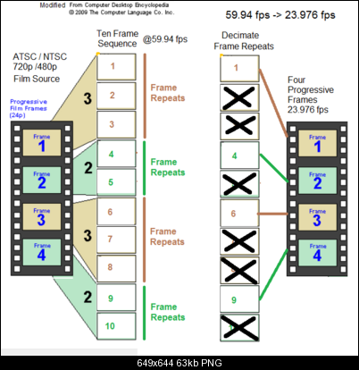

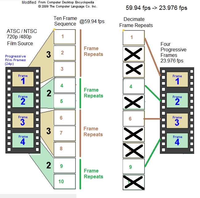

    Here is how ATSC / NTSC 480p/720p film source is broadcast* and decoded.
    * Direct broadcast of 23.976 fps film source is allowed under ATSC but is not currently being done.

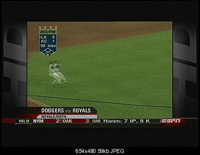

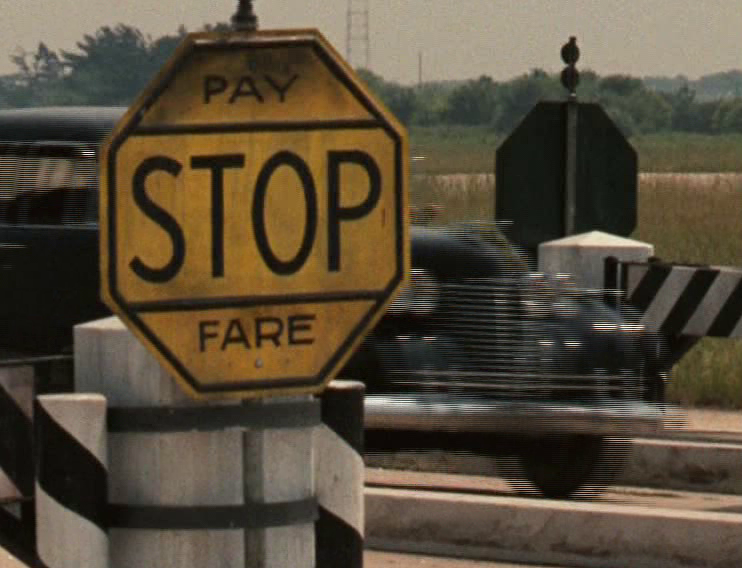

    No, your source was 29.97 fps with hard telecine. The x264 encoder used in Handbrake cannot handle interlace video. Unfiltered it will simply weave telecine fields to make 29.97p frames. The result will be three clear frames followed by two mixed frames with even/odd lines from different source frames.

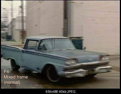

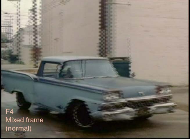

    Example for fixed camera

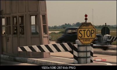

    Example for panning camera. Note the double vision.
    If you use the Detelecine filter, you get 4 clear frames at 23.976 fps.

    720p/480p source is handled differently as well but that is a separate issue.

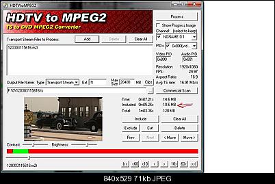

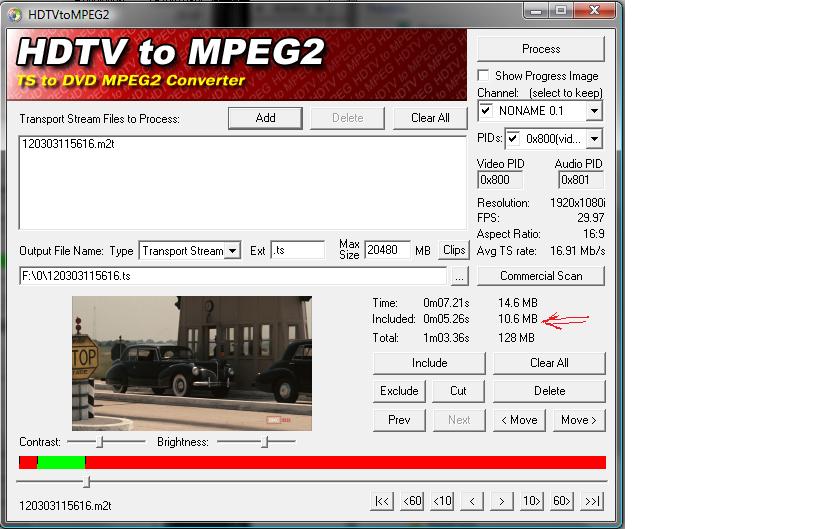

  24. Member edDV's Avatar
    Mar 2004
    Northern California, USA
    With an editor. Here is a simple one to edit transport streams at the GOP level.
    HDTVtoMPeg2
    Cut out a short action clip (30MB max) and post here. Save as *.TS
    You didn't mention your capture method.
    I used the VLC frame by frame advance button to step through the clip. For hard telecine you will see three progressive frames followed by two mixed frames such as this one.
    Cropped
