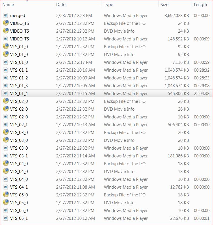

    Can you open the video_ts folder in Windows Explorer, turn on details view, make sure the size column is visible.
    Take a screen shot and post it here.
    Feb 2012
    indiana
    okClick image for larger version
Name:	video ts grab 1.JPG

    You should turn off the windows option "hide extensions for known file types" (at least that was what it was called in
    XP. You'll find it in control panel folder options).
    I suspect the problem occurred during the rip, try re-ripping with DVDfab decrypter.
    https://www.videohelp.com/tools/DVDFab-Decrypter
    I have no other suggestions for dealing with the damaged file.

    this disc probably uses fake VTS and your ripper is not dealing with it properly.
  11. I'm a MEGA Super Moderator Baldrick's Avatar
    You can try run fixvts on the video_ts folder.
    Or else rerip.
  12. I'd also first try running it through FixVTS. If that doesn't work I'd next try demuxing the video, audio, cells, subs (if any) using PGCDemux, reauthoring it (Muxman) and then, assuming everything's OK after that, replacing the original with the reauthored one (VobBlanker).

    Well alrighty then! It lloks like the fixvts was the ticket! I just successfully burned myself a DVD of the video_ts folder. I ran the vob files through the fixvts and it seemed to find about 25 different spots that it was saying were bad or something? Not sure what all that meant, but when it was done, I removed the backup folder from the video_ts folder and tried to burn the DVD again. It was successful, and I can fast forward, reverse, and use all of the bonus features and everything. That is just the shiznit boys. I sincerely thank every one of you for your help in this matter. I am definitely going to be reading up in this forum for help on demuxing and authoring and all that jazz, haha. remember, I am a complete and total newb at this DVD thing. It sure is a different animal than Burning CD's isn't it?
