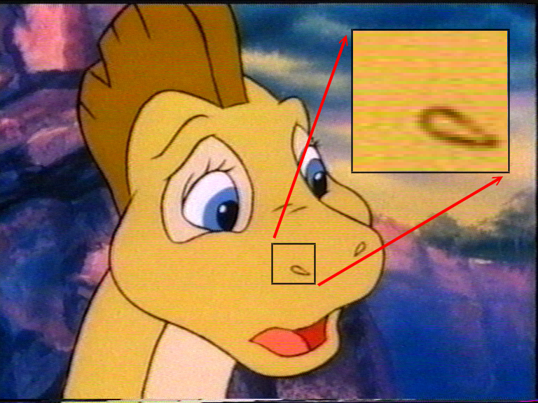

    [Attachment 11186 - Click to enlarge]
    No. I meant on my own captures.

    The card filtered them out. You're stressing about this way too much. Just use one of the filters we've already discussed. A 50:50 mix of pairs of lines may be more technically accurate but it's not visually superior to blur, resize, etc.

  29. Check the Text, itīs most apparant there, see that itīs Red then Green, and it "rolls" one line upp every frame.
