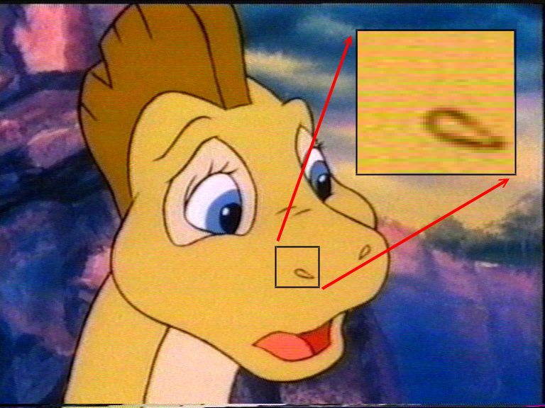

  1. What cards do you use?
    Can you post samples?
    I am on the look out to solve my current problem, which is that my card doesnīt Fully support PAL.
    I get Green/Red Chroma lines all over the place thanks to that.
    As the Title says, Uncompressed is a must, i donīt want H264 or something, sure it can have the feature, but i want to be able to capture with Virtualdub and use the codec i want to use.
    If someone has a card that supports both NTSC and PAL (which many do). If you can try PAL, please do, it can be Game Console, DVD, VCR - S-video/Composite, doesnīt really matter, itīs the PAL signal that do.

  3. https://forum.videohelp.com/attachments/7548-1308910457/Dink.avi
    https://forum.videohelp.com/attachments/7565-1308979610/Dunno.avi
    https://forum.videohelp.com/attachments/7248-1307430626/lines.avi
    There are examples in which i get Red/Green lines.
    My capture card is, MSI TV@nywhere Conexant (something), can probably look up.
    Can probably Guarantee that itīs the Card, as i have tried 2 VCR + DVD, and N64,PS2 and Xbox.
    All which had the same problems with PAL as those clips above (itīs more apperant on consoles as there is less noise to hide it).
    I got Harddrive space, but donīt want to be forced to capture uncompressed(totally uncompressed).
    I used Lagarith and UT Video Codec.
    But it appears when i play or watch through Virtualdub as well.
    Itīs Extremely apparent on Light Blue, Yellow and Red Surfaces.
  4. As I understand it now, those are Hanover Bars. You can get rid of them (mostly) with:
     MergeChroma(last, BilinearResize(width,height/2).BilinearResize(width,height))
    There's a VirtualDub filter called rmpal that's supposed to fix this too.

  5. Yeah i know, and use the filters in a script.
    But i would like to be able to capture without getting the chroma to totally fail, as i mean, it canīt be good at all.
    Even if you can blur them away, there will be loss of detail in the chroma right?
    EDIT:
    Read about the Hanover Bars now a bit. But donīt get it, is it supposed to be like that or is the Decoder supposed to solve it?
    As it said, some just take the lines from the previous frame and blur with the current (like the script i guess). While other used some kind of swift burst.
    I guess the later solves the need of blurring and use the entire chroma resolution, and as i understand it, itīs the Card thatīs suppose to do that.
    My card doesnīt even have PAL60, so itīs probably Old and probably just decode it with no correction at all.
    So i guess newer cards will solve it?
    Though the card i tried before (Aver Media) had the problem as well, though it totally failed on VCR capture thanks to itīs bad handling with the bad timings.

  12. Originally Posted by zerowalker View Post
    Wait so in the end you just blur the lines?
    Yes, but only the chroma. There is no loss of sharpness in the luma. I think this will work better:
    MergeChroma(last, SeparateFields(last).BilinearResize(width,height/4).BilinearResize(width,height/2).Weave())
    There may be a better way around this but I don't yet well enough understand how the PAL chroma works. Do you have any clean (without field blending artifacts) clips?

  18. Originally Posted by zerowalker View Post
    But what is the idea, is it supposed to just Ignore every other Chroma Line?
    No, the idea is that the average of the two lines is the correct value to display for both lines. In old fashioned TVs they relied on the human eye to blur the colors together (viewed from far away you can't resolve the hanover bars). Newer TVs added an explicit blur function to blur the chroma from pairs of lines together, and display those colors for both scan lines. Having two signals with opposite phase shifts is supposed to help keep the colors right (though I don't understand exactly how at this point). A problem that creates an positive error in one creates a negative error in the other -- so the errors cancel each other out.

  20. Originally Posted by zerowalker View Post
    But so in the end you just need to blur it;S?
    Yes. But...
    And why do you need to resize with Billinear, isnīt there a way so choose every other line more efficiently?
    It's supposed to be done by simply averaging the two. But I don't know of any filter in AviSynth that does that. So I used Bilinear as that's the closest approximation. Mabye Bilinear for downsizing and Bicubic for upsizing will work ok. Ie, won't create oversharpening artifacts.
    Averaging the two doesn't really blur the colors. They are the same color to start with. For example:
    100 and 100 averaged together is 100. If each has an opposite phase shift: 100+10 and 100-10, and you average them together the result is still 100 ((110 + 90) / 2). So the blurring happens at the transmission, not at the capture/display. This is similar to the 4:2:0 chroma subsampling used in MPEG family codecs. Just in the analog domain, not digital.

    The reduction of vertical color resolution happens before the transmission. The hanover bars are in the PAL signal. That's why you see them in all analog PAL caps.
