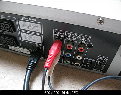

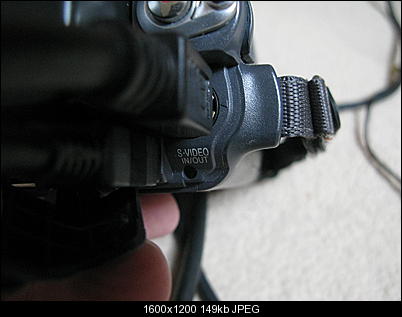

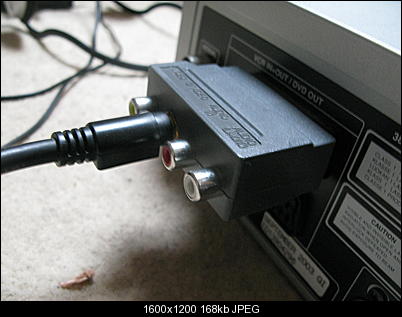

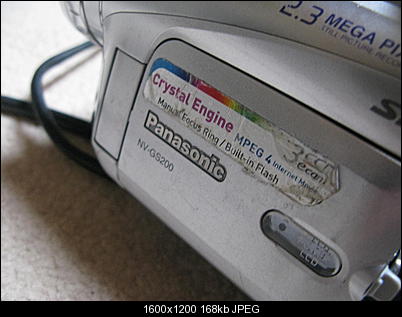

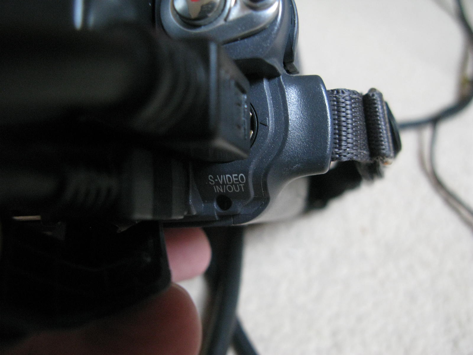

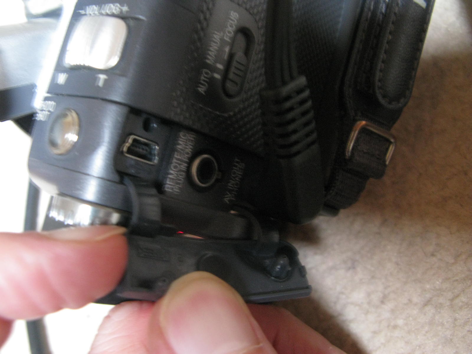

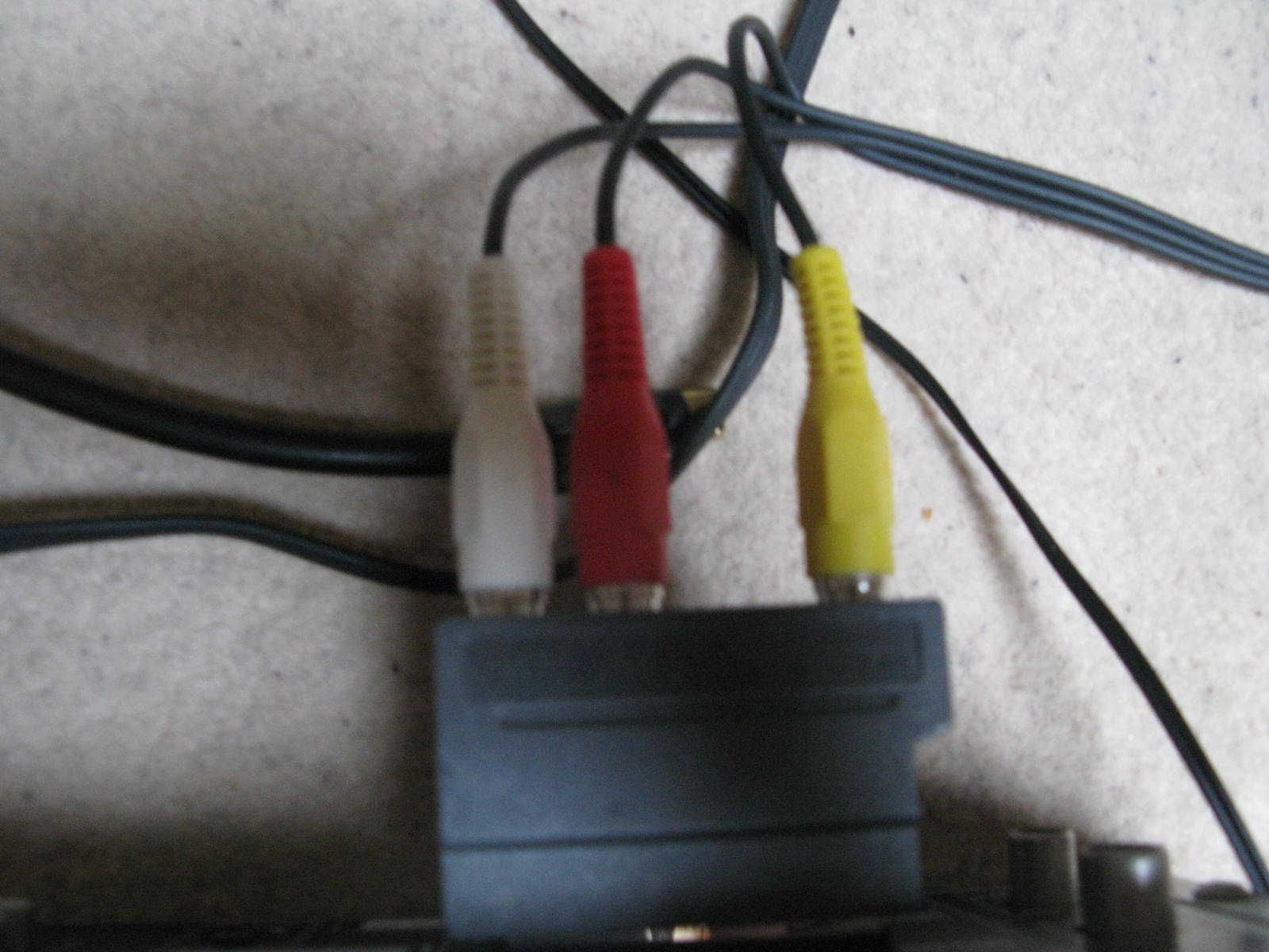

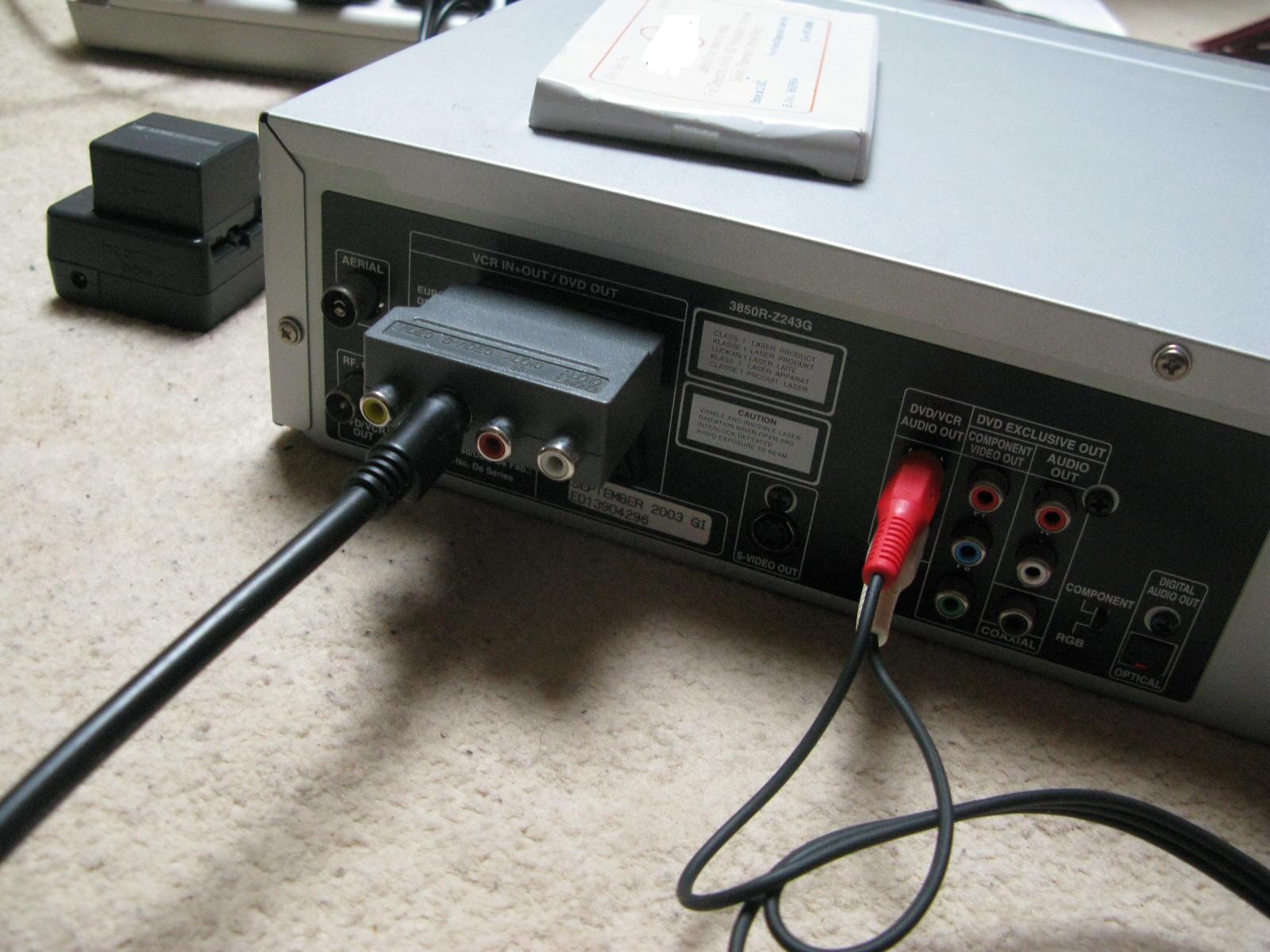

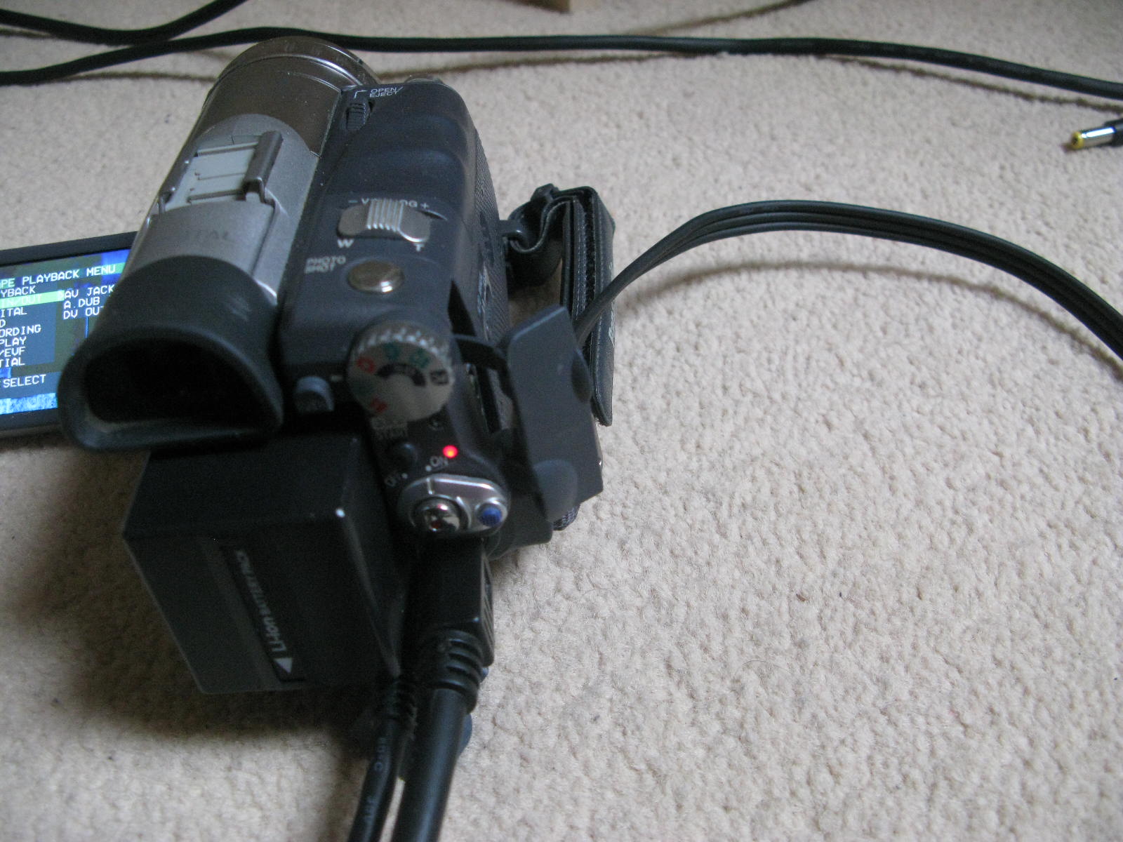

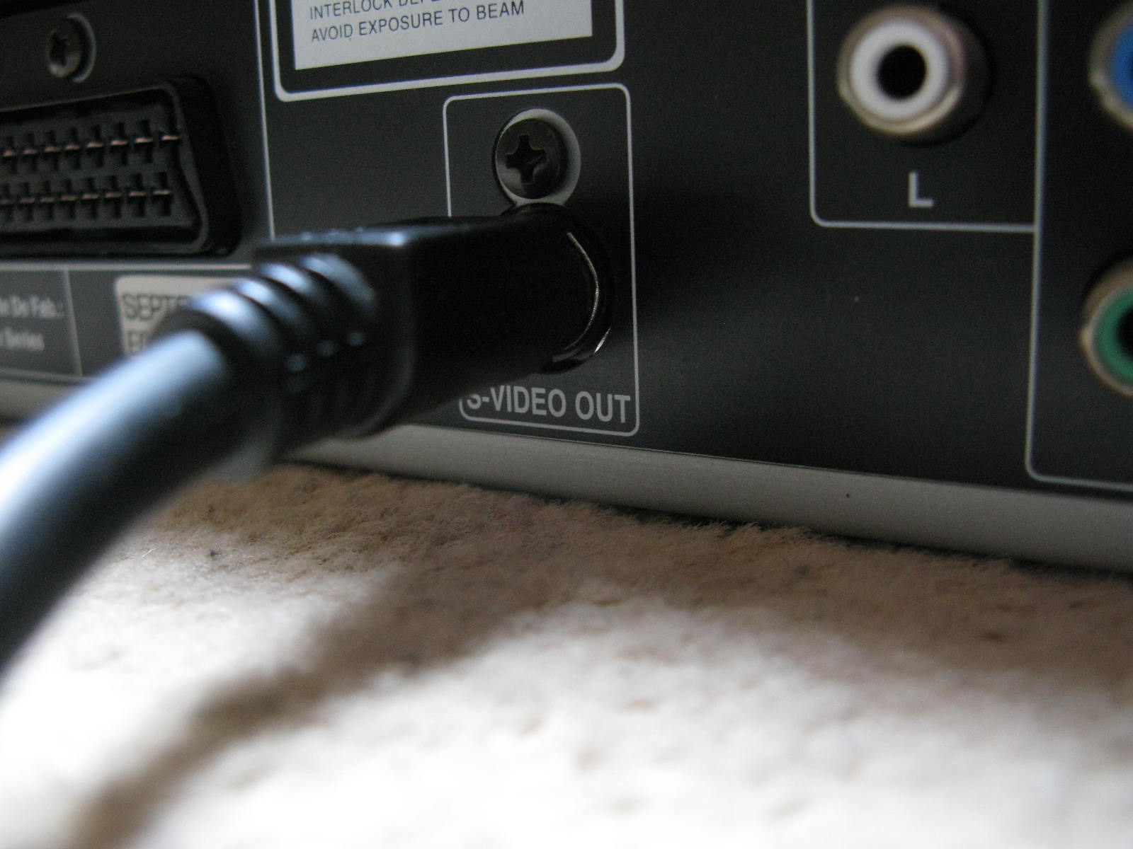

    I’m trying to capture some vhs videos of weddings holidays from my VCR to Camcorder (pass-thru method) to PC (via Firewire). I first tried the S video connection on VCR to DVC and even though the tape is playing there is no sound and the picture is stuck on the VCR menu screen.

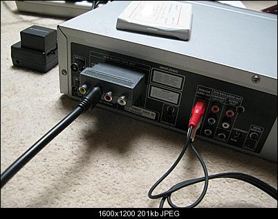

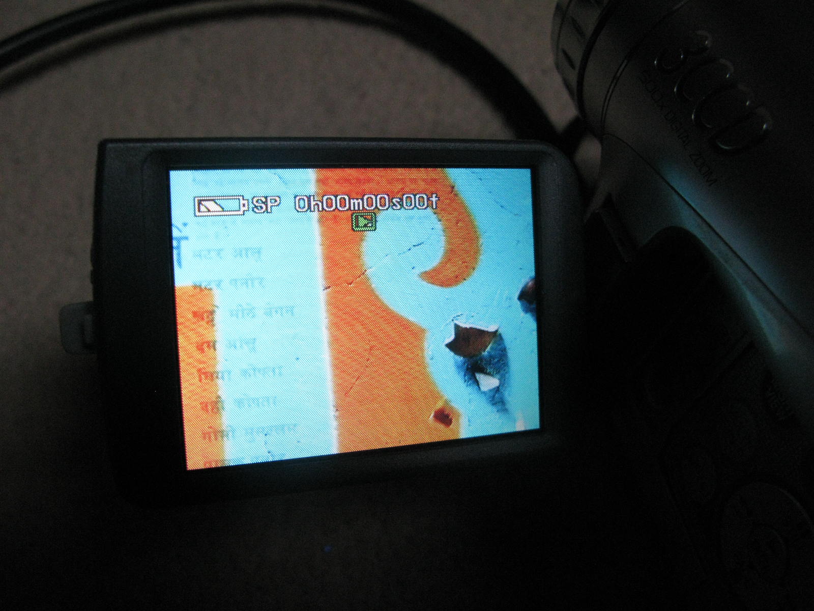

    I then tried S video connection through Scart RGB and the video plays but its in black & white with the occasional splash of colour for about half a second and there is no sound just a loud hum, and there is a see-thru mesh like pattern which is visible on the captured Scart S video during playback.

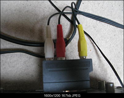

    I then tried composite and that works, could it be a damaged S video cable or something else

    Straight S Video to S Video connection (no sound stuck on menu mode while VCR tape plays)

Name:	svideo connection.JPG

    Composite connection (works)

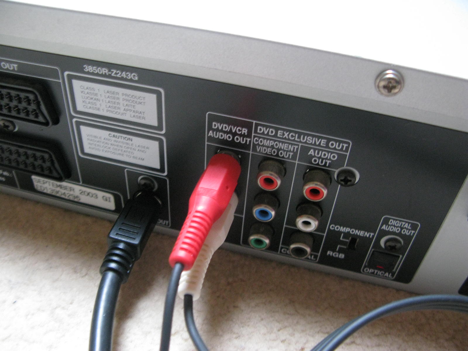

  2. S-Video carries only the video, so you'll still need to hook up the red and white audio cables.

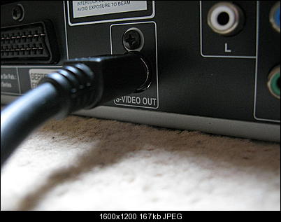

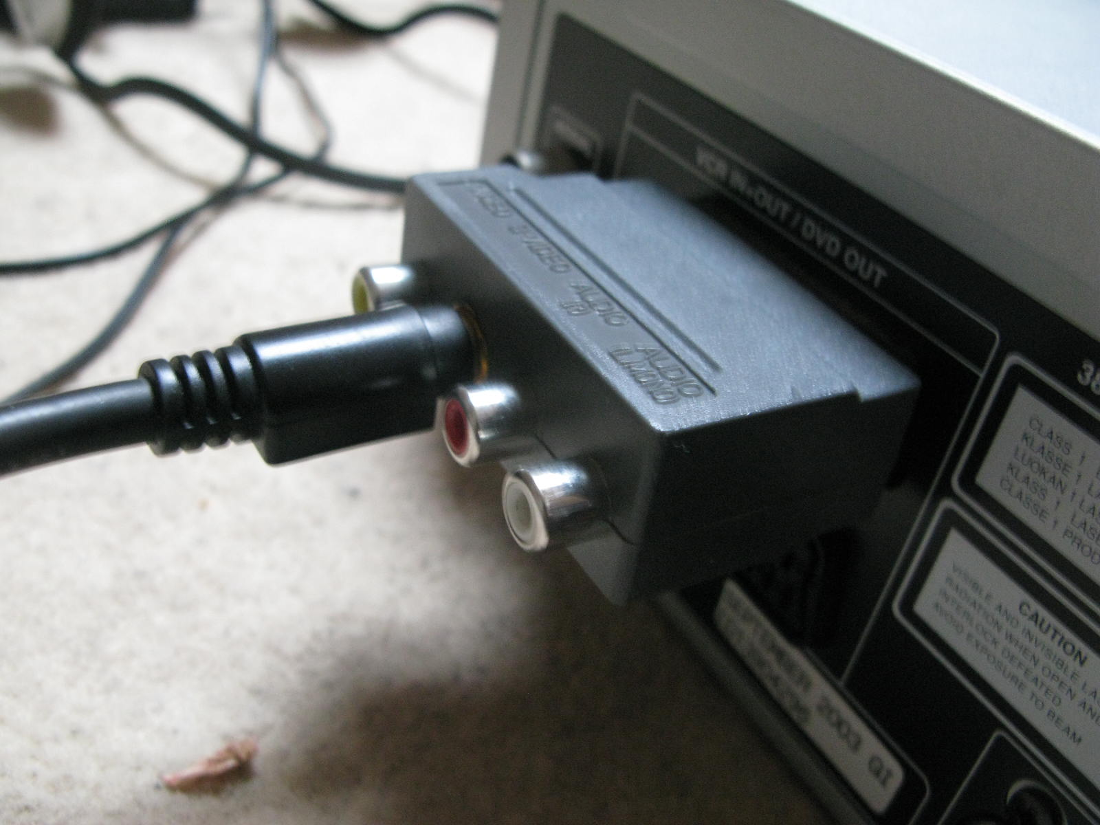

    A SCART output on a VCR(or any other device for that matter) isn't always wired to output S-Video. Just because that adapter you stuck in there has an S-Video connection does not mean you will get one. Been There - Done That.
    Aug 2007
    France
    1) Video : Connect straight your DVD player S-Video output to your DVC S-Video input with the S-Video cable
    2) Audio : Connect the DVD audio output (the red and the white cables from SCART out adapter or RCA Cinch on the rear panel) to your DVC audio input headphone socket

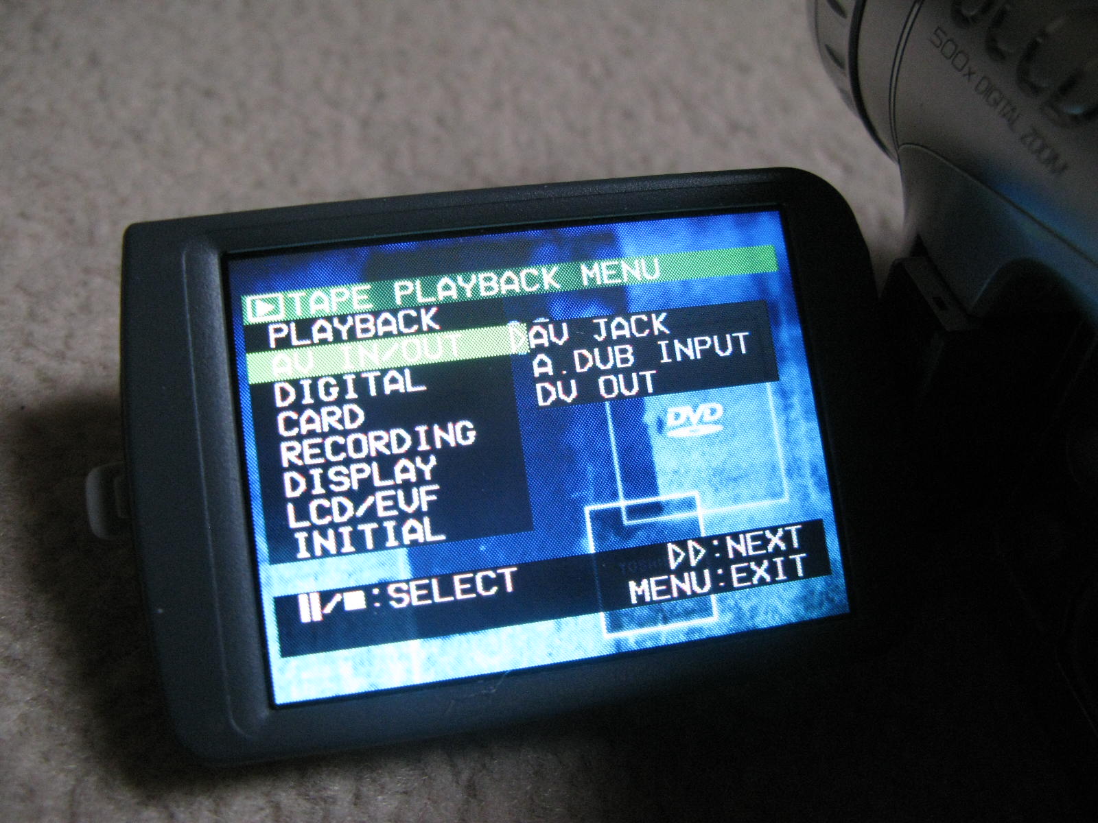

    3) Maybe you may enter into your DVC Video input menu : some DVC need to know if they are fed with S-Video or Composite Video !!!
    4) DVD Player : sometimes, the output signal may be set with "AUTO" and it can be also set with "NTSC" or "PAL" !!!

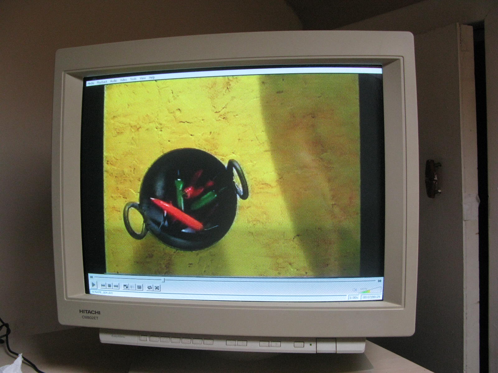

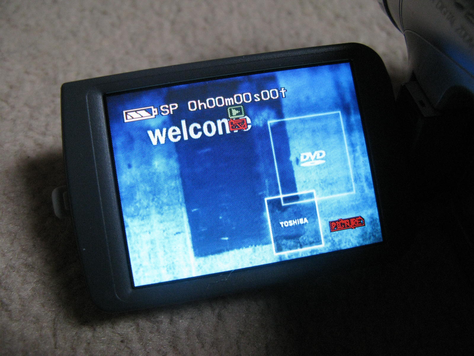

    Many thanks to all your response, I used the methods that you describe as I did’nt know that Svideo only carried video not audio.

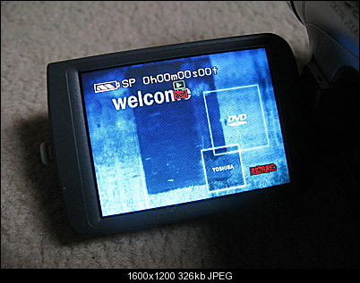

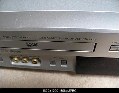

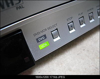

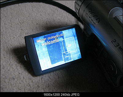

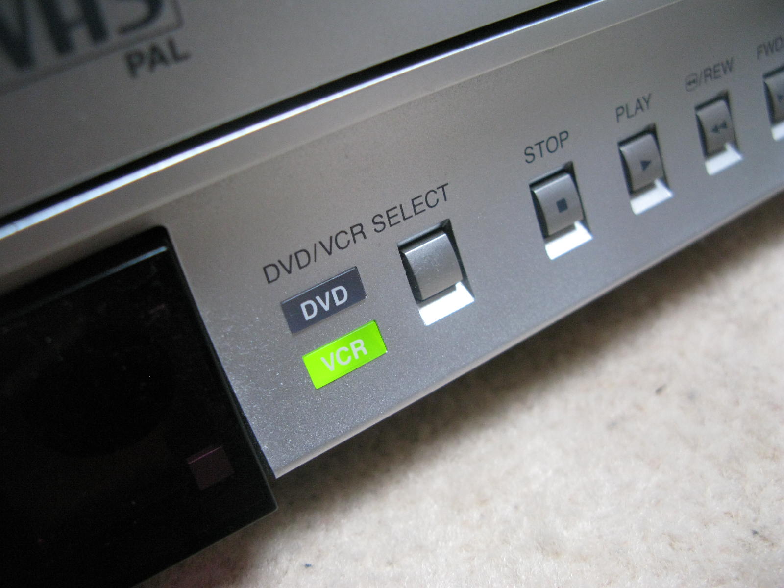

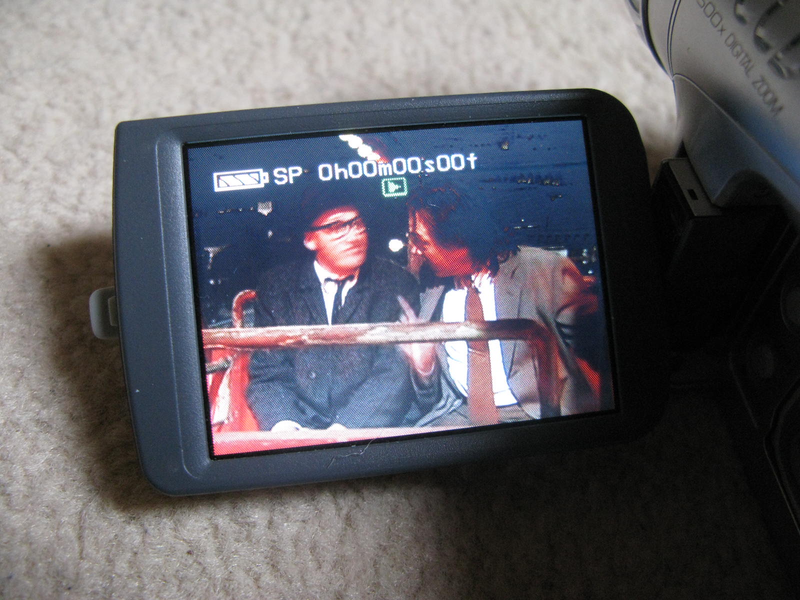

    I’m assuming that this VCR/DVD Combi will not output a S video signal in VCR mode all I get is a display of the home screen I can hear VCR tape playing sound (voices etc) .
    But if I switch to DVD Mode and put a DVD in , it plays

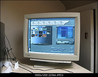

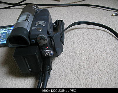

    Svideo connected to DC

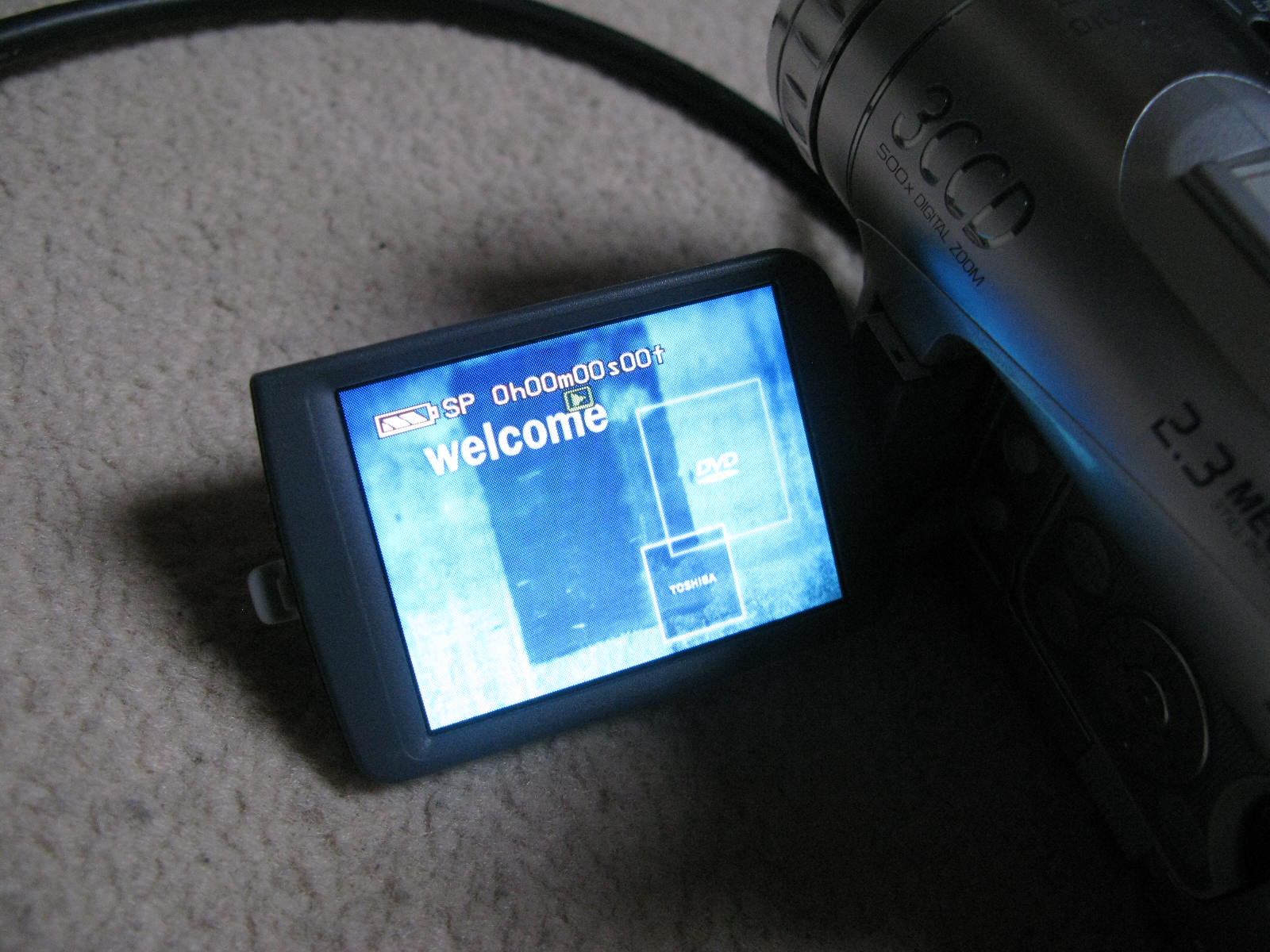

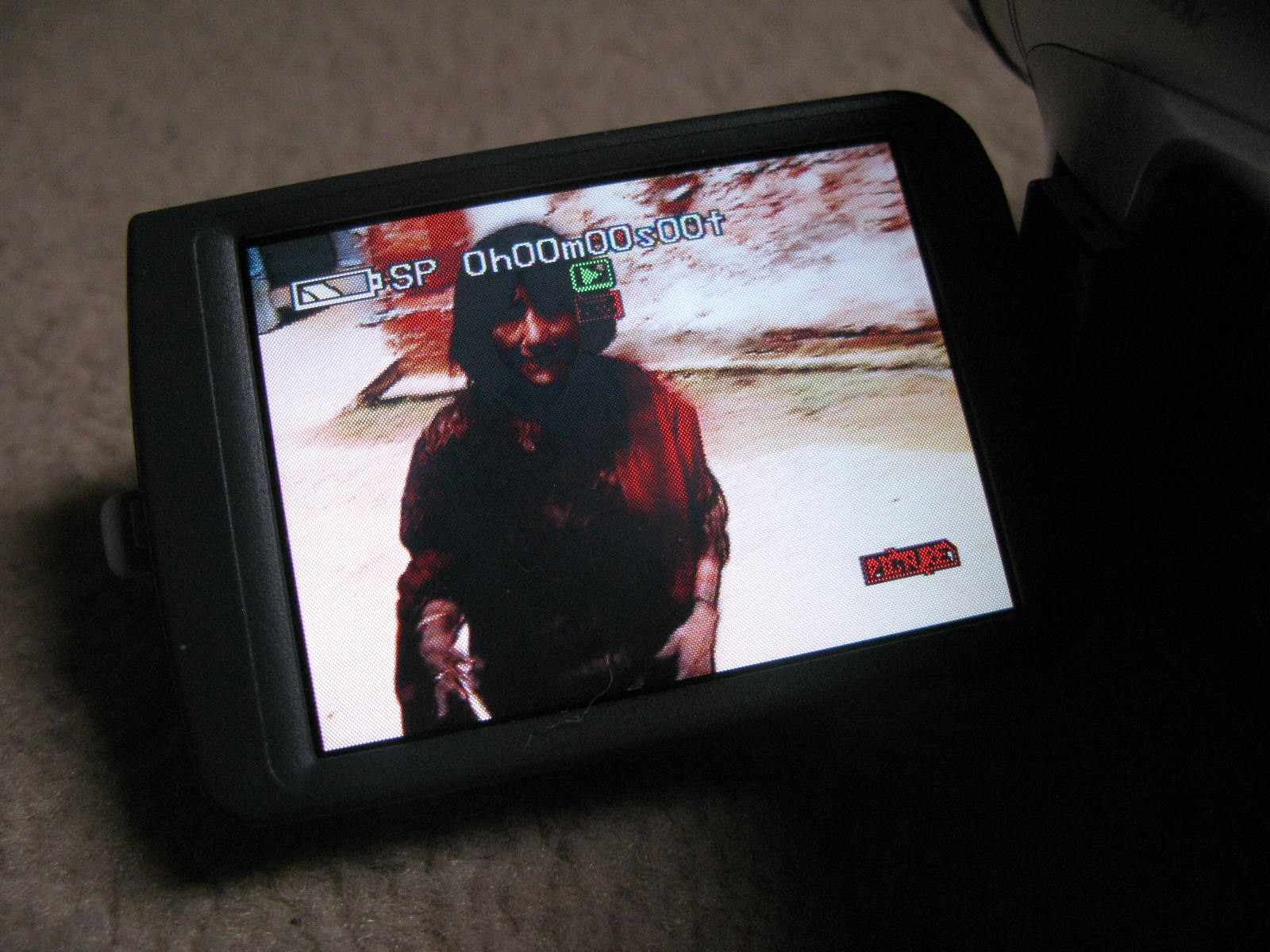

    Only Menu screen visable (yet can hear tape sound playing through DC speaker)
    DC option screen

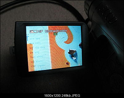

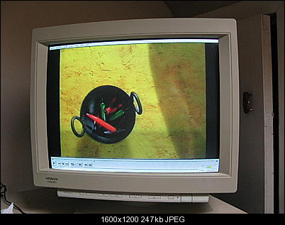

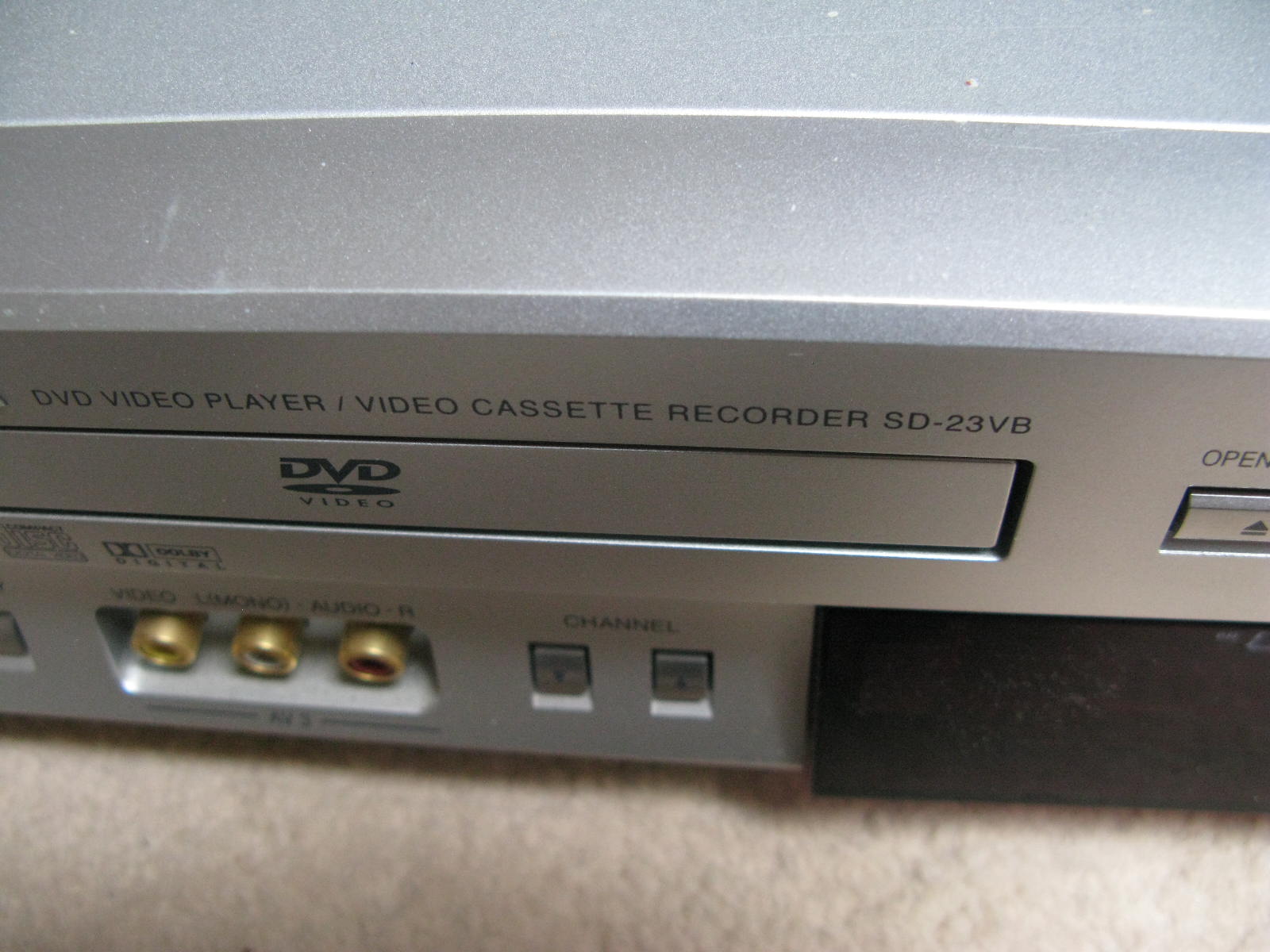

    If I switch to DVD mode and insert DVD
    DVD Plays through this connection
    In RGB Svideo connection
    VCR Tape Plays in this mode, (which i would use)but theres a faint pattern running through picture

  6. Member 2Bdecided's Avatar
    Nov 2007
    True. Stop using the S-video cable. It is no use to you. Your VCR does not have an S-video output. That's just for the DVD player part.
