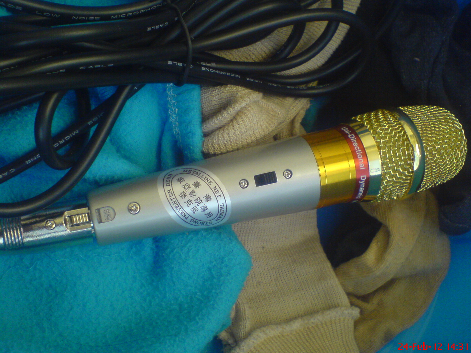

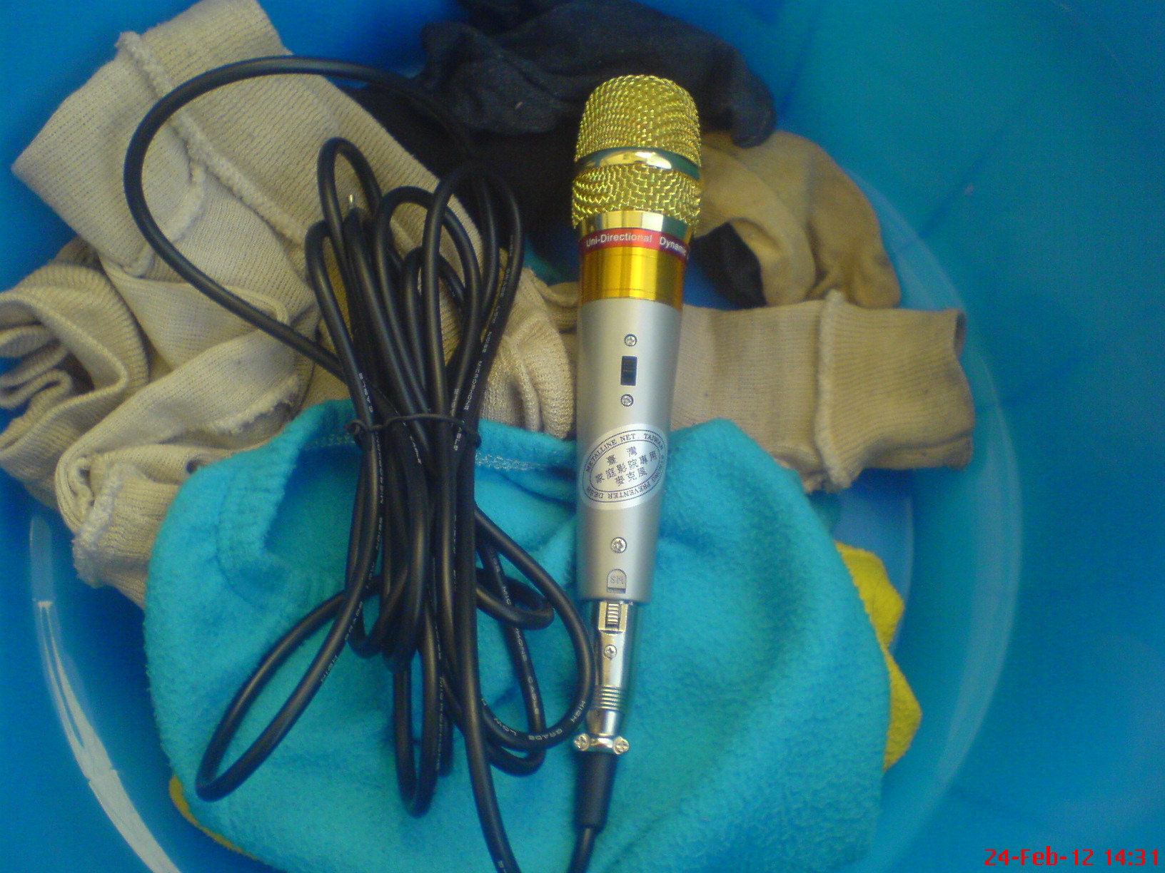

    I've bought this mic from market yesterday :
    https://forum.videohelp.com/images/imgfiles/dXrvu.jpg
    https://forum.videohelp.com/images/imgfiles/lVjHH.jpg
    plugged it into my builtin Realtek soundcard but it doesn't playback , I can only record via sound recorder and playback the audio which has very low volume,

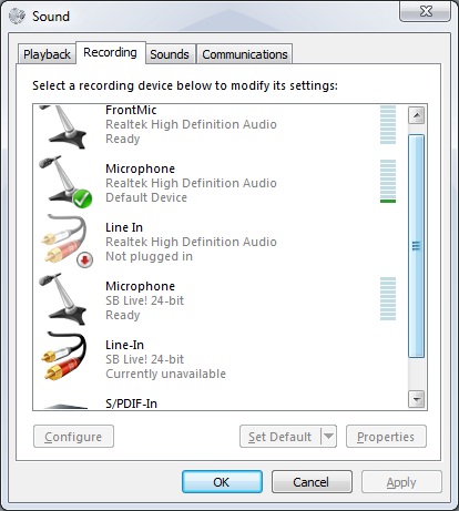

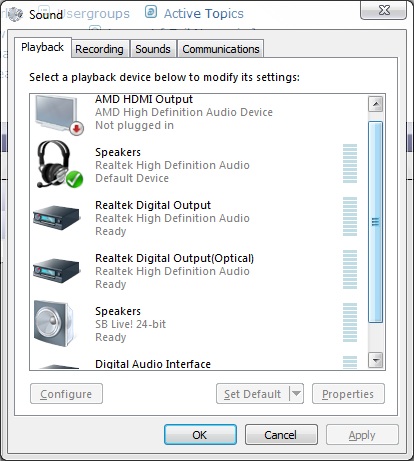

    here's another pic of my system sound properties :
    now my question is why isn't it playing back when I talk directly into the mic ?

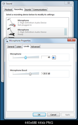

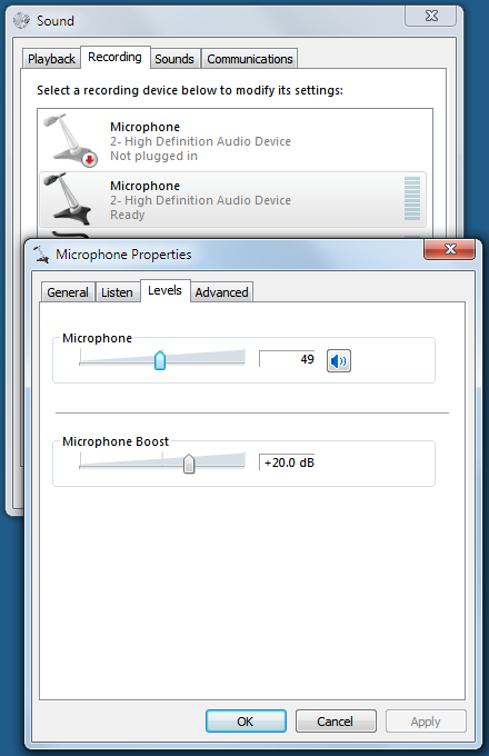

  8. Originally Posted by evil nemesis View Post
    the Mic works well as I've tested it with realtek rear, but it has much low sound and I have to talk very loudly near the microphone.
    Go to the properties of that input and look for levels or boost settings. For example, with Win7:

  10. The microphone boost happens in an analog op amp before the A/D conversion and recording. The original poster can decide for himself if the sound is acceptable.

    thanks jagabo, your settings did the trick for me, Thanks alot, well to tell the truth i'm no a hifi recorder, neither I know nothing about special equipments and hardware, im' almost 0 in this field, so I just wanted to record for video trainings of flash and photoshop etc. and I think this setup will do that good for me only if I have a silent place, as well if you need to edit it later you have audtion and soundbooth etc. right, i'm more of a software guy ,
    cheers to all.
