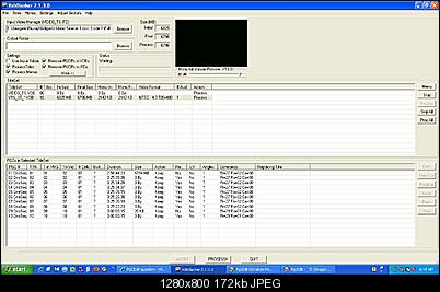

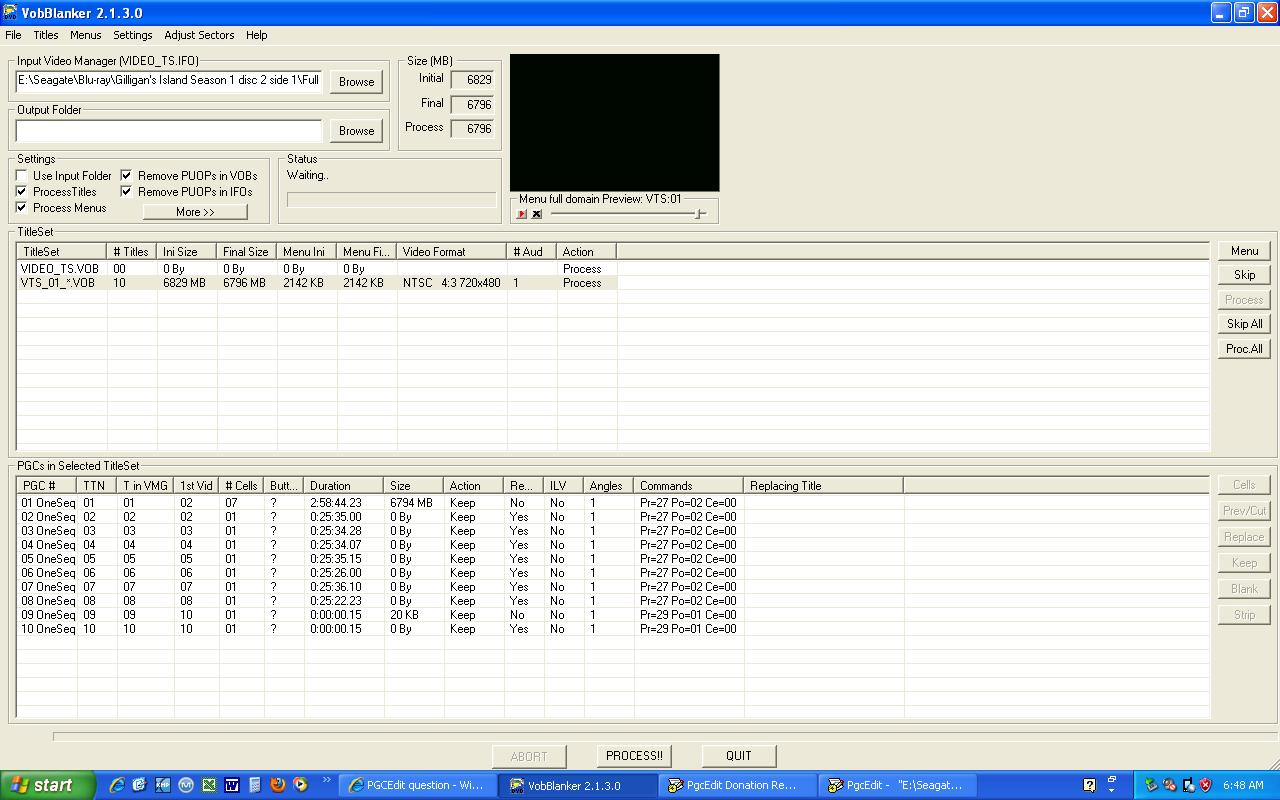

    To prove what you have, open the DVD in VobBlanker. Highlight (click on) the VTS with the episodes so that they appear in the lower pane. Post a picture here.
  9. You might be better off using a program like DvdRemake
  10. Here is the image from VOBblanker. It shows the full length video and the seperate videos. I do see it shows 0 for file sizes. My question now is, if I can delete these titles and it still works, what are they, how does this work, and how do I change the process to point to the cells in TTN 1?

  11. You don't want to change anything, not and still be able to play them all one after another as well as play the individual episodes. It's titles 2-8 that get played when you choose to play a single episode through the menu. Those titles only reference cells within title 1. As Noahtuck, DB83, and I have thought, they're on there only once, and the commands point to the various episodes. If you want to shrink the size, it's that 6794 MB all-the-episodes-together first title you have to compress. Either do it manually if you know how, or do it using DVD-Rebuilder, or, if you don't care for getting the best quality out of it you can even use DVDShrink.
  12. Thank-you. If were to run into an issue where I would need to point to a cell, how would I do that?
  13. From the FP-PGC or the VMGM, you can only jump to a title. However, from any VTS, you can Jump to a chapter (aka PTT: Part of Title) of any Title in the same VTS. And from within a specific domain (title or menu), you can jump to any cell, program or chapter in the same menu or title using the Link commands.
    So, if, say, the chapter menu is authored in the same VTS than the main title, you can jump to the chapters directly by using JumpVTS_PTT commands in the chapter buttons. It's the simplest way to author a chapter menu, and IMO all chapter menus should always be in the VTSM of the main movie. Unfortunately, it's not always the case. When the chapter menu is in another VTS, you have to set a GPRM to the chapter number, then jump to a dummy PGC in the VMGM, and from that PGC, jump to the main movie, and in the pre-commands of the main movie PGC, check the value of the GPRM, and Link to the PTT it points to. That's not easy, but it's life! (Jumping to a cell that is not the beginning of a chapter can be archived the same way, but you must use the LinkCN command instead of LinkPTT.)
    Your current DVD uses another technique: several PGCs point to the same video content. A PGC is a Program Chain (wrongly called "playlist" above, but it's a good comparison). A Program chain is made of one or several programs (usually associated with chapter points), and each program is made of one or several cells. For example, Title 1 contains 7 cells, but Title 2 contains only one cell. The first cell of Title 1 and the cell of title 2 point to the same cell in the VOB file. It's why Title 2 doesn't consume any disc space, as it uses a cell that is already necessary for title 1. Such cells are called "reused cells". Similarly, Title 3 reuses the second cell of title 1, etc...
    Since all episodes are authored in title 1, and each episode is also reused in another title, it is possible to play all episodes at once by calling Title 1, or to play any episode independently by calling another title. You don't need to use JumpPTT or Link commands, since all parts are authored in different Titles. You can simply use JumpTT (Jump to Title, from the VMGM) or JumpVTS_TT (Jump to TTN from the same VTS) to archive what you want.
    And anyway, you don't have to do anything, as your DVD is already perfect.
