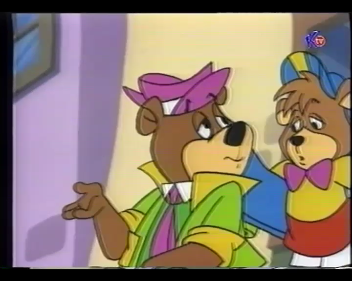

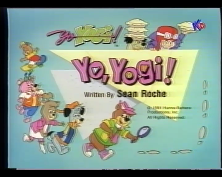

  1. I have some animated material from VHS sources with very bad problems with ghost images, and would really like to get some suggestions on how to deal with it. I have tried everything I've come across and searched both this and other forums, but haven't been able to reduce the ghosting at all.
    I have attached a couple of screenshots from one of the episodes, and the ghosting seems to be consistent across the entire episodes. I'd be happy to upload a sample of the actual video file, if that helps though.
    Any suggestions on how to reduce the ghosting on this video? I realize it's too bad to be able to get rid of it altogether, but hopefully something can be done in AviSynth or VirtualDub to at least limit the damage and make it less annoying.
    Unfortunately the actual VHS tapes have since been damaged, so I can't capture them again. So I can only work with the current files. But as other episodes of the same show recorded with the same VCR looks fine, it appears to have been a problem with the original broadcast somehow.

  2. There is a virtualdub filters called Exorcist to tackle this issue
    ghost shift: -2 / ghost intensity: +27
    If the ghost intensity is below that threshold the ghosting is still very visible

  4. themaster1: Thanks for the suggestion. Although far from perfect, your sample is definitely a big improvement, so I will try that plugin.
    poisondeathray: I can't see any clear frames at a first glance, but they all look similar to this. However, this is an American TV show (NTSC) and was broadcast on a Swedish television network (PAL), so at some point it has definitely gone through some sort of NTSC to PAL conversion. And as we all know, such transfers can mess things up quite a bit.
    Anyway, I have attached a 45 second sample of this video, so you can take a closer look and see if you can make any sense out of all this or can suggest anything to improve the video.
