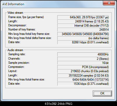

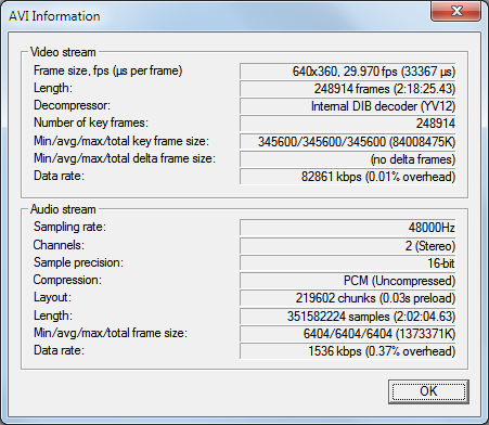

  21. Going back to DirectShowSource("video.flv", fps=29.97, convertfps=true), what did VirtualDub say about the audio and video? File -> File Information.
    You could also use DirectShowSource(..., audio=false) just for the video. Demux the audio to a separate file and convert it (if necessary) with another program like Audacity.
  22. Member
    Mar 2008
    I have downloaded the file, I'll let you know what I find.
  23. Thank you again and again. Couple things more to report:
    aud = FFAudioSource("c:\edit\saturday.mkv")
    vid = FFVideoSource("c:\edit\saturday.mkv", fpsnum=29970, fpsden=1000)
    audiodub(aud, vid)
    WILL allow the video and audio to both play within VirtualDub -- notice that this is for the MKV file that was outputted. The audio is still out of sync of course or this would be a giant win.
    Is it possible there is an FLV component that I need to have that I dont. I have ffdshow, and THIS flv splitter (1.0.0.5 which supports H264 and AAC).
    In answer to your question:

  26. I tried ffmpeg command line just as another option and the outputted file plays just like the original flv when played in FLV -- delays itself so the audio and video stay in sync (still skips).
    ffmpeg.exe -i c:\edit\saturday.flv -vcodec copy -acodec copy -timecode c:\path\to\extracted\timecode.txt output.mkv
