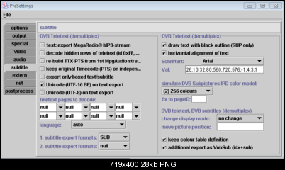

    This is part of ProjectX Presettings subtitles does this help?

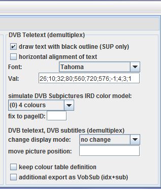

    Mar 2009
    Denmark

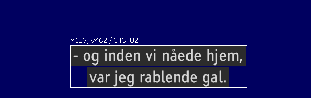

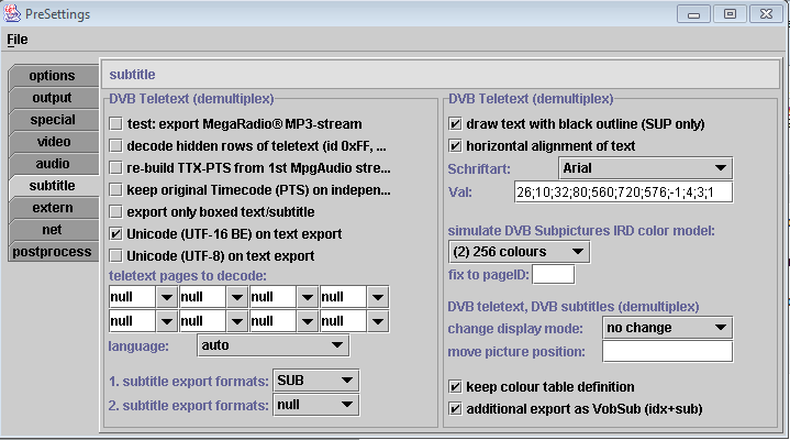

    In ProjectX i used 256 colours, and the sub's look nice:
    Preview of subtitle (Danish!)
    Maybe i am getting somewhere..
