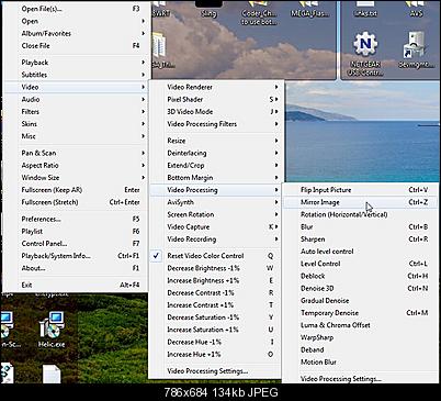

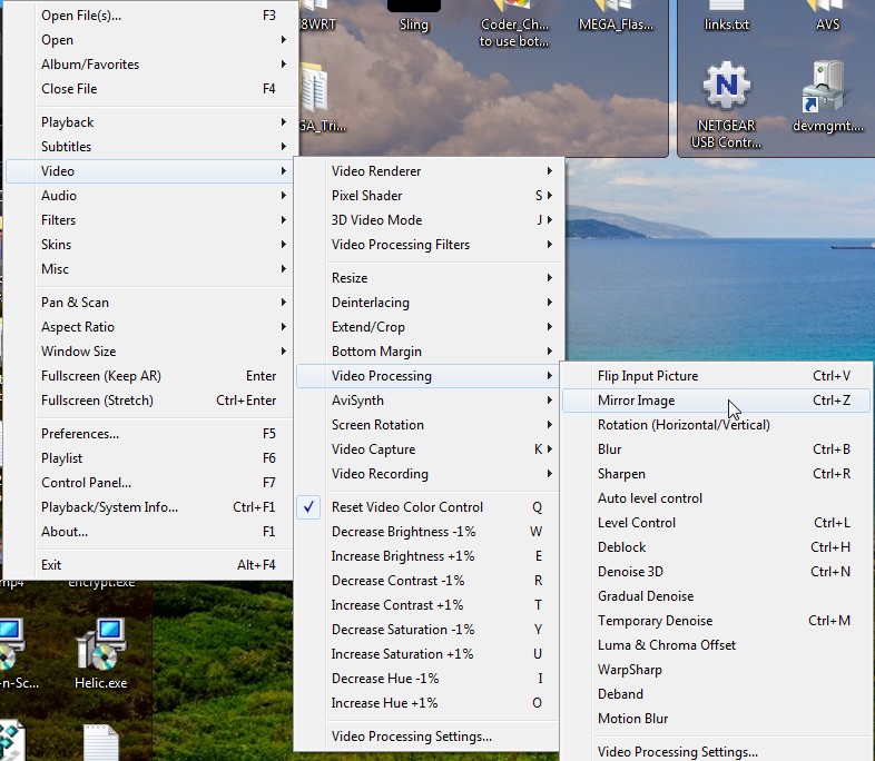

  8. My video is reversed in pot player, how do I reverse it back ?
  9. Member Budman1's Avatar
    Jul 2012
    NORTHWEST ILLINOIS, USA
    There is a setting for that. Right click and make sure it isn't selected. Many settings havbe shortcuts and can get set easily by mistake
