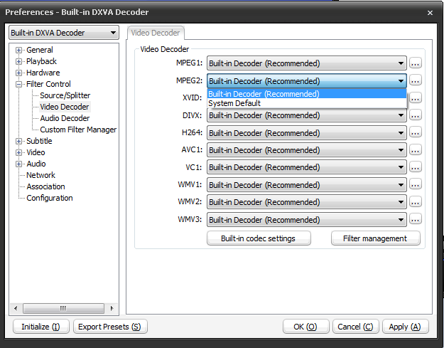

    Under Filter Control/Video Decoder I've tried "Built-in and System Default"...when I switch to System Default the subs disappear altogether and they're no where to be found...can't bring them up with any hotkey or right click menu option...they're gone. If I switch back to built-in, the work but won't leave when you turn them off. I can use the "closed caption" ones, but if I do, I get 2 different sets of subs on the screen. Regular subs and the CC ones. I can turn off the CC ones though.

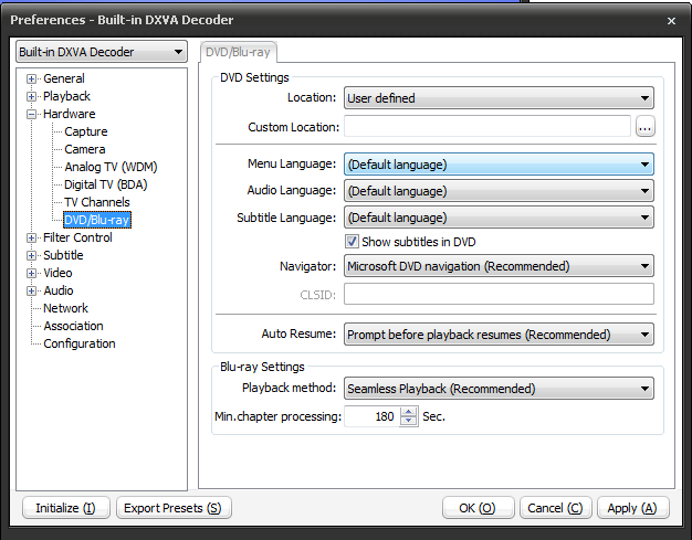

    Under Hardware/Dvd-Blue Ray settings I can check or uncheck "show subtitles" and it doesn't do a thing...no difference

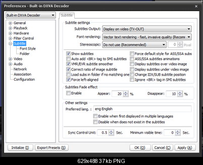

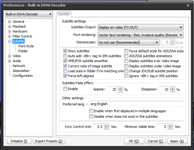

    Under Subtitle settings, any of these options that seem relevant I've checked or unchecked and no difference.

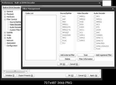

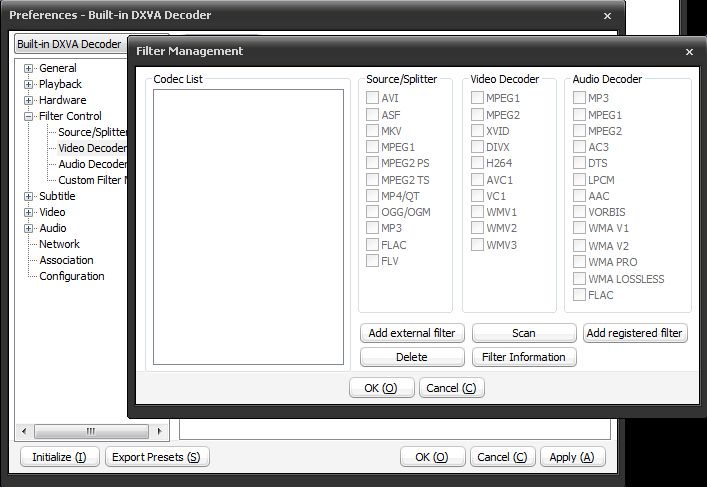

    Under Filter Control/Video Decoder/Filter Management a window appears that lets you add or delete filters on your system. I've "scanned' and it shows LAV Filters and Haali etc. I've ticked boxes under Video Decoder/MPEG2 set up with LAV and Haali and zero subs show. Go back to Built-in and subs show...but won't go away.

    What have I gotta do to get subs working correctly with dvd's? A setting is not right or a piece of software/filter needs to be installed/uninstalled? Help an ole Buccaneer out before he loses his mind.

    Humble suggestion: start by dropping the "Built-in MPEG decoders" Even the "CLVSD.ax" from an old version of PowerDVD should be infinitely better than any FOSS Mpeg decoder
    ( EXCEPTION to this rule: DScaler 5 )
    Also, disable the built-in video processing entirely, and choose "Overlay Mixer" for video rendering.

    Okay, I took the time to find out what works over here
    ( since English is not my native language and I prefer to keep subs always turned on )
    Context menu -> DVD Control -> Subtitle Option -> Un-tick "Active"
    Nov 2005
    Thats' it!!!! Wow what a maze of subtitle controls in this player. Dvd Control wasn't there before. Oh well, it works perfect now.
