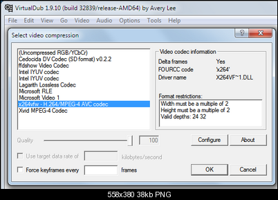

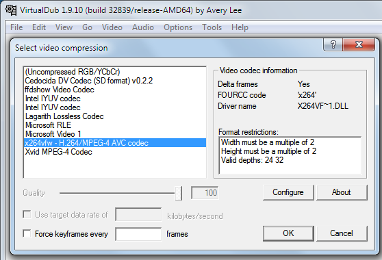

  2. I just downloaded and installed this version on my Win7 64bit machine:
    https://www.videohelp.com/download/x264vfw.2146kMod.x86_64.exe
    It shows up in VirtualDub64.

  4. vfw and directshow are 2 independent systems
    vdub uses vfw, that's why it can access x264vfw (and any other system installed vfw codecs)
    graphedit / graphstudio are for directshow , not vfw.
