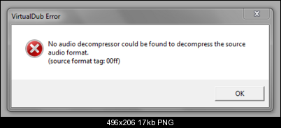

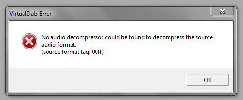

I got an MKV where the audio is out of sync. I'm wondering what's the best way to fix it? I have Virtualdub with the MKV plugin, it lets me load the MKV but i get the following error:

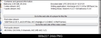

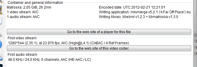

Here is File info:
Obviously I have a "decompressor" present on my computer because WMP12 plays the MKV (sound included) just fine. So for some reason, virtual dub just can't access it? I have used virtual dub before to fix a sync problem with an .avi (xvid) and it worked just fine. I Have MKVToolNix and I know I could manually put a delay value in there and remux it, but I don't know how to figure out what the correct value is. I need to figure out how to get Virtualdub to work or find another similar program that will let me view/fix the sync in real time.

do you have aac acm for vdub?
https://www.videohelp.com/tools/AAC-ACM-Codec

Also I downlaoded that AAC ACM but didnt' install it cuz its a .bat file. Not sure how to tell exactly what/where it will install. That is a codec correct? will it interfere with the other codecs i already have working? Would like to know more before I install that.
