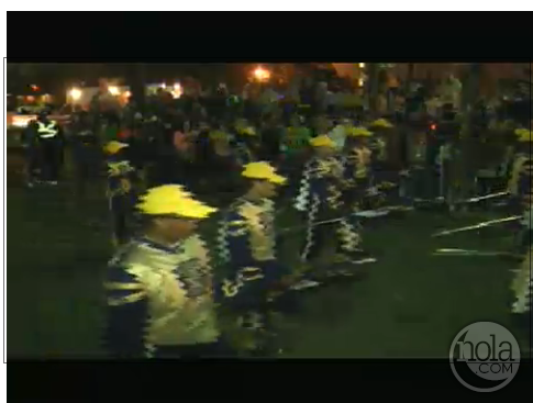

    The nola.com paradecam (http://www.nola.com/paradecam/) has been webcasting Mardi Gras parades. I have noticed that there are horizontal lines often, when panning or there is horizontal movement, which is often. I have tried to get the cam operators to fix it but they say others aren't seeing it. Others are. I think it is a matter of having the cam set to progressive scan but I am not enough of an expert to be sure. I think it is set to interlaced now, at least that is what my research on the net makes me think.
    Can someone diagnose what is going on? They are only webcasting for one more day, tomorrow, 2/21. You can tweet your suggestion to fix this problem to #paradecam and I also recommend @jamesobyrne I think he is one of the guys who deals with the camera. Tweet only when the cam is live.
    I have attached a pic of a screen grab I took yesterday. You can see the horizontal lines quite clearly.
    I would appreciate any help on this.
    Thanks.
    John L
  2. That is incorrectly resized interlaced video. If you are going to resize an interlaced frame you need to use an interlace aware resizing algorithm or deinterlace before resizing. And to display it properly on a computer it needs to be deinterlaced. Better yet, use a progressive camera as your source and you won't have to worry about interlacing.

    Are they resizing it or was I? I did this screen cap at the resolution they offered it at. And will switching to progessive fix it?
    Many thanks.
  4. You're looking at the web streams? If so, they are the ones resizing interlaced video and streaming it as progressive without properly deinterlacing.

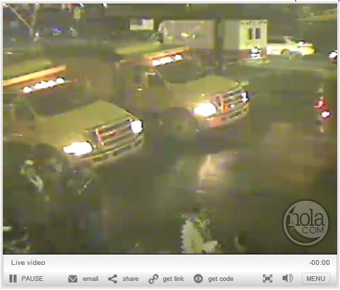

  6. No twitter account here. The video at the site now has the problem:
    The trucks weren't moving but the guy in white at the bottom was.
