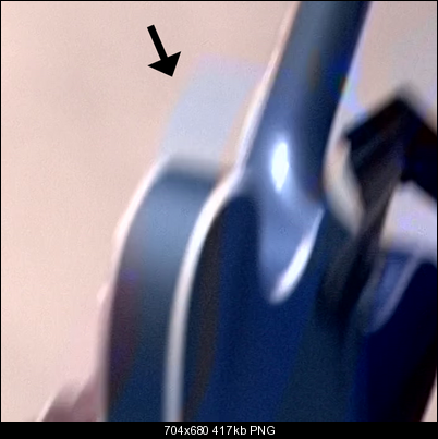

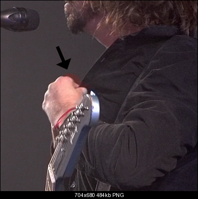

    Ok new problem, this is my new input:
    x264 --bitrate 23500 --preset veryslow --tune film --bluray-compat --vbv-maxrate 40000 --vbv-bufsize 30000 --force-cfr --fps 25 --level 4.1 --keyint 25 --slices 4 --tff --colorprim "bt709" --transfer "bt709" --colormatrix "bt709" --sar 1:1 --pass 2 -o constantframe.264 sam.mpv
    It plays fine and looks pretty nice but I'm seeing some strange colour issues. Yellow patches and smears. Is it something to do with the color settings and the 4:2:2 > 4:2:0 downscale? It converted to 4:2:0 automatically but is there anything specific I need to include in the input?
    This is what I mean:
ID:	11382Click image for larger version
    It happens with all RYB colours, so there are some similar yellow flashes as well. It's more noticable on playback with PowerDVD but when I was making those screenshots with VirtualDub the yellows weren't there. I don't know what's going on.
  12. One more question, is using the 'tune - grain' option a good idea, considering the source? It's obviously very high quality as it comes from a Sony XDCAM 422 @ 50Mbps but i am seeing a fair bit of grain/noise in some scenes so thought that tune was the best option?
    If you want to keep the noise/grain in there then it's a good idea . Very costly to encode, you need high bitrates otherwise it starts looking patchy and splotchy
    The other alternative is to reduce the grain or denoise / prefilter before encoding
    The chroma issue might be a swscale issue , a decoding issue, or it might be a interlaced chroma upscale issue (playback issue)
    What does the log file say about converting 4:2:2 => 4:2:0 ?
    Another reason I would do it in avisynth with ConvertToYV12(interlaced=true) to rule out swscale issues
    If its not autodetcting the source correctly or you can try --demuxer lavf --input-csp yuv422p --output-csp i420 , (or just get it right the first time with avisynth)

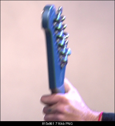

    Sigh, really not having a good day. Those chroma issues are still there:
    The original 4:2:2 file for reference:
    x264 input was the same as before, just via the avisynth script as you posted.

  24. Those screens are directly from Virtualdub with just a deinterlace filter applied on both.
    I'll have a look in a sec, but vdub upsamples interlaced YV12 incorrectly (converts to RGB incorrectly, because it treats interlaced YV12 as progressive), so you have to force YUY2 in the color depth options in vdub.
  25. Yep, looks fine here; it's a playback issue, and the method in which you took screenshots in vdub

  27. Originally Posted by Killer3737 View Post
    Hmm, so the problem is on my system somewhere.
    The chroma issue is not a system problem. It' s just the way vdub handles chroma it upsamples interlaced YV12 as if it were progressive
    You mentioned something else about "yellow patches?" not sure what that is, but I don't use Power DVD any more for a few years so I cannot check
