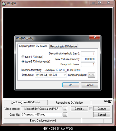

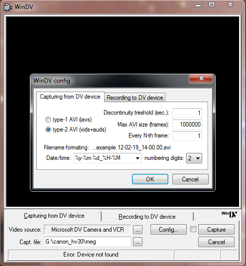

    you might try capturing the tape again using winDV. the time/dates will be in the file names and you can set it to create a separate file for everytime the camera was paused/stopped.
