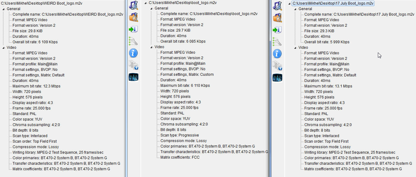

    Any idea on what else is different besides one being progresive and the other being interlaced? When i used the progressive in the July 17th firmware it was updated fine and it works, when i used it on the newest firmware it became distorted, I thought they had coded the size of the boot_logo.m2v so it could only be replaced by one of the same size, but since they publish the same firmware with two different boot_logos of different size (same specs), when i interchanged them, they worked, so, it was not the size and i don't know how to get this part when encoding an image to a m2v file (TMPGEnc misses one line):
    Original:
    Scan type : Interlaced
    Scan order : Top Field First
    Compression mode : Lossy
    Writing library : MPEG-2 Test Sequence, 25 frames/sec
    Color primaries : BT.470-2 System B, BT.470-2 System G
    Transfer characteristics : BT.470-2 System B, BT.470-2 System G
    Matrix coefficients : BT.470-2 System B, BT.470-2 System G
    TMPEGEnc gives me just:
    This being the interlaced m2v file that the receiver rejects.
    Same info but side by side:
    https://forum.videohelp.com/images/imgfiles/4YciB.jpg
