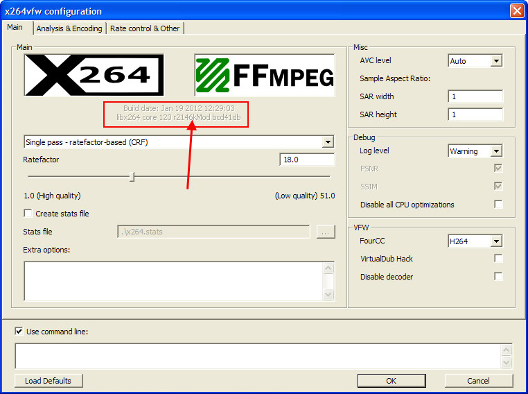

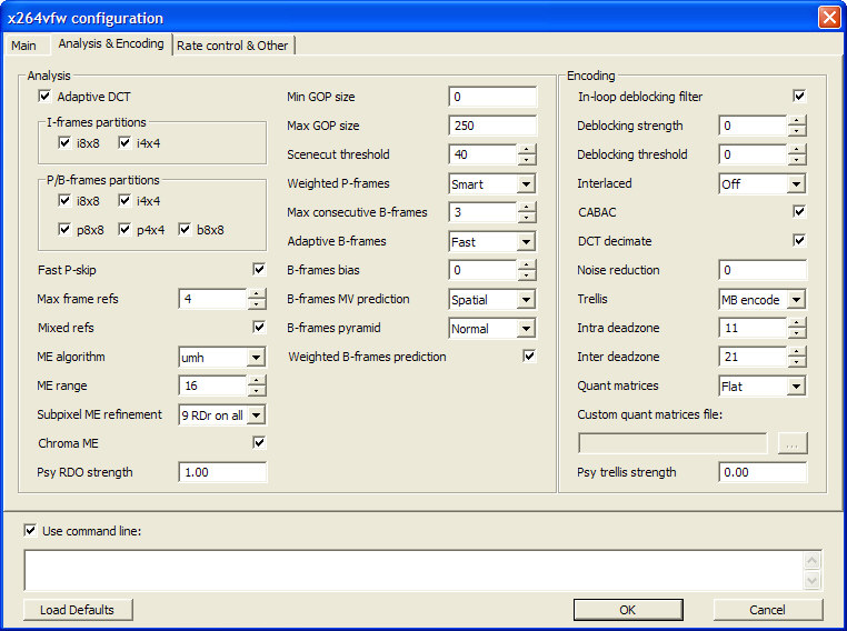

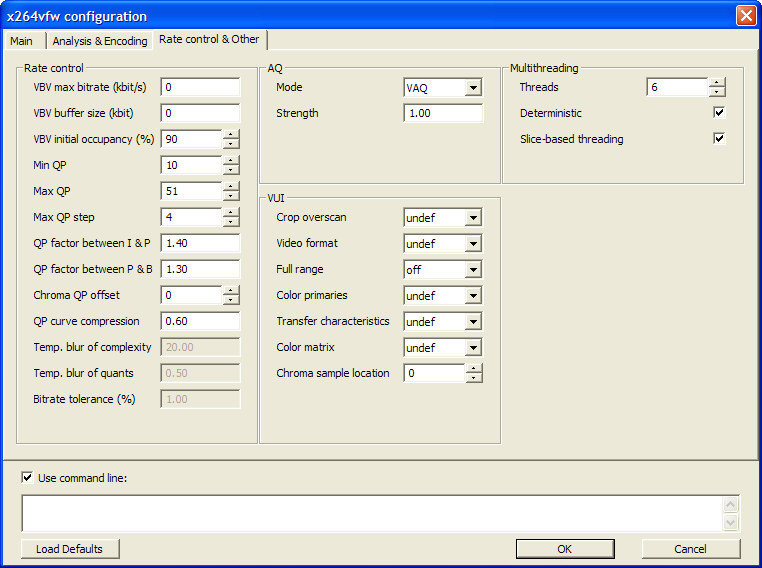

    There are 2 different VFW GUI's. Both allow custom encoding settings in the command line box.
    You mean two UI's? I don't even know how to do lossless mode in command-line, how would I transfer my current settings to CL? Would that custom command-line be saved for future use?
    The one I linked to has many options broken/laid out with several tabs.
    Bullshit, I'll have to see this to believe it. Screenshot?
    CLI won't save anything, but you can copy & paste a text line for example
    VFW GUI will save settings
    How about a little trust here?
