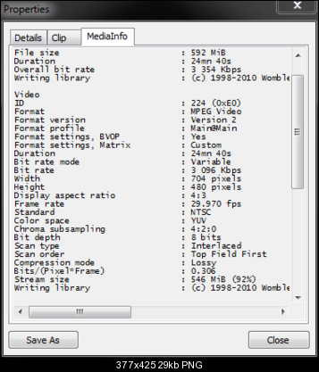

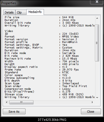

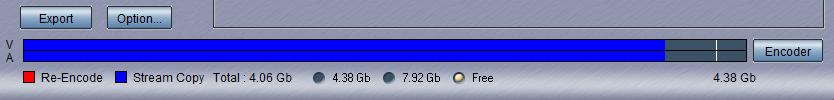

    Using Womble's DVD Editor tool in this MPEG Video Wizard DVD software to author some digital TV recordings. As you can see in the screenshot, the bar is all blue meaning it should just be doing a stream copy. But it is re-encoding parts of them, to the point that the resulting folder won't fit on a DVD5.
    The original video bitrate for the first file is 2829 kbps and it ends up as 3096.

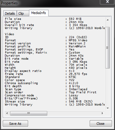

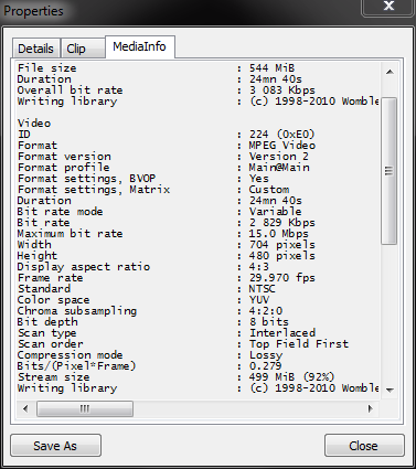

ID:	10959Click image for larger version

  8. It's true, Mediainfo doesn't scan the file and the bitrate reading may not be accurate, but the filesize is significantly larger: 592MiB vs. 544MiB which suggests higher bitrate
