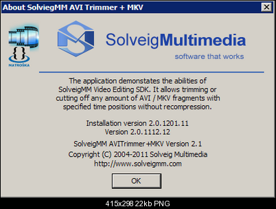

    It looks like the program I am used to using for trimming AVIs, (SolveigMM AVI Trimmer) has a new version that supports MKV. But it's giving me issues. I contacted their tech support for assistance on this. In case anyone is familiar with this program... Here's the problem:
    1. I open the program, select the MKV file I want to edit, then...
    Name:  Trimmer Error-1.PNG
    pops up. I click ok on the error and then the MKV file plays fine and I am able to define the clip parameters.
    2. When I have defined the clip I want to save and click "save" ...
    Name:  Trimmer Error-2.PNG
    pops up. Clicking ok on the error does not help.
    This is my version info:
Name:	Trimmer Version.PNG
